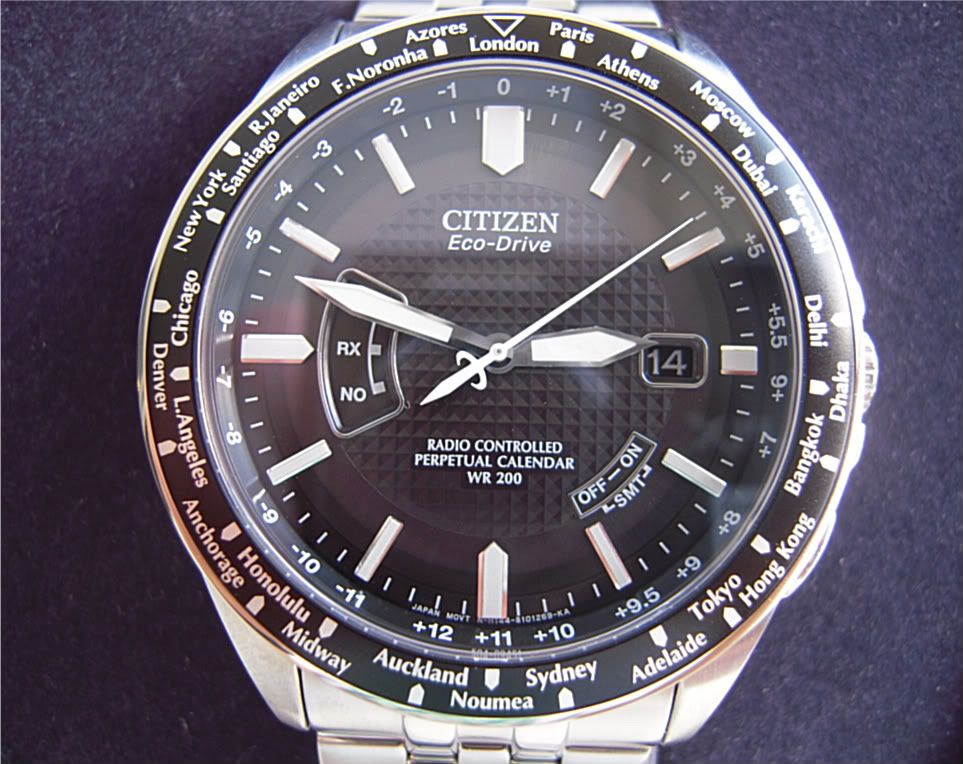

well, another one bites the dust...
I've had it for 4 days in the sunlight and near a lamp at night. When there is no direct strong light source, it stops after 5-10 minutes...
it's only 2 years old!

more than 4 days in direct sun light and 4 night under a lamp?
I don't think so :'(
I have it under the lamp now and its working, but If I close the lamp, in 10 minutes its bye bye...

yes, it definitely looks like its not storing power.
Do you know what the power cell is called?

''Next time when you are able to get the watch to work. Notice the second hand, does it sweep every second or every two seconds? If it sweeps every two seconds, it indicates the timing chip is working. If it sweeps every second it indicates the battery is so low of useful current that the chip cannot count properly. Let us know what you see.''
copied from another forum

it's ticking every second.
However, when I click on the lower right button, the second hand go right away to "NO" (sync), so it seems that as long as there is a light source, it works.
