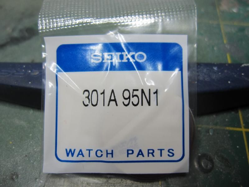

Ask some of the members here from the UK if Cousins carries the Seiko part number 301A 95N1. I am willing to bet they do. If they do I would order it. Many people may try and tell you the other battery is the same but if a generic battery would work just find them why does Seiko have a special part number for a battery kit for the Perpetual calendar watches? The Seiko battery kit is not expensive so to me it makes no sense to use a generic battery especially because when the battery goes 100% dead it takes more than just unscrewing a case and popping a new battery in to get it working again.

I have changed dozens of these and never once used the Seiko item. I just use a Panasonic. Used to get them from Cousins but now these batteries aren't shipped by the Royal Mail, they have to pay expensive couriers to ship them. I just bought some Panasonic ones from elsewhere for ÂŁ3.50 each shipped. Never ever had a problem with them.
