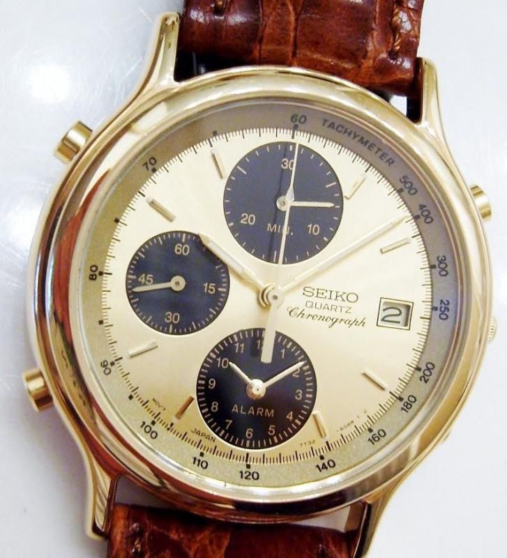

I have bought a couple of them. One was a very attractive 7T32. I had an older small cased 7T32 with a green face that the gold tone on the case and bracelet was about 80% wiped out and the crystal had some scratches but mechanically it still worked perfect. So I picked up a nice 42mm case 7T32 salesman sample. Brushed stainless finish with a nice blue dial and a a rotating ring with sunken marking filled in with a matching blue. This was my first attempt and the fact that the case was a completely different size added some difficulty as the stems do not come with salesmen samples and the doner watch stems were to short. The only real goof I had was removing the crowns from the case. They glue them in with what appears to be that "hotgun" plastic type glue. I tried to force the crowns out which I did bit the threaded part of the stem is to delicate to be pushed out. So on my second attempt I broke the whole watch down to the case with just the crowns glued into it. I used a clamp and slide the crowns and case into a small bottle of acetone a let it sit overnight. The next morning I was able to pull the crowns right out of the case with my thumb nail and the acetone did not mark up the case at all. Then I just used some reamers to clean what was left of the glue in the tubes out a toothpick to clean up the crowns. Now it is all waiting on the bench for later tonight to go back together. it remains to be seen if the stems will need replacing on this second attempt. The replacement 7T32 Seiko stems are all only offer in one length. It is up to the installer to cut the threaded end down to the correct length. I'll post some pictures up later of the one I'm working on now. I did not take pictures if the first one I buggered up a bit.

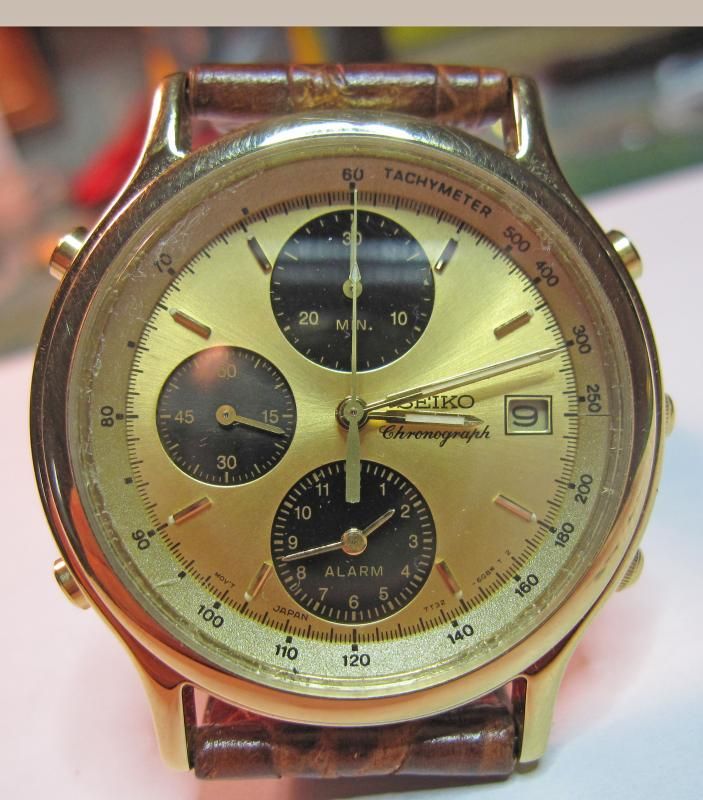

#10 ·

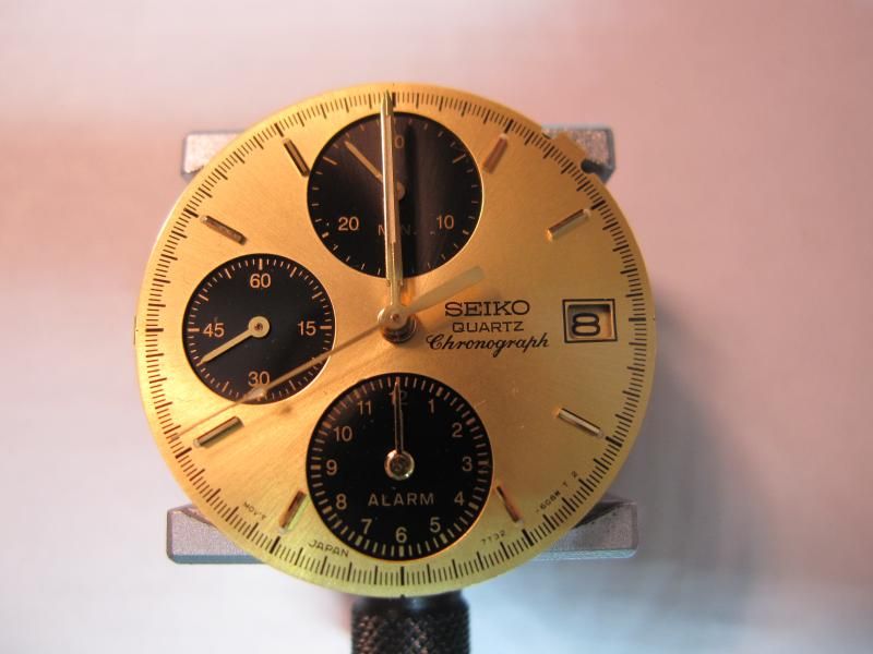

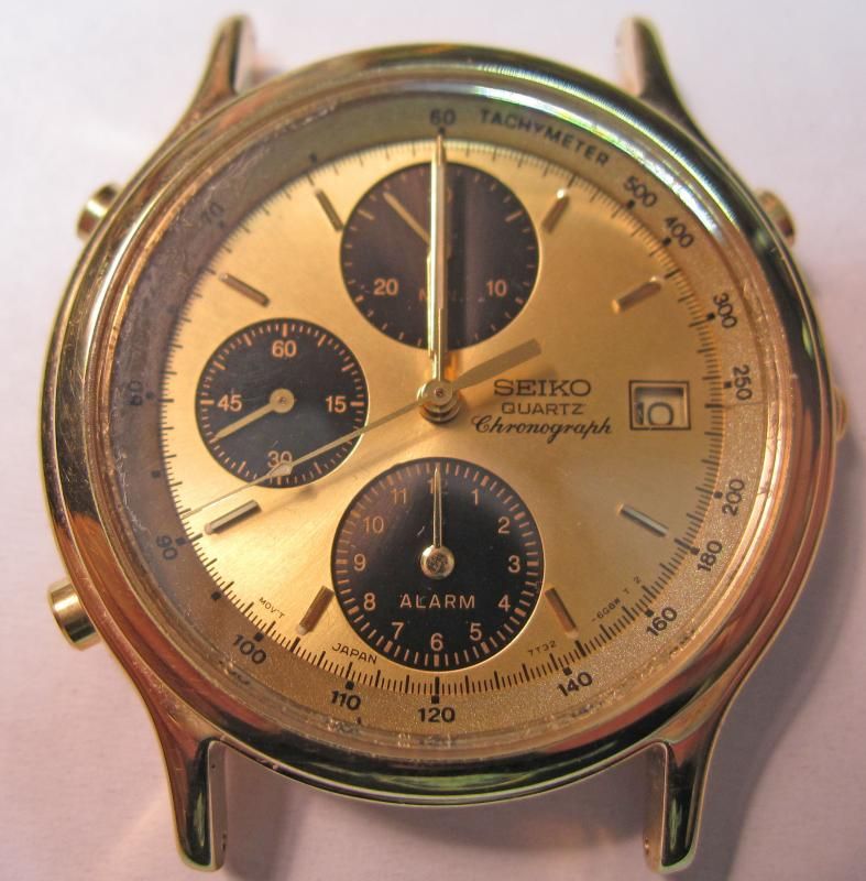

OK here we go from salesmen sample to a functional watch first picture the salesmen sample.

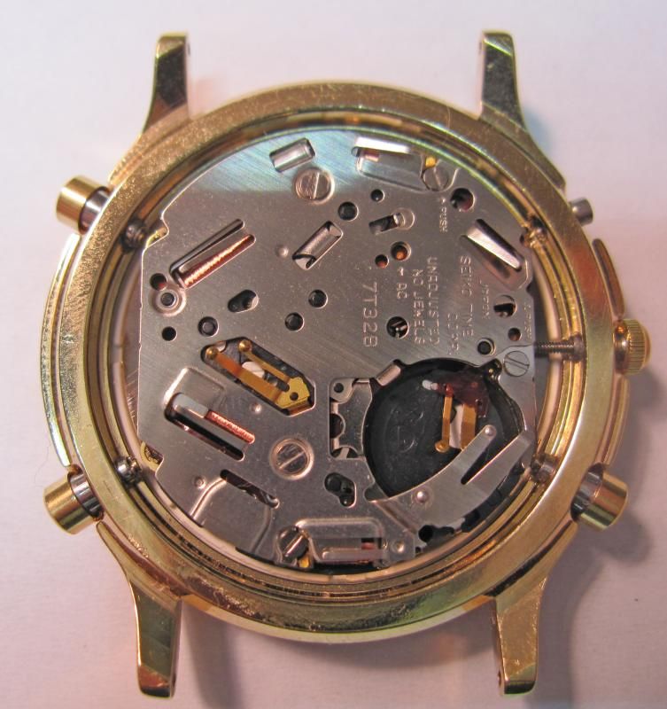

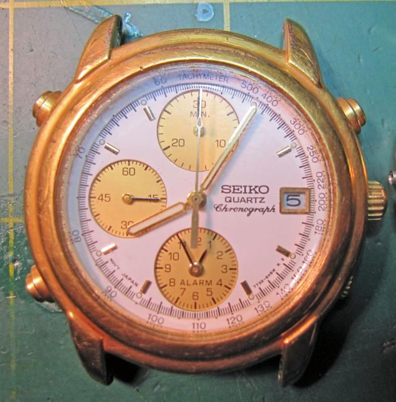

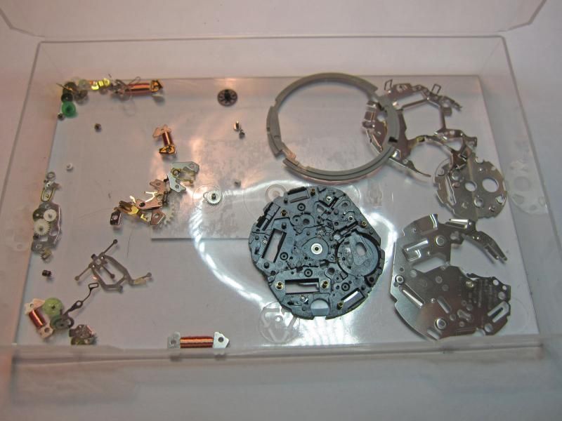

and the transplant supplier watch.
I have broken down both cases and sorted the parts into build parts and spares. Here is an idea of just how many good spare parts you also can make use of when doing this type of swap!
More pictures to come later

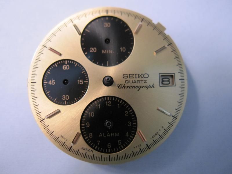

#14 ·
Ok silver date wheel changed out for the gold one that came with the Salesmen sample on the movement and the face from the salesman's sample also installed. Then the fun part installed all the tiny sub dial hands and main hands and top it of with the chronograph hand. I got further but I have not uploaded those pictures yet.

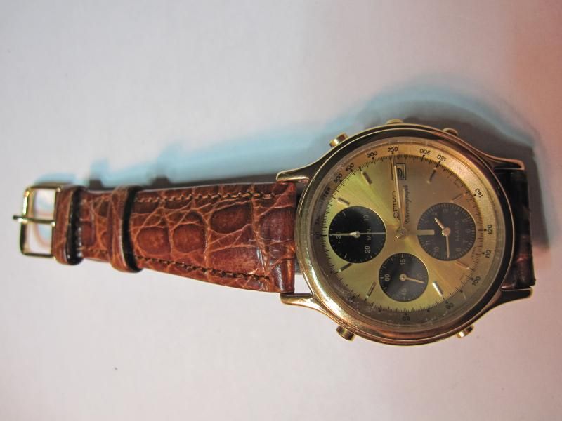

#15 ·

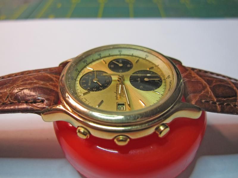

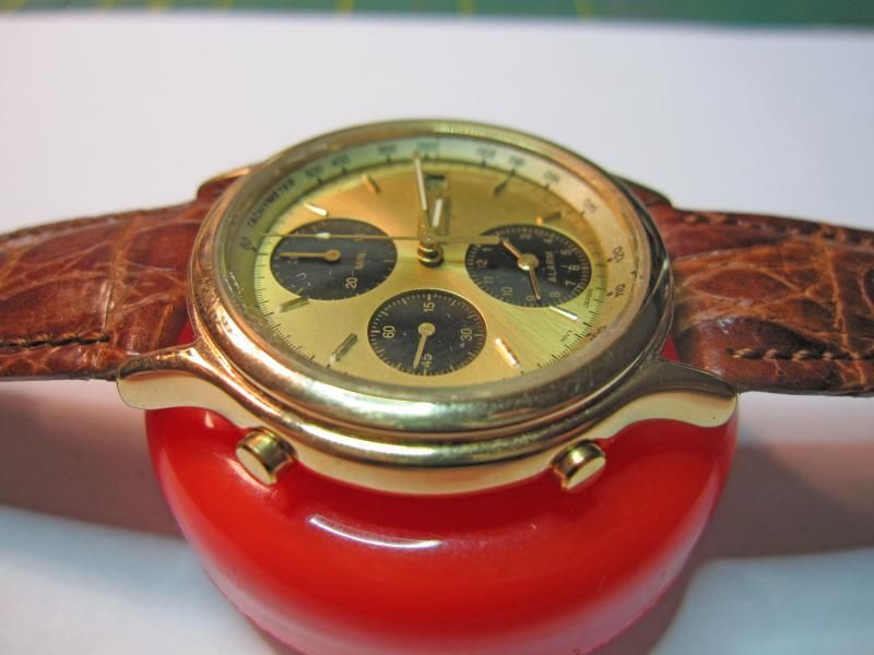

More progress. The chapter ring has been reinstalled in the case and the movement/dial assemble has been fitted into the case being sure to fit the small tab on the dial into the corresponding notch in the chapter ring so it sits nice and flush. I managed to remove the main crown from its stem and install the new one that came with the salesmen's case and she threaded right on and the new set up slid right into place and locked right into the movement with the crown sitting perfectly against the case. Unfortunately the old crown from the old case refused to part from the stem so it is soaking in acetone. It's coming down to the finish line!
