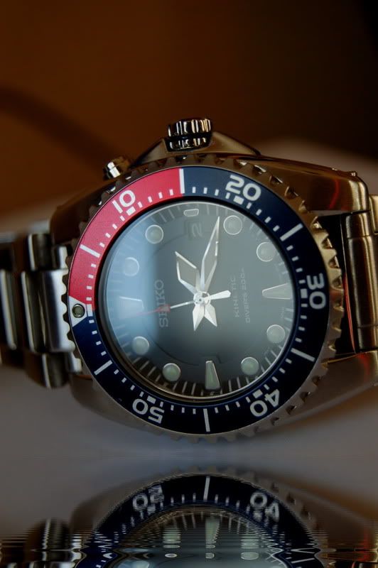

"[quote name="bubblehead" post=879706]Pretty much my daily wearer since 2010. Great watches<br />
<br />
[/URL][/QUOT<br />
<br />
That's the secret With Kinetics keep them charged, on the wrist or see below....Bob.<br />
