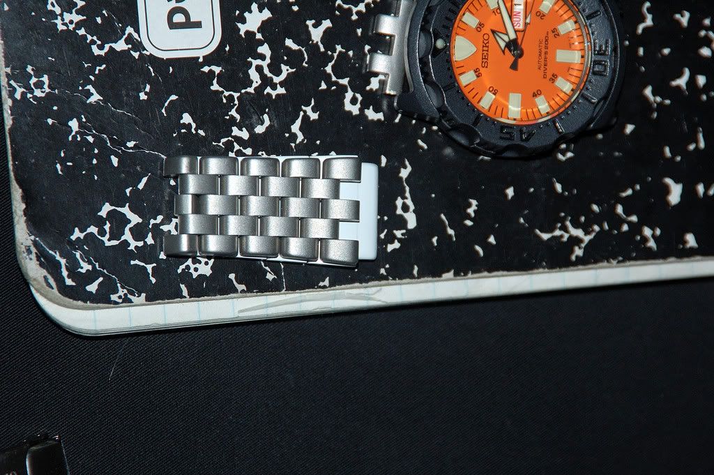

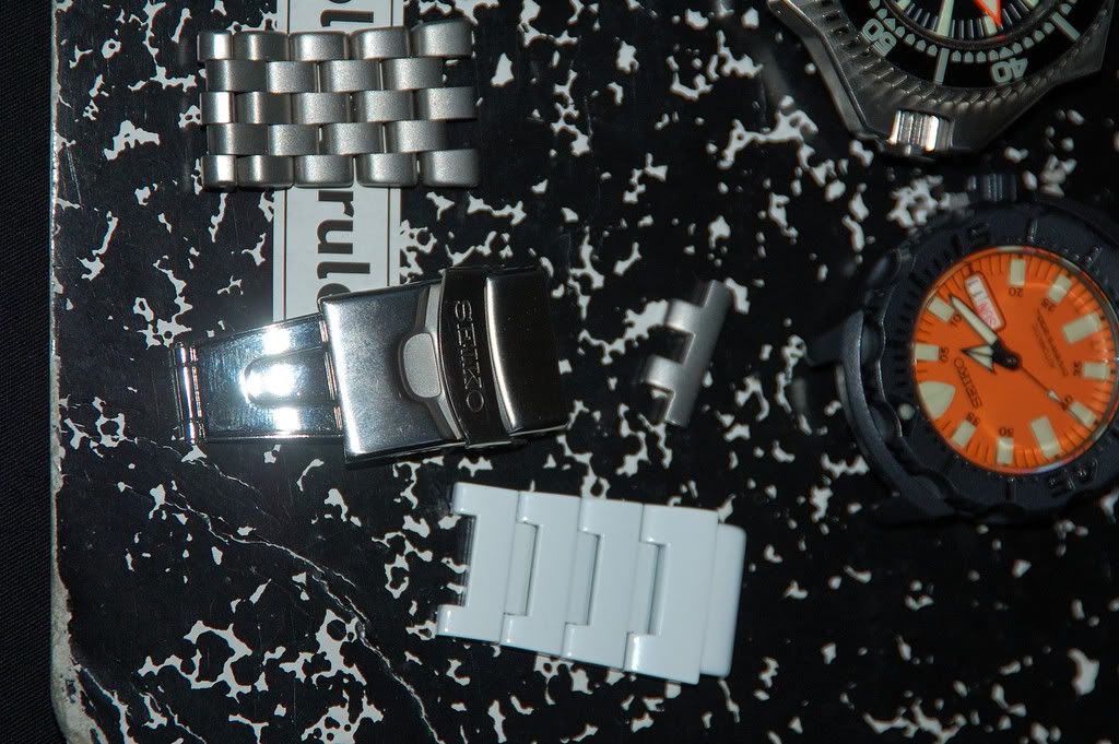

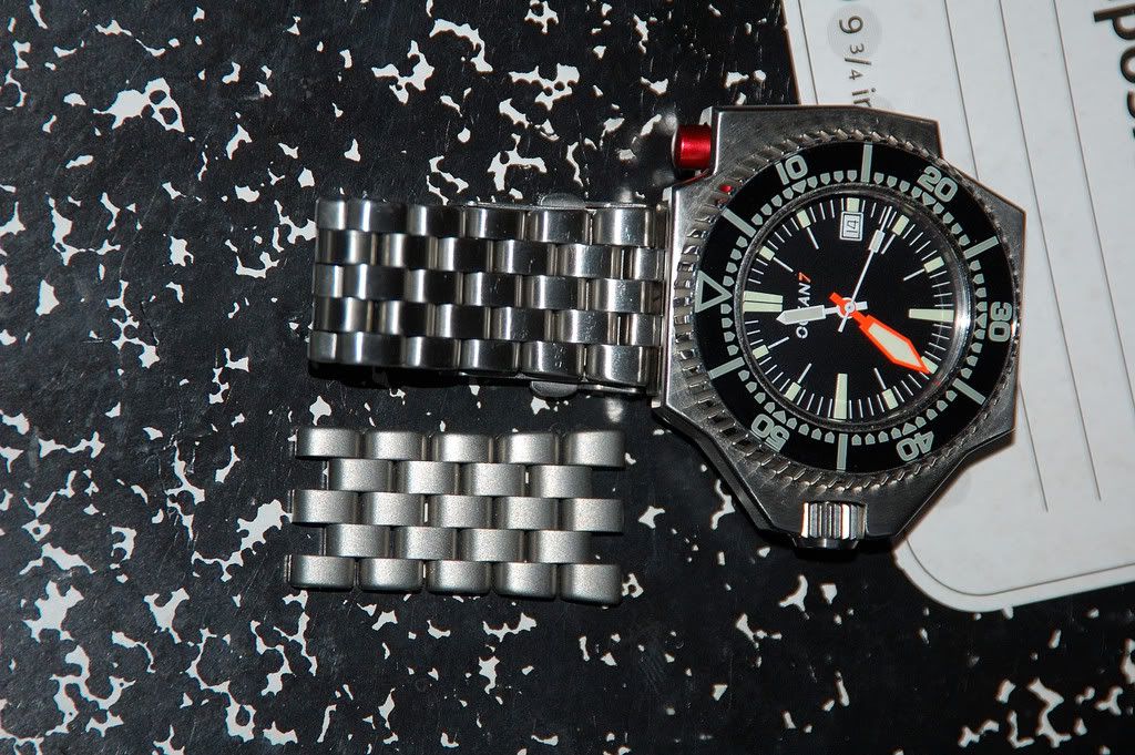

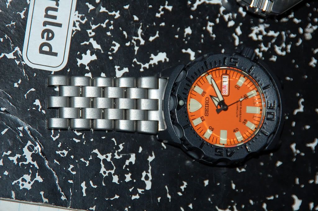

As we know the monster uses a 20mm bracelet. The actual bracelet end is 20 mm while the first link is 22.5mm in width. So if a 20mm Watchadoo is fitted to a monster it will actually be skinnier then the standard monster bracelet. From claims on this forum this seems to be a more comfortable set up for wrist sizes smaller than 7" (Not my claim but others). To get a watchadoo that is closer to the standard monster bracelet the 22mm needs to be used. This requires that approximately 1mm must be removed from the end link on each side (see photos) to fit in the watch (may actually be a little more to allow it to slip in). I have a photo of the 22mm watchadoo sitting on top of the standard monster bracelet (White). It measures exactly 22mm so the standard monster bracelet is a little wider (.5mm). One other thing I discover is moving to the 24mm buys you nothing. In the picture my Ocean 7 LM-7 has a 24mm watchadoo. When the 22mm bracelet is set over it we find that the bracelets are the same. I measured this to confirm and actually fit the 22 to the 24 end link. So the only difference between a 22mm and a 24mm watchadoo in the end link is 2mm wider on the 24mm bracelet. So no additional width is gained by using a 24mm verses a 22mm.

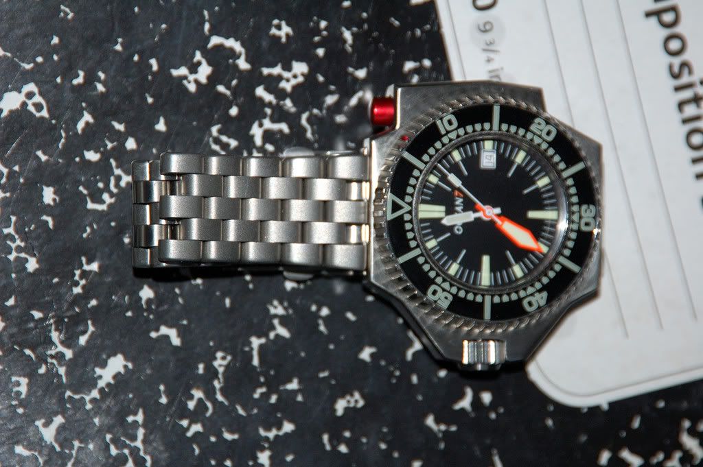

One other thing, the clasp from either a watchadoo 22mm or a 22mm seiko bracelet like a super oyster or the new bracelet that Harold has are completely interchangeable. So If you have a Seiko with a watchadoo you can fit the Seiko logo clasp to it so it now appears to be a Seiko logo bracelet. The reverse of this is if you are using a Seiko bracelet on another brand of watch if you use the watchadoo clasp it is now a brandless bracelet (See Orient Star photo). Having mixed brands logos on the same watch is a pet peeve of mine.
22mm fitting to monster
22mm Watchadoo over Standard Monster bracelet
22mm comparison to 24mm Watchadoo (24mm on Ocean 7 LM-7)

Watchadoo clasp fit to Orient Star 200mm with Seiko bracelet
