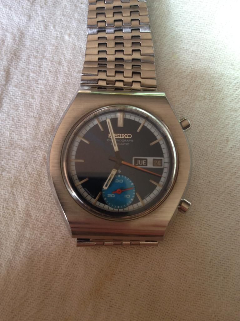

The next is the -8021. I had tried to look up info about this watch before placing the bid, but there little there. I was wondering if the group could give me more info on it. I used the date engine and it is the earliest of the 3, from 1969. The problem I see is that the movement stops unless the chrono is active. Took off the back, and the balance wheel(?) would stop, but when I pushed the start/stop it would start beating again. I think I read this is common, something to do with the Clutch mech. on the chrono (?)
But the bonus is that the wife likes the look and bracelet so she has adopted it for know. This looks to be a inexpensive bracelet that is trying to imitate something else, is there a name to this style of bracelet?
I rate this, condition TBD, but bonus as wife likes it.
