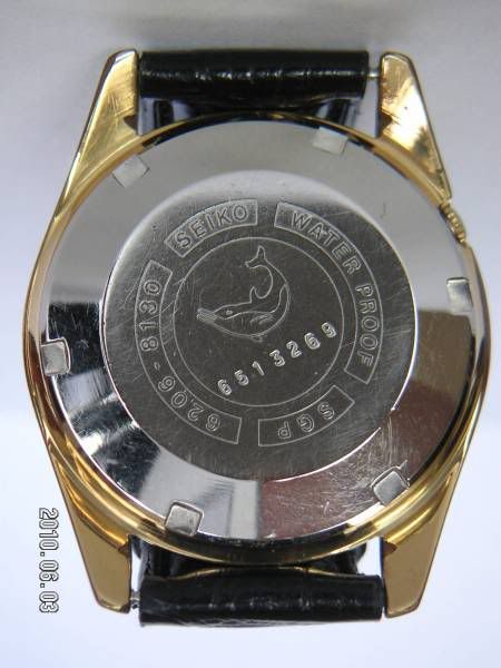

Early 6206 had a snapback case but this was soon replaced by the screwback. The caseback design is usually the well known dolphin but at the end of its life, the 6206 also has the simpler circular Seiko design. As usual, there is both SS and goldplated cases. Early 6206 use the etched caseback more sensitive to wear while the newer ones have the stamped version like the below picture. Cases also come with a number of different outer bezels both plain and more elaborate. All my watches have plain bezels so there are no other examples.

This is a 6206-8130 from 1966 in very good condition. Note the stubby hands.
