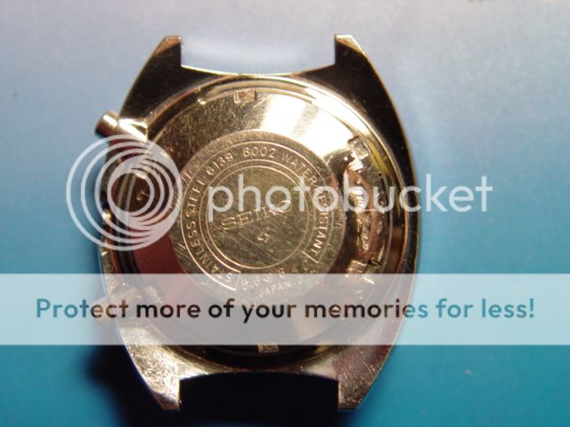

Humm...........Interesting and it turns out I have just such a specimen. I received this 6002 from May of 76' sometime ago. It had taken a hard blow to the crystal + case back shattering the crystal and mangling the hands. I wish I had take a before shot with the bent and tangled hands but I was in a hurry to see if it still ran so I straightened the hands a bit, popped in a used crystal, put on a temperary case back so the rotor could turn and gave it a few shakes and it was up and running. Simply amazing after seeing the blow it had sustained. I was under the impression that it had the wrong inner bezel but now I have to wonder. I had robbed the crown + stem for another watch and it's remained in my project box.

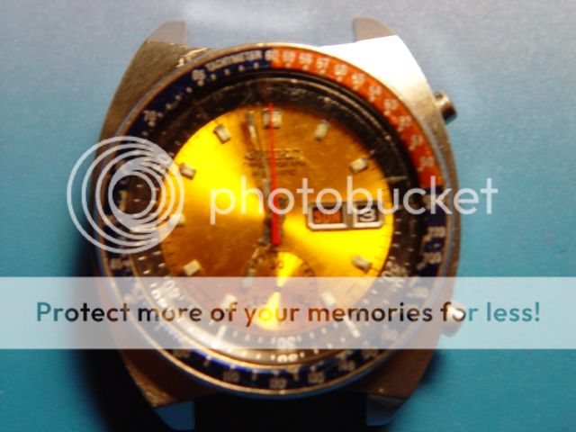

Polly bought this a few weeks ago, a 6002 with the black rotating ring and nice President bracelet. It did not occur to me it could be in original configuration but now you have me thinking. Mind you it's to late now
because it was a bit roapy with a butchered dial so I did this with it
sorry ;D
