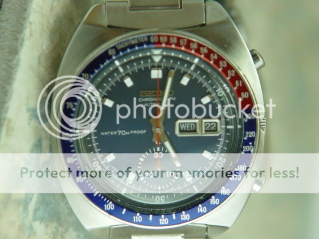

1970 Notched Case Proof Dial
1970 Notched Case Resist Dial
1971 Non-Notched case Resist Dial
Dials + Case backs The sunburst dials come in three different colors. Yellow, blue, and silver. Out of the three different colors their are four different variations of each color with the exception of the silver dials which have three different variations. The variations include: Sports 5 Proof, Proof, Resist, and Plain dials. The early JDM (Japan Domestic Models) Read "Sports 5 Proof" centered on the left side of the dial at the 9 0'clock position. .The early dial used in the non USA models during the first year of production read "Water70mProof" centered on the left side of the dial at the 9 o'clock position. These watches also read water "Proof" on the case back. From what I can tell the "Proof" watches were in production until sometime in mid 1970 at which time the script changed to "Water70mResist". The early USA models, 6009 + 6005, in production from 69' to early 72' read "Water70mResist" along with "Resist' on the notched case model case back and "Resistant" on the Non-notched case model case back. The last dial had no script at all in the 9 o'clock position of the dial but water resistant remained on the case back. I'm not sure of the exact date this dial went into production but I believe it was in mid 1972. Under the Seiko logo on the dial you will also notice two different scrips. On the 6139-6000's and 6002's it reads "Chronograph Automatic" and on the 6005's, 6009's, it reads "Automatic".
From left to right: Proof dial notched case...Resist dial non-notched case....and Plain dial non-notched case.

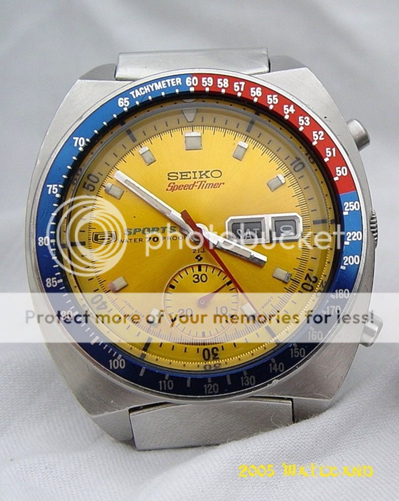

Blue Proof Dial from Feb 70'

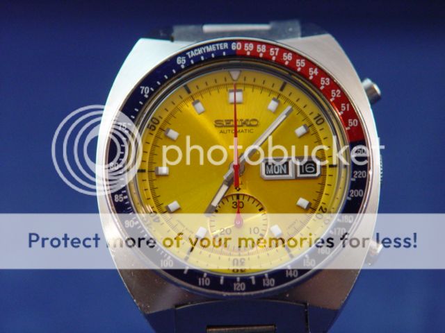

Yellow Resist Dial from 71'
Plain Silver Dial from 73'

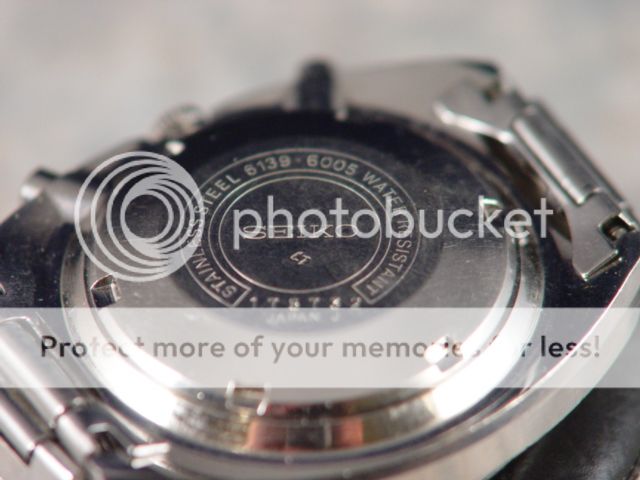

Case Backs
There are four different styles of case backs.
The first style is the "Horseshoe" Proof case back used from 69' to approximately mid 70' on the Proof dial models.
The next style is the "Horseshoe" Resist case back used up until July of 70' This is used on the notched case Resist dial models.
Third is the "Horseshoe" Resistant case back. This was used on the non-notched case Resist dial models and the plain dial models from mid 71' up until the end of production in 79'
The forth style does not have the Horseshoe style inscription and I refer it to as a plain style case back. It was introduced sometime in late 75' and is also used up until the end of production in 79'

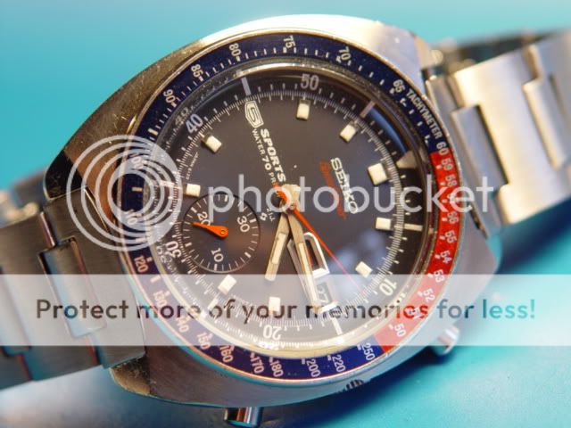

Also on the blue dials: You state that there are 3 different "Sunburst" dials, blue, yellow and silver. My dark blue dials are not of the sunburst kind, and I would think the ones we see from time to time (lighter blue sunburst) are taken from another 6139.
Re: Black dials - I don't know for sure, but I would have thought mine to be black until I held a really bright light source next to them. A faint blue shimmer is all I see.
Edit: It's no where near the blue shown in the catalog:
More like this (And there's yet another bracelet shown):

There are no Black dial 6139-600x' there are Black dial 6139-601X's and 6139-603X's.
The dark blue 6139-600X is a Sunburst dial. It's just not as apparent as the other colors and it's sunburst is quickly lost on somewhat faded dials.
The third bracelet you show is on a JDM. You are correct, it can be considered another style although is most often found on the JDM 6139-603X Speedtimers. Another review in progress.
