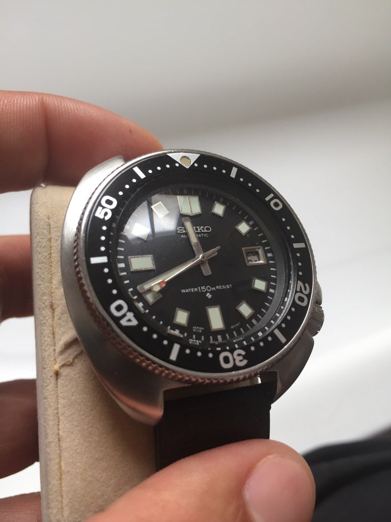

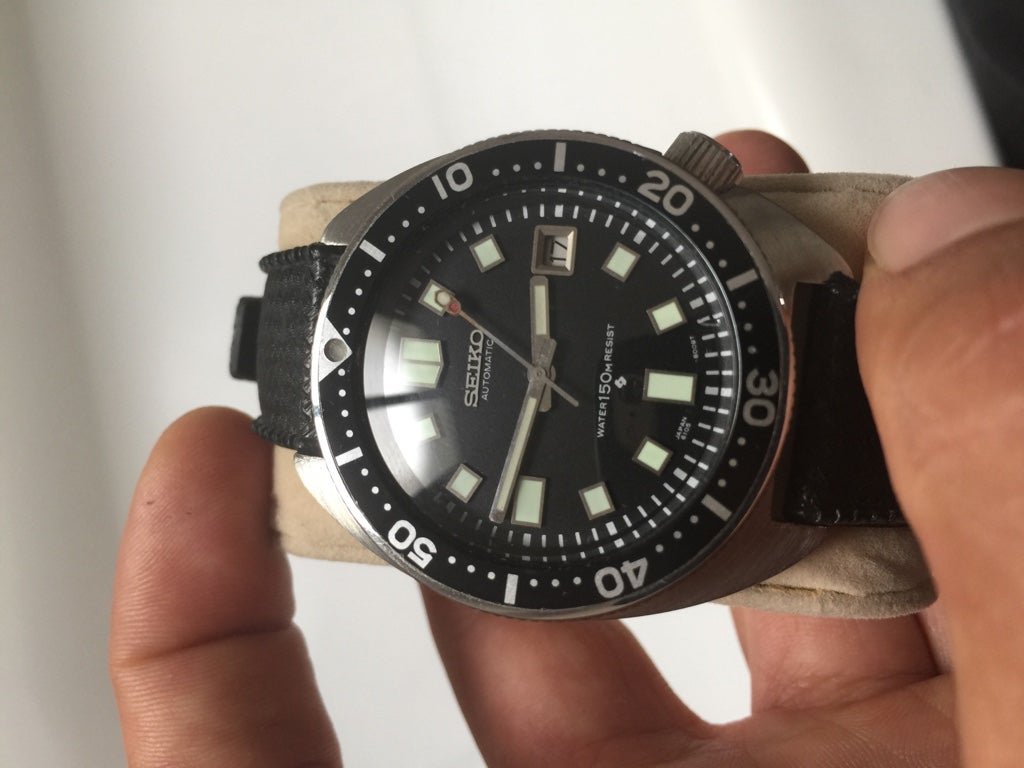

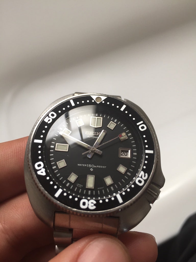

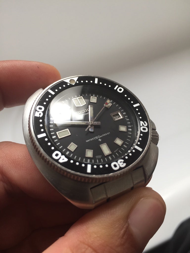

Recently I bought some vintage seikos, sold as completely ORIGINAL by the owner. I payed for them a lot of money by my red flags started when I noted that the dial of the 6306 Scubapro would be a repainted dial (may be from Loyswatch).

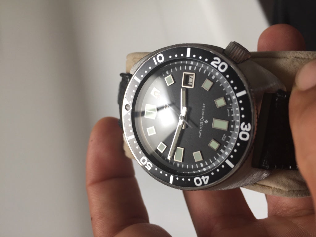

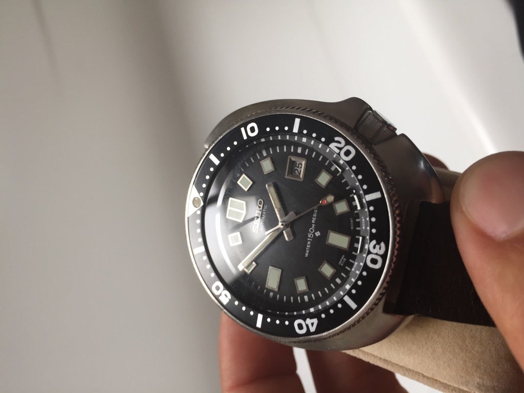

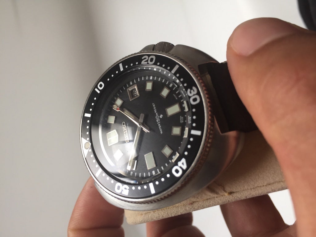

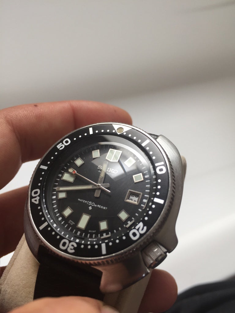

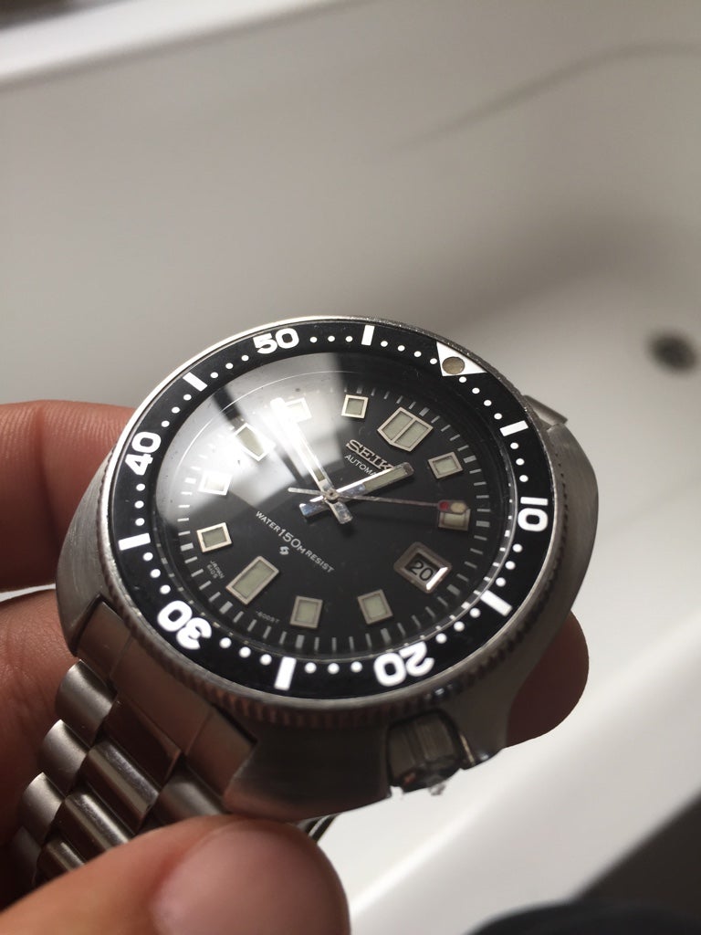

Still under the surprise of believe this dial repainted I started to analyze the rest of the seikos, and I have doubts of those:
What do you think??
Thanks in advance!!

540 Posts
In order from pictures
6309 scuba-original dial
6105-811x-original dial
6105-811x-aftermarket dial
6105-800x-aftermarket dial
24 Posts
Discussion Starter #3
Thanks for your reply. The first pic is a 6306 Scubapro. I believe this is a repainted dial

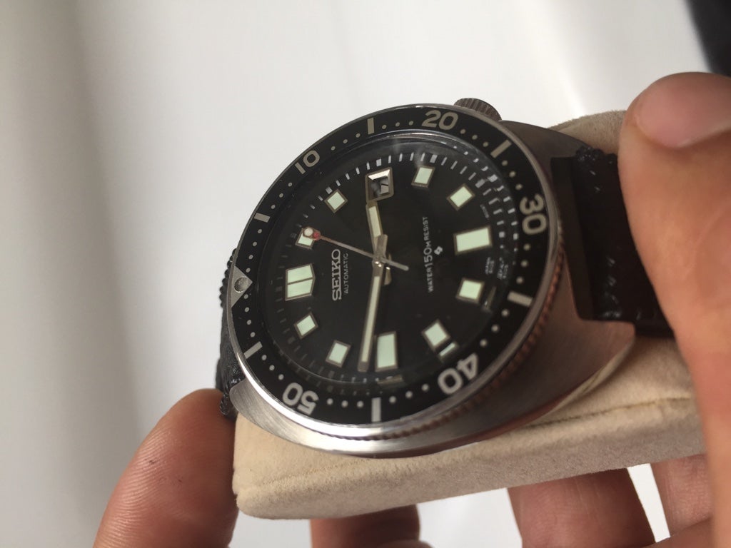

24 Posts
Discussion Starter #4
The last two pics (6105-811x and 6105-800x dials) no doubts they are aftermarket? I can see differences between the suwa icon of those tow dials and the first 6105-811x dial

540 Posts
Yea im looking at the scuba again and it just dosent look quite right.. it dosent pay to look at pictures first thing when you wake up.
347 Posts
ScubaPRO is reprint. 102%. I'm sorry.
Others, pics with some angle on hour markers would be better.

7,613 Posts
All AM inserts. The first 6105 dial is genuine with original hands.
The seconds 6105 has an AM dial and hands.
The third 6105 had AM dial and hands.
However, they're scary. The lume flatness and the dot in the Suwa logo are about the only clear signs. Maybe the shape of the minute markers too. However that's worryingly good and enough to really put me off spending any big money on a vintage 6105, especially if I was looking for a first one now.

I would say so. If it was me I'd be looking to return them all for a full refund. Even if I wasn't 100% sure on one of the watches I'd have no trust in the seller based on the other ones. The ScubaPro dial is not even a good reprint.
25,685 Posts
A full refund is in order. IMHO

4,937 Posts
Scubapro - the Seiko Logo doesn't look right. The "O" in particular. Do you have a closeup of that one?
I'd say "buy the seller" - and if he shook you down with at least two 6105 AM dials, you can be sure there is something fishy about the rest.
24 Posts
Discussion Starter #18
If they are so better did dials, are not there doubts the are legit?? May be those suwa icons are from a earlier period? I can't note other differences between both 6105 dials except the suwa symbol

7,613 Posts
It'd be great if you could remove the bezel and show the underside of it and then also remove the dial and show the reverse.
Edit. Obviously don't do this if you haven't before and especially not if wanting to be able to return them. But I don't know how long you've had all these...
