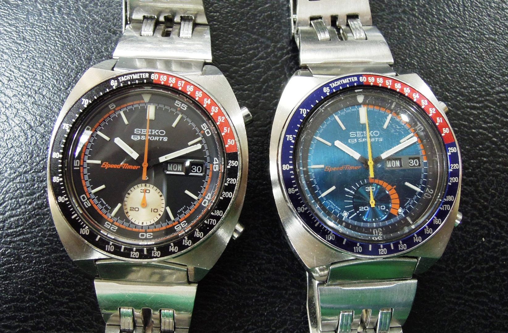

6139-6000
This is the early first version, created for the Japanese market (speed- timer) and the internationally with the movement 21 jewels ( only Japanese version) or 17, it was produced only for one year, must be considered very rare. It has notch case, yellow and blue dials. The Japanese version has a dedicated 5 sports bracelet and is a speed-timer.
a) 6139-6000 Yellow speed-timer variant 1969/early 1970: produced for the Japanese domestic market, bilingual dater (Japanese + English), 6139A movement 21 jewels, the case is notch (earliest productions until june 1970) or no notch, pepsi bezel, yellow dial sunburst type, dial code 6030T, upper written Seiko Speed-timer (orange), at 9 5 logo in yellow on black, water proof 70m, 21 j in the center, red chronograph seconds hand in two parts, red drop hand for subsidiary seconds continuous, baton hands for hour and minute, yellow rotating ring, case back Japan J, oyster bracelet type straight or 5 sports.
b) 6139-6000 Blue speed-timer variant 1969/early 1970: produced for the Japanese domestic market, bilingual dater (Japanese + English), 6139A movement 21 jewels, the case is notch (earliest productions until june 1970) or no notch, pepsi bezel, blue dial, dial code 6030T, upper written Seiko Speed-timer (orange), at 9 5 logo in white on blue, water proof 70m, 21 j in the center, red drop hand for subsidiary seconds continuous, baton hands for hour and minute, black rotating ring, case back Japan J, oyster bracelet type straight or 5 sports.
c) 6139-6000 yellow variant 1969/early 1970: produced for the international market, bilingual dater (Japanese + other), 6139A movement 17 jewels, the case is notch (earliest productions until june 1970) or no notch, pepsi bezel, yellow sunburst dial, dial code 6030T, upper written Seiko Chronograph Automatic, at 9 water 70m proof, red chronograph seconds hand in two parts, red drop hand for subsidiary seconds continuous, baton hands for hour and minute, yellow rotating ring, case back Japan J, oyster bracelet type straight or 5 sports.
d) 6139-6000 Blue variant 1969/early 1970: produced for the international market, bilingual dater (Japanese + other), 6139A movement 17 jewels, the case is notch (earliest productions until june 1970) or no notch, pepsi bezel, blue dial, dial code 6030T, upper written Seiko Chronograph Automatic, at 9 water 70m proof, red chronograph seconds hand in two parts, red drop hand for subsidiary seconds continuous, baton hands for hour and minute, black rotating ring, case back Japan J, oyster bracelet type straight or president.
e) 6139-6000 gray variant 1969/early 1970 : produced for the international market, bilingual dater (Japanese + other), 6139A movement 17 jewels, the case is notch (earliest productions until june 1970) or no notch, pepsi bezel, gray dial, dial code 6030T, upper written Seiko Chronograph Automatic, at 9 water 70m proof, red chronograph seconds hand in two parts, red drop hand for subsidiary seconds continuous, baton hands for hour and minute, black rotating ring, case back Japan J, oyster bracelet type straight or president.

This is the famous Coke, with substantial difference compared to the latre models, red/black bezel instead of pspsi and white chronograph minute counter subdial on the only version of black dial produced Only for the Japanese market gains 21 jewels and has a bracelet dedicated. Version very rare. I did not detect variations between the reference 6139-6030 and 6031. It 's a speed-timer.
a) 6139-6030/1 Black speed-timer variant 1969/early 1970: produced for the Japanese domestic market, bilingual dater (Japanese + English), 6139A movement 21 jewels, the case is notch (earliest productions until june 1970) or no notch, black/red bezel, black dial, dial code 6050T, upper written Seiko Speed-timer (orange), logo 5, at 9 sports, water 70m proof, orange chronograph seconds hand in two parts, orange drop hand for subsidiary seconds continuous, white and black baton hands for hour and minute, black rotating ring, case back Japan J, oyster bracelet type straight or 5 sports.
b) 6139-6032 Black speed-timer variant 1969/early 1970: produced for the Japanese domestic market, bilingual dater (Japanese + English), 6139A movement 21 jewels, the case is notch (earliest productions until june 1970) or no notch, black/red bezel, black dial, dial code 6050T, upper written logo 5, sports, at 9 speed-timer, orange chronograph seconds hand in one part, orange drop hand for subsidiary seconds continuous, white and black baton hands for hour and minute, black rotating ring, case back Japan J, oyster bracelet type straight or 5 sports.

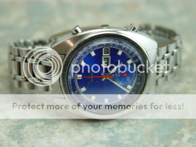

Hope you can insert this variant to your extensive list, a blue dial variant on the right, from my 6139 Speed Timer collection, I don't know where this variant goes to the list, back case reads 6139-6002, serial number 2Dxxxx
Thanks, i forget this 6139, it is 6139-6000, rare model, i will update the catalog with this variation. Very nice.
