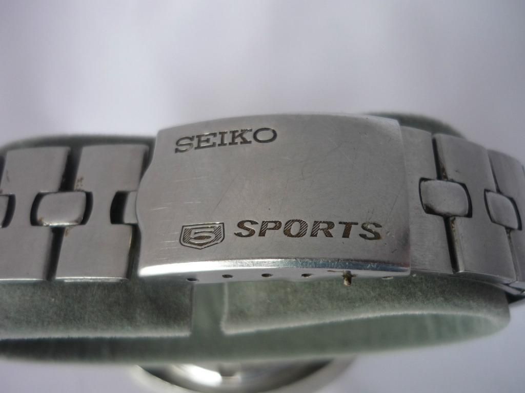

Here is what Polly bought
Not too bad eh? Well, I was banking on a quick service, crystal, hand repaint and relume but upon unpacking the watch my plans were shot down.

For the bracelet I had a spare 22mm solid link Genuine Seiko Jubilee left over from my divers watch days. I bought a cheap 20mm straight endlink Jubilee off watchgecko and fitted the endlinks to the 22mm jubilee. It's very comfortable and the weight suits the head better than the original UFO bracelet. Great as this is going to be a regular wearer beater watch.
