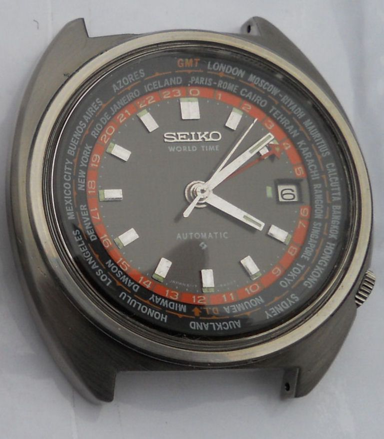

Looking to tap into some of your expertise. I was on our favorite auction site and found a newly listed 6117. Look up "seiko 6117-6040" as it is listed in error.
Here's the funky thing...the seller states it is an early error dial. What I see is that the placements of "automatic" and "world time" are the reverse of any other I've seen. Fake dial?
Thanks,
Mike

Looks like the "AUTOMATIC" and "WORLDTIME" were applied at a later date...I am no expert
Thanks!
My 6117-6400 with bezel error not dial error. The 6117 was not a early World Time watch. They had the 6200 series back during the 64 Olympics in Tokyo. What the error dial (bezel) is the GMT is next to London and London is over Paris-Rome which is wrong as Paris is +1 hour to London 'where time begins'. :)
So...do you think the photo above (the black and orange model) looks legit? Thanks!

Mike, IMHO that case has seen at least one Wheel...
You could be right DAHASCO. Crystal doesn't look right profile either. Here's a poster from the '70s showing the high shine finish as standard :) I'd search the previous listings of this forum of a guy listing one for sale. It was super clean just missing it's bracelet.
Forgot you'd offered me one John! Sorry. It's got the GMT error bezel too.

I think the top ones are shiny and the bottom ones are brush finished. Only ones I can see that are brushed are ones that people spun in a lathe and not the correct brush metal effect that Seiko always used.

The cases are all polished on these 6117-6400's. Here is a photo of an original one I have that, as far as I can tell, has never been polished. Mine also has the inner bezel with the mistake.

Need to agree - AFAIK, all 6117-64xxs had fully polished cases.
The 6117-640x dials were available with "World Time" and "Automatic" at 6 and 12 o'clock, respectively - and also the other way around!
