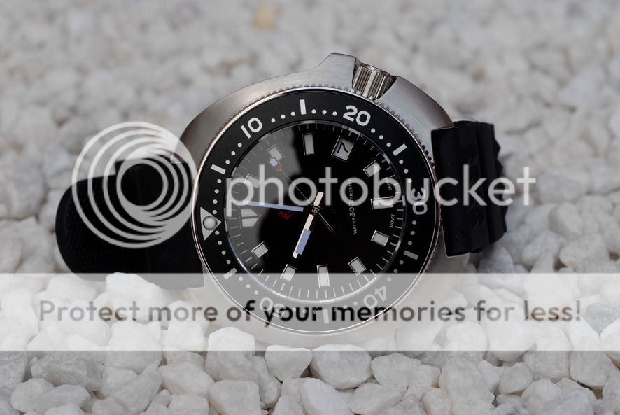

I have owned a T2 Typhoon for just over a year now, which is a great watch but comes on a MM style rubber strap as standard. Dagaz do not offer a bracelet option as this of course is dedicated to the TII version.
So I have been looking for a bracelet that will flatter the watch and fill the lug gap as well as the rubbser strap does.
I tried mesh to begin with which looks great, but still does not fill the gap enough.
Then I found a straight end bracelet which was an improvement and kept me happy for a while but it was still not perfect.
So I started looking for a 20mm oyster style bracelet with substantial end links and finally narrowed it down to either a monster or BFK kinetic bracelet. In the end I took a gamble on the BFK bracelet expecting that a little fettling would be required to make it fit.
I was surprised that in fact quite a bit of filing and fettling was required to seat the link correctly to allow the fat spring bars to align with the lug holes, but I think that the effort was worth it in the end and I think is the closest you may get without a bespoke solid end link for this watch.

Need a wrist shot to really see how it lays. What was the source for this one and does it take 2.5mm spring bars or standard?

Hi Saul,
That bracelet was a cheapie from an ebay seller called bandfever, around £10 including postage if I remember correctly. It is suprisingly good quality, but takes standard spring bars which is why the straight end link is a little too narrow for the Typhoon.

Here's mine with the BFK bracelet, like Mark i'm a bracelet guy and the mesh just didn't quite hit the spot for me either. I'd heard the BFK could be made to fit so i bit the bullet and got out the grinder!

Hi Andy,
Ah, seems great minds think alike! I took off the first wide flared link to narrow the bracelet where it joins the end link. It is a little daunting taking a file to the bracelet that you have just unwrapped, but worth it once it finally fits!

Hmmmm... Taking off the first wide link is a clever touch, didn't think of that. I could do that then replace the thinner links from when I first sized the bracelet. I didn't buy a new one I just nicked one off my BFK and put that on a mesh.

With a little work I fitted an oyster bracelet to mine with a pair of JK's 6309-7040 endpieces adapted to fit. It's not easy but possible with the right method.
Been wearing it today, I changed my mind about rubber on a typhoon this is much better for comfort.

Mike's mod for the win:grin:
The others look good and will be comfortable but Mike's fills the gap like its meant to

I just stumbled upon this thread while looking for bracelet options for my Dagaz T2 Typhoon and I saw PollyC's watch which looks amazing! Does anyone happen to know where I can buy those endlinks? How much filing did you have to do to get them to fit? Any help would be greatly appreciated:)

They're getting tricky to get hold of, they were made for the 6309-704x models by the late Jonathan Koch aka swedefreak. Mike then modified them to fit the typhoon.

You will need a pair of East Tech 22mm 6309 endlinks. Start off by reducing the width to 20mm to fit in between the Typhoon lugs and then you will be able to gauge how the link endpiece needs reprofiling. It will take patience and is not particularly easy but obviously is possible (I did it). Took me about an hour and a half of careful dremeling and fileing and fitting the endpieces regularly to check the progress. The interface with the head requires the endpiece to be feathered slightly.
