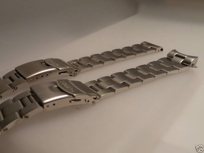

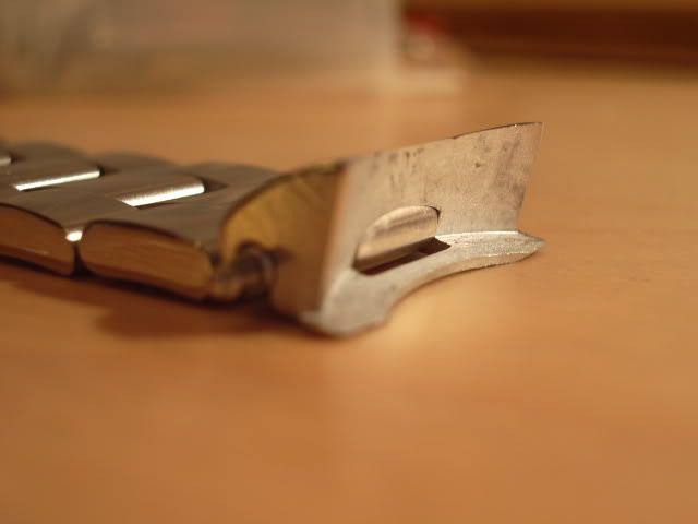

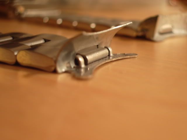

The bracelet I received is a 22mm Type II bracelet with solid curved end caps, made to take fat Seiko spring-bars. Here are some pictures (mine and Will’s) of what the ends look like:
Here is what the link looks like mounted on the bracelet:
Here is what it looks like mounted on a watch, showing the underside with the spring-bar in place:

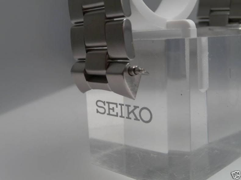

And here is a picture showing the end-cap and the first link in the bracelet showing the oversize spring-bar whole specifically made to take fat spring-bars:
Here are some pictures comparing the Type II’s solid end-cap to the open style of the one used in the standard Super Oyster:

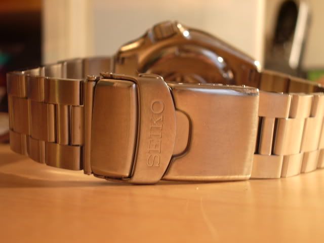

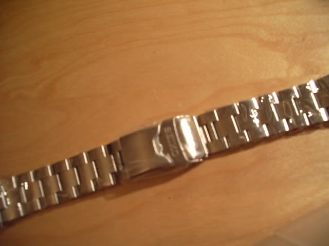

The clasp is another one of those differences. The Type II uses a 20mm spring loaded flip-lock clasp, which is used in one of Seiko’s Y-link bracelets. This one is probably a Chinese copy of the original, but like with the Super Oyster, I couldn't tell the two apart (and it is very well made). This essentially the same type of clasp that Seiko uses in the monster, the sumo and many of their divers, but 2mm wider, with no divers extension, and with 4 micro-adjustment holes. This is essentially the same clasp used in the standard Super Oyster, but 2mm wider. As I understand it, Will defaults to selling these with 4 micro-adjustment holes, but in the occasional case that someone wants one with 2 micro-adjustment holes, those can be special ordered.
Here is a picture of the clasp closed:

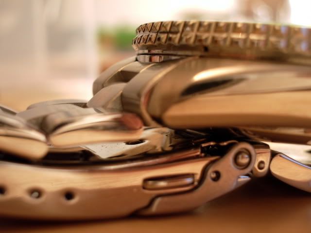

and here is the Type II (left) next to the clasp used in the standard Super Oyster (right):

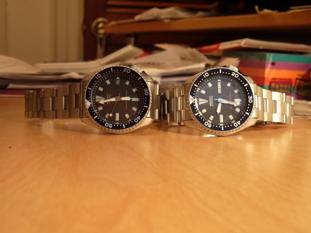

As a parting shot here is a final picture showing my SKX173 with the Type II (right) next to one of my 7002’s which lost its Jubilee in favor if a standard Super Oyster (left) :
