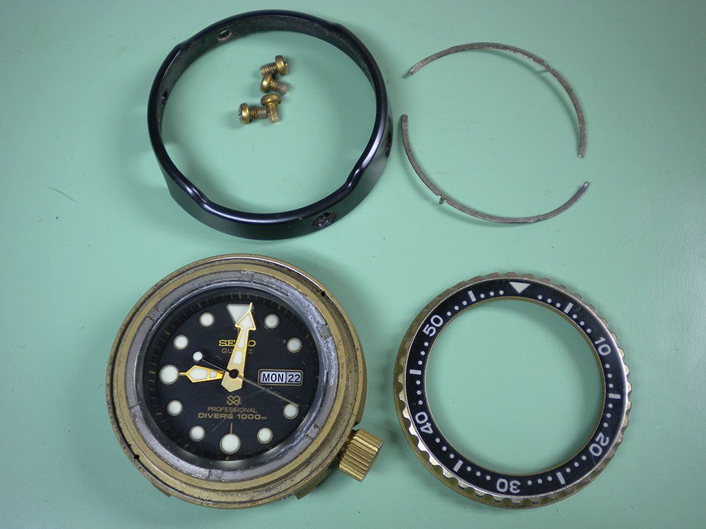

Here's how it went, the shroud and bezel removed

While the pressure testing was going on I ultrasonically cleaned the bezel and shroud components. The bezel isn't loose like a lot of older tunas, it feels just right to me after cleaning and slicone greasing the o-ring - firm but not tight.
