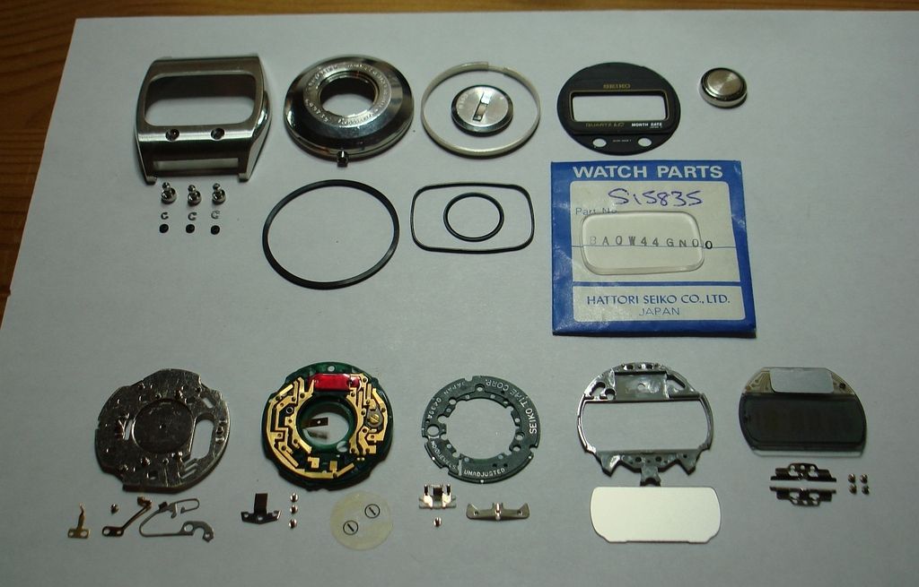

I like the simple design of the early six digit Seiko LCD watches. Before going for an iconic 0624 'lemon', I decided to try a much cheaper but very similar 0439 project as a learning exercise.
I bought three scrap 0439s very cheaply, I picked the best one to work on (see the 'before' photo below), and the other two I used for spares.
I got a set of gaskets and a crystal from various suppliers, with the help of Mike in the US - thank you Mike! I also found a NOS SQ bracelet, but it had to be modified slightly.
All went well, it wears a bit small, but the grab-and-go ease of use is a winner.

Nice Citizen, I quite like that one. The 0439 is similar to the Lemon, but the 0439 has Day and Date display, and an AM/PM display which the 0624 doesn't. The 0439 is a little bit smaller than the 0624. After fixing this one, I've got an 0624 incoming, but that might take a bit longer as the parts are much harder to find.

I had to put the gasket in the freezer before fitting as it seemed to be a bit stretched (even though it was NOS). After that it just took a lot of pushing with all the thumb pressure I could muster to get the crystal flush with the case. I then had to be careful doing the final assembly of the case and caseback to avoid pushing the crystal out again.
How did you find the crystal replacement on that model ? easy / hard ?
The similarity of those 2 models in question stops at their initial look.
Case assembly , crystal and circuit assembly is completely different
