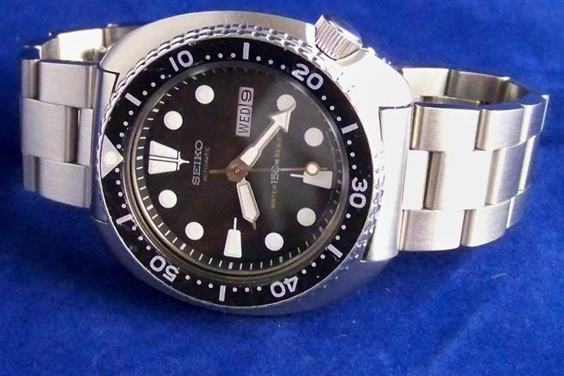

Dave covered just about everything. I asked about mesh on 6309s last week. Here's a pic:
The day/date is a quick change - pull crown to first stop, rotate one direction for the date, opposite direction for the day.

Wow, Jeff, those mesh do look 8)
I've gotta try one out, where to buy those ones? They look slightly different from ones I've seen before and even the one I have for my monster, too bad its 20mm and won't fit on my 6309's.
thanks, Dave.

And about the bracelets, I'm pretty sure a mesh was not stock, but would it be period correct? And what about the oyster? The cool thing about that mesh is that because of the shape of the case, there's only a small gap between the spring bar and case, and therefor the bracelet looks good. I for one don't like when there's a big gap, like for instance what you see when you put an aftermarket without end caps on a Sumo
