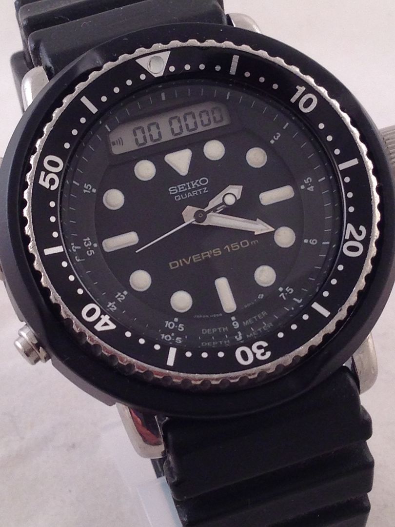

I recently was given a Seiko h558 by my grandmother, it was my grandfathers watch and has been sitting in a box for fourteen years. The bezel cannot be turned and the buttons are stiff. It also needs a new shroud. Can anyone tell me where in the Portland Oregon area I can take it to be looked at. I would really like to get it up and running again so that I can wear it in memory of my grandfather. I attached a picture so you can see the condition of the watch. Thank you for any help. Analog watch Watch Watch accessory Fashion accessory Jewellery

Hell yeah man....you got a great watch and a great memory of your grandfather! Chris above laid it all out there, but I'll add this: I've "restored" two Arnies in the last couple years that were in far worse shape that yours. There isn't really anything to it that's too difficult. Do both the analog and digital functions work? You'll need a few basic tools to work on the case, but other than that it's not rocket science. The bezels are notorious. On these watches for seizing up from years of crud, but they do come loose and with a new gasket they work great. The buttons probably need new o-rings and a lubing as well. Removing and installing the c-clips that hold them in place is probably the toughest part.
I put a oversized aluminum shroud from the eBay seller "armsaver" on my current one, and it looks great. If you can afford it, one of the new DLC'd shrouds would be even better.
Best of luck. If you have any questions, ask away!
Chris

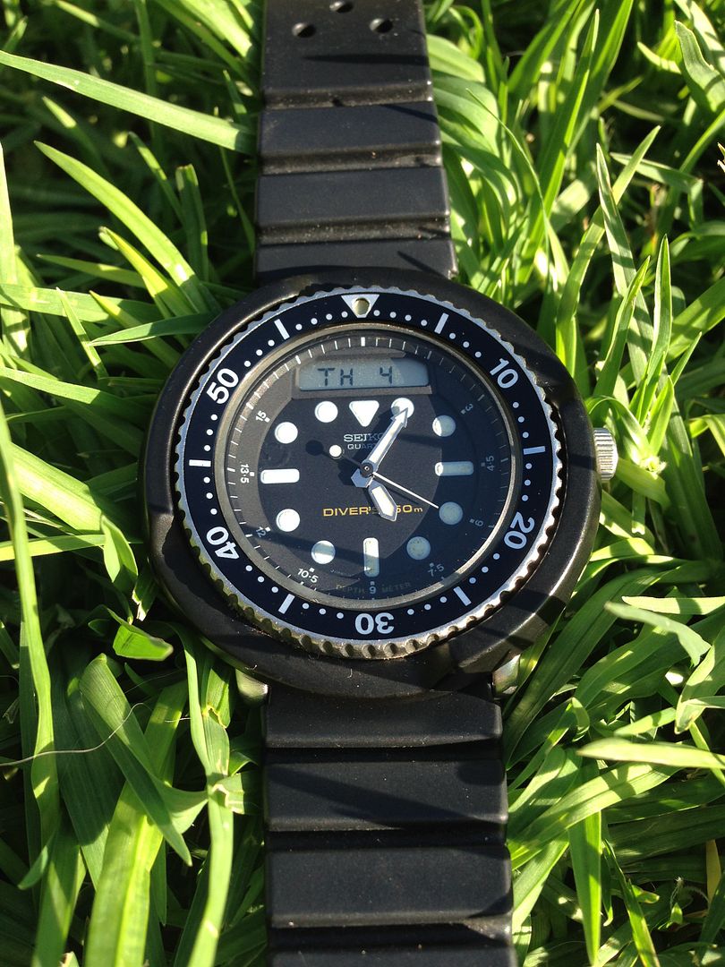

Before:
After:
Your grandfather would be pleased.
Worthy project.

After shot -
Looks beautiful, indeed.
