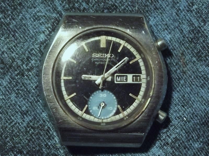

Well I finally jumped into the crazy world of 6139 chronographs. I have a bunch of quartz chronographs world timers and such but all are quartz. I came across this and It was offered to me for a good price so I said why not. I repair all of my own movements and I know how tricky the 6139 movement is so that is why I have kind of steered clear of them. Fortunately the movement is clean but the watch is a little banged up and did not come with a bracelet. Here she is. I refuse to pay someone to refurbish a movement so if I can't do it I typically will not buy it.

Should be very nice after some tlc :) The crystal is acrylic, easy to remove scratches :)
Not bad, sort the hands out as well - or just practicing on the 6139?!

Well she showed up yesterday. Not running as advertised so I though I would take a peak and removed the back cover. The movement is absolutely spotless! I gave it a good shake and took a look inside and the balance wheel was humming away but when I flipped it over no movement from any hands? Both buttons are frozen solid so I gently gave each lever a push from the inside and the chronometer dial reset to zero and the minute hand started. It ran for about a minute then the hands stopped again. So apparently it looks like things are just sticky though the balance wheel never stopped running. Time for me to break out the books and read the link on the ins and outs of the 6139.
