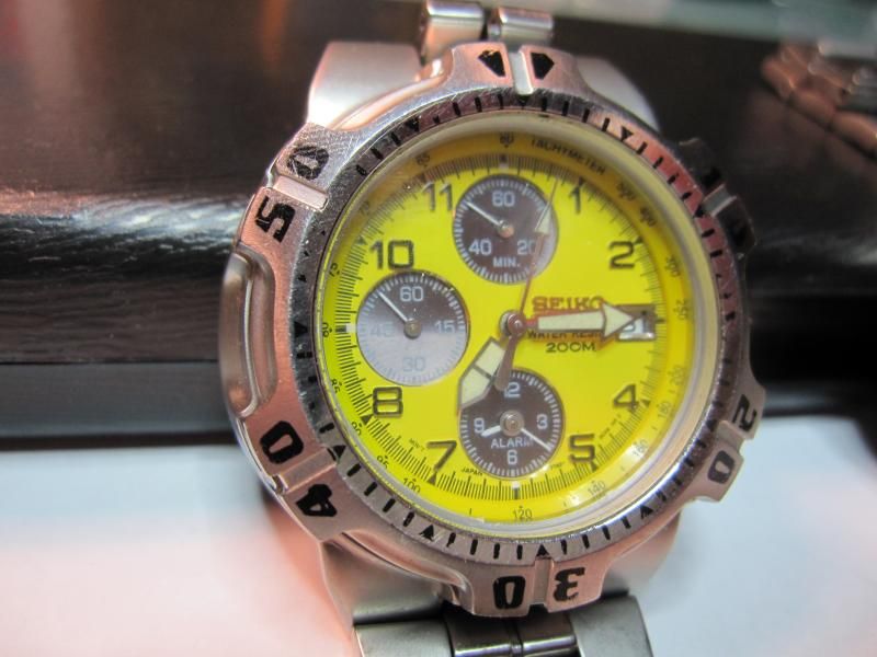

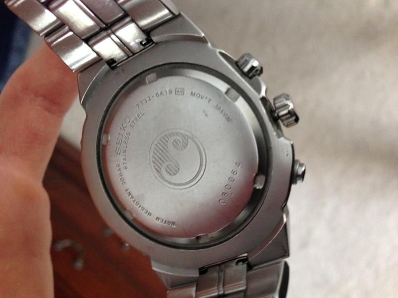

I came across this a couple of months ago but after the post with the other rear case model number weirdness I decided to point another that I ran across. Below are front and rear pictures of the Seiko 7T32-6K19 Chronograph.

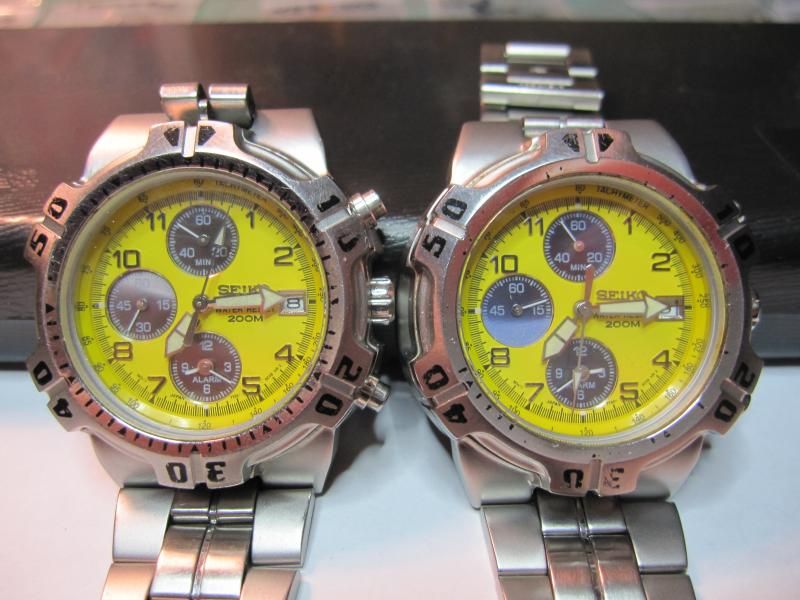

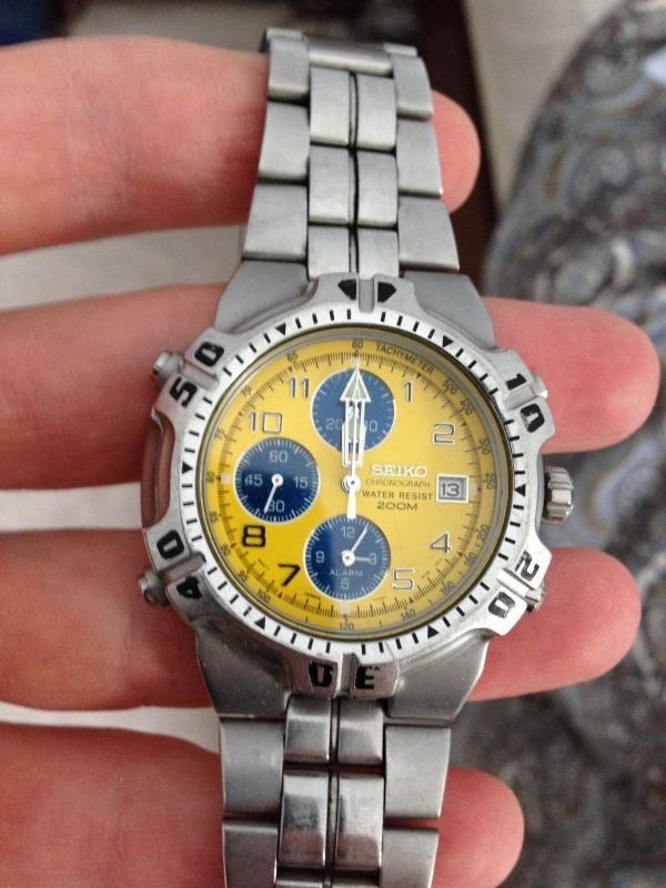

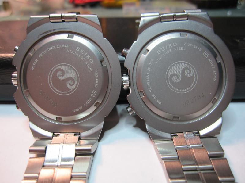

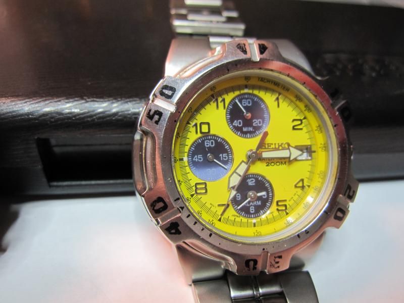

Now the strange part. I receive this watch in a parts lot. It was described as a 7T62 watch with the wrong case back. The case back match the watch perfectly fit and even glass bead finish but it had 7T32-6K19 on it. I did not care. It worked and I liked the unusual colors. A month later a watch comes up for auction labeled as a 7T32-6K19 but in the pictures the case only has one crown and two pushers all on the right. It was a good price so I bought this watch. I open it up and it to has a 7T62 movement inside but again the rear case is marked 7T32-6K19. Here is a picture of both 7T62-6K19 with cases displaying 7T32-6K19 marking. Two different sellers two months apart? and to really blow you mind the serial numbers are only 5 digits apart!

The last 2 are Feikos.
Serial numbers are etched, not stamped, Seiko font on the back is wrong, and the waves have the wrong curl (crest?) to them as they actually turn upwards.
I'm sure if you take the caseback off the movement will also be wrong since the Feikos are missing the chrono pushers at 8 and 10.

I don't know for sure. Most Feiko's I have seen are an absolute joke that even an amateur could spot half the time. I had the case back off of both watches before but I took them off again for an extra close exam. Both watches have real Seiko 7T62A movements. There is no doubt they are real Seiko 7T62 movements. I have several watches with the 7T62 so I took one out and even under my magnifying lamp I can not find one single thing on either that is not identical to the 7T62 I took out of the other watch. Also both dial are correctly marked as 7T62 dials and the marking are consistent with Seiko dial markings. Movt' Japan 7T62 0CV8 HR2.
Here is the movement in both watches. First picture is the one in question Second is the one I took out of one of my 7T62 watches.
Even the inside of the case style is consistent with a 7T32 and even marked the same with Seiko Time Corp Singapore TL and the small sticker that 7T32 movement rear cases have on how to reset the board. The 7T62 does not reset this way and it looks like the label has been peeled of leaving behind some paper right where the label would have been.
Press on 7T32 rear case
The rear case on this watch which is a thread on style.
So far I can not find any hard proof that this watch is fake. If it is fake why does it have a real 7T62A movement in it. Why are so many small details that no one would even care about or see like the inside of the rear cover look right? If it is fake it is the best fake watch of any brand I have ever seen.
