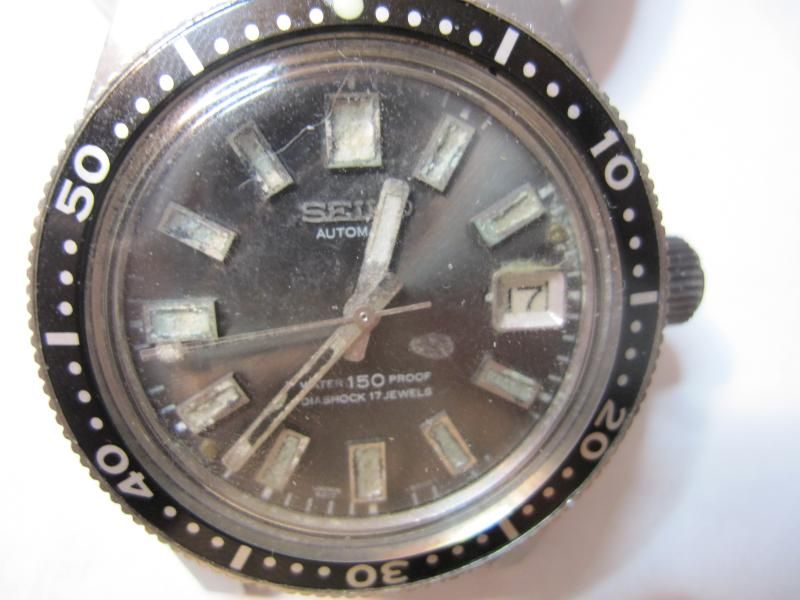

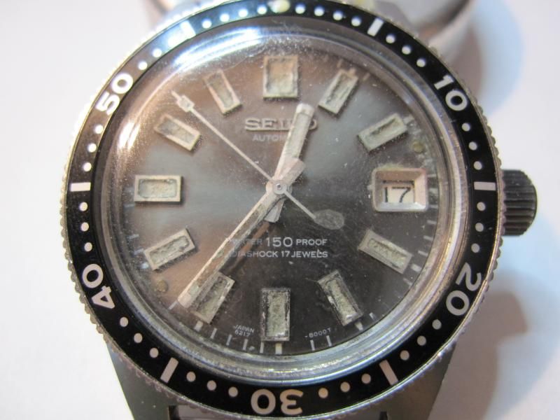

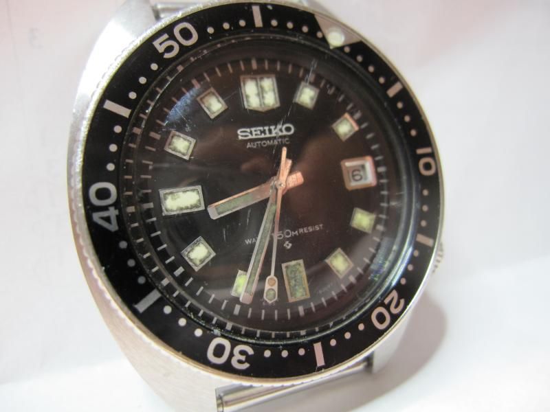

Thanks Dutchsiberia. You pretty much nailed the one thing that really bothers me about my 6105-8000. The lume on the dial has turned colors and looks like moldy tile grout.
The dial on the 6217-8001 has the same problem but not quite as bad. I have to make a couple more post before it will allow me to post pictures of them both. I will post them up as soon as I can.

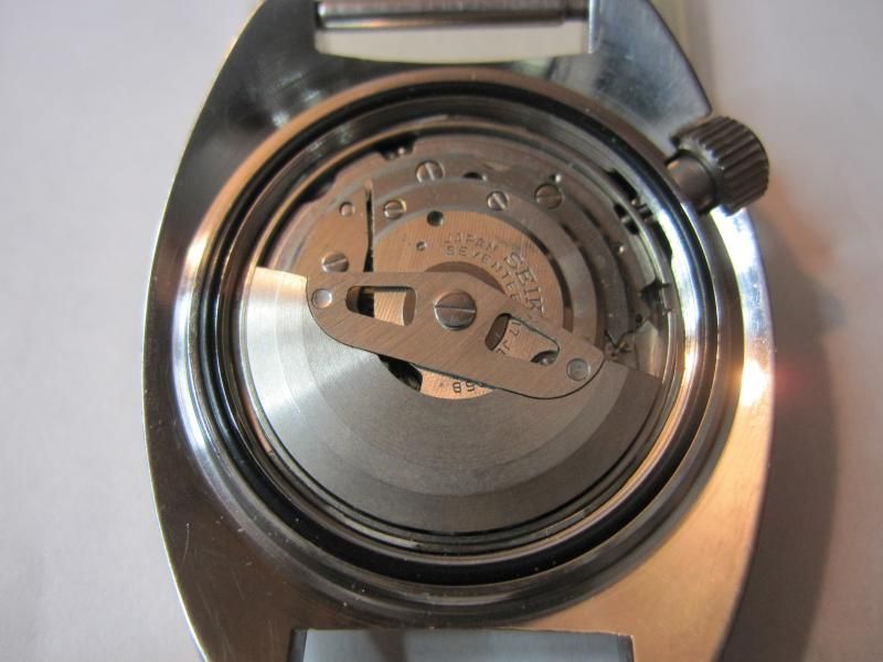

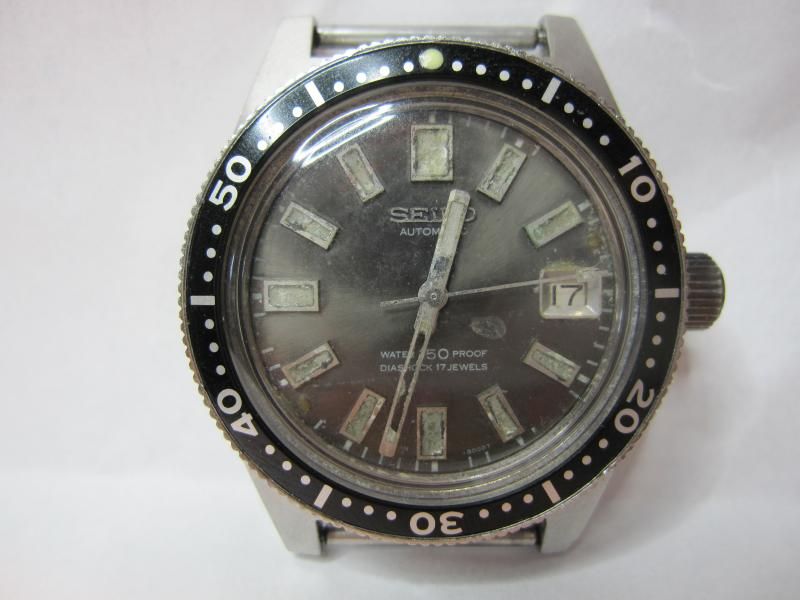

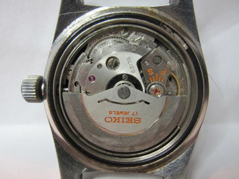

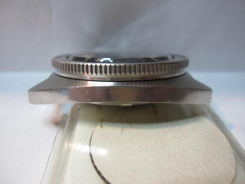

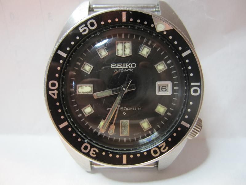

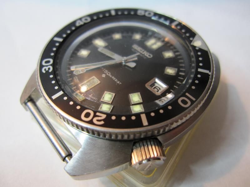

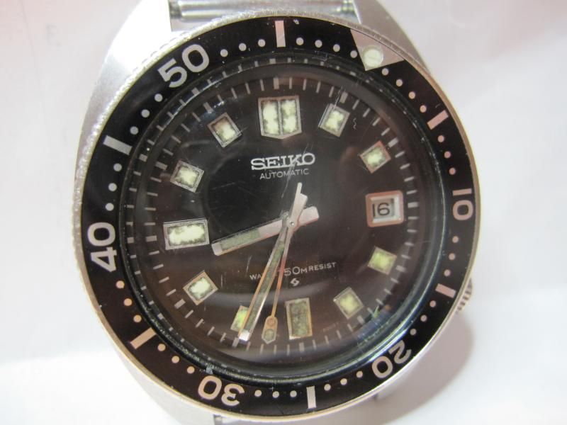

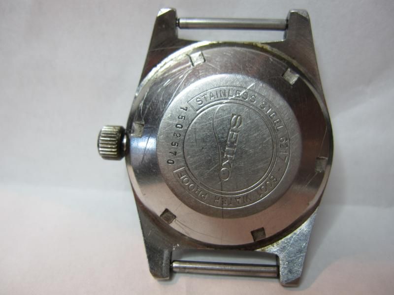

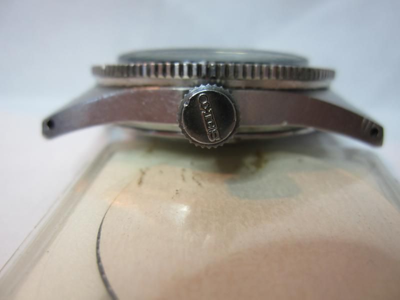

Ok finally some pictures! First here are the pictures of the 6217. I'm not sure if this dial is can be saved.

I dug out a 6105 dial that I had removed from an old diver that I modded and practiced picking away at the old lume first with a round wooden toothpick chucked up in a pin vise so if I slipped I would not scratch the plating. once I got deeper I use a dental tool with a slight bend at the end that comes to a point to dig in the corners and get them all clean out good. I have to say I think I did pretty good. No damage to the chrome around the edge but I did slip once and put a small scratch in the paint on the dial! Your right it is addicting. I have always enjoyed repairing things if possible instead of replacing them. I'm not sure if the 6217 dial can be saved but I am 100% confident I can redo the lume on the 6105 dial now.
