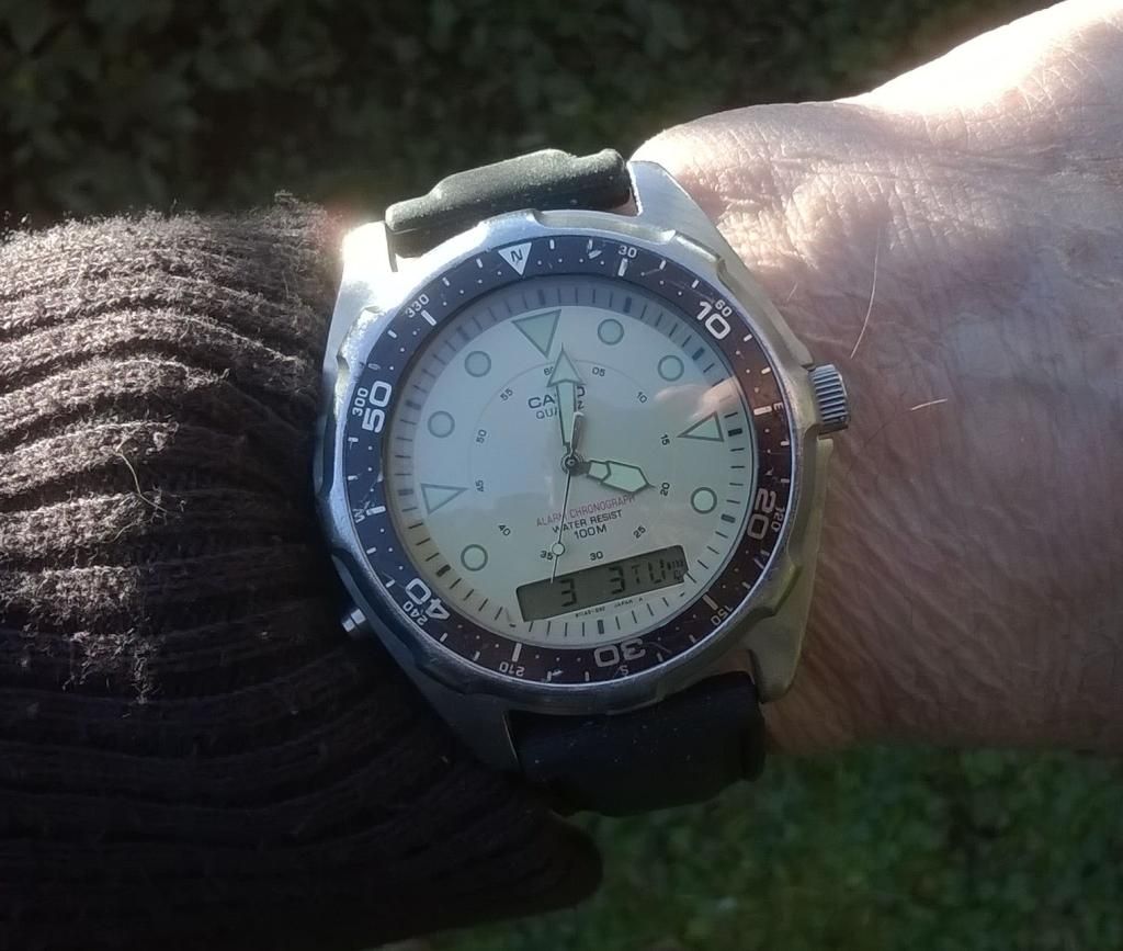

The crystal in my watch Michael has no bevel edge at all but rises as a dome from the point it fits into the case, the top of the dome protruding 1.56mm above the top face of the bezel. This is what it looks like now I have improved the chapter ring alignment (perfect at 3 o'clock and at 6 o'clock but still out a bit at 9 & 12 :confused:) and re-seated the crystal which has allowed me to flatten off the bezel insert insitu, so it is not distorted at all now but has some marks. I might well be able to touch up the scratches with black then lacquer the insert, well worth a try.

I would be willing to beat it is the wrong crustal fitted in that case. Seiko Citizen Casio they all love their beveled edge crystal of their larger watches and almost always use them on the watches with rotating bezels. That dome probably rises to much to quickly from the edge making for a really tight fit for the bezel insert. Both of mine have beveled edge crystals in them much like the Seiko SKX divers and they are dead flat all the way across.

Well a small update.... this morning, in my somewhat half asleep state I dropped the watch in the bathroom! :eek:hmy: I picked it up, with some trepidation, expecting to see the crystal cracked, or the hands loose, but no all was well. However something had been jarred! The chapter ring now lines up perfectly on all points of the watch face :cool: Now there's a result!!
Ok confirming, as I suspected, that the crystal was not OEM. It is a very high dome one though and the rise of the dome takes it away from the bezel insert, such that there is probably about a 0.2 mm gap, all the way round between the crystal and the inside edge of the bezel insert, now that the crystal is fitted properly :)
