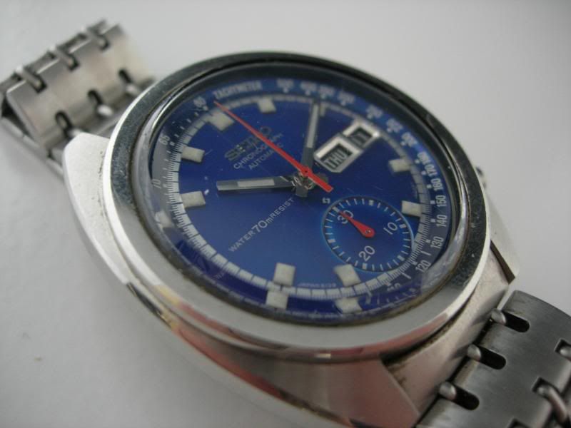

I had to share this one...
I know I don't need any more of these, but when ever one shows up on the cheap, I can't resist. They are a steal. Well made and after all these years, many of them work like a gem. Can you say that about a Swiss watch?
This one cost so little and is really in nice shape. I just took it out of the box and didn't do anything to it. Just snapped some pics. The bracelets are poor, and the end links never look right on this model. (Any help in getting them to fit better, let me know).

Nice find Dan! I picked this one up a while back.........

I like that one Dan,Gorgeous dial and is that the Original bracelet on that one?I dont know enough about them.
Nice find Dan as always mate. 8)
