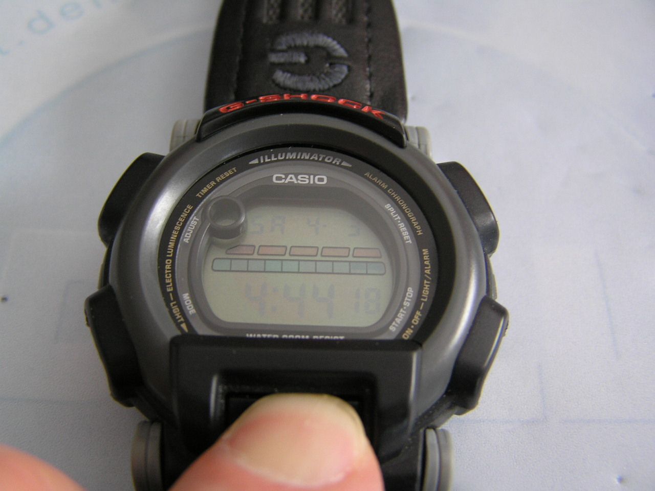

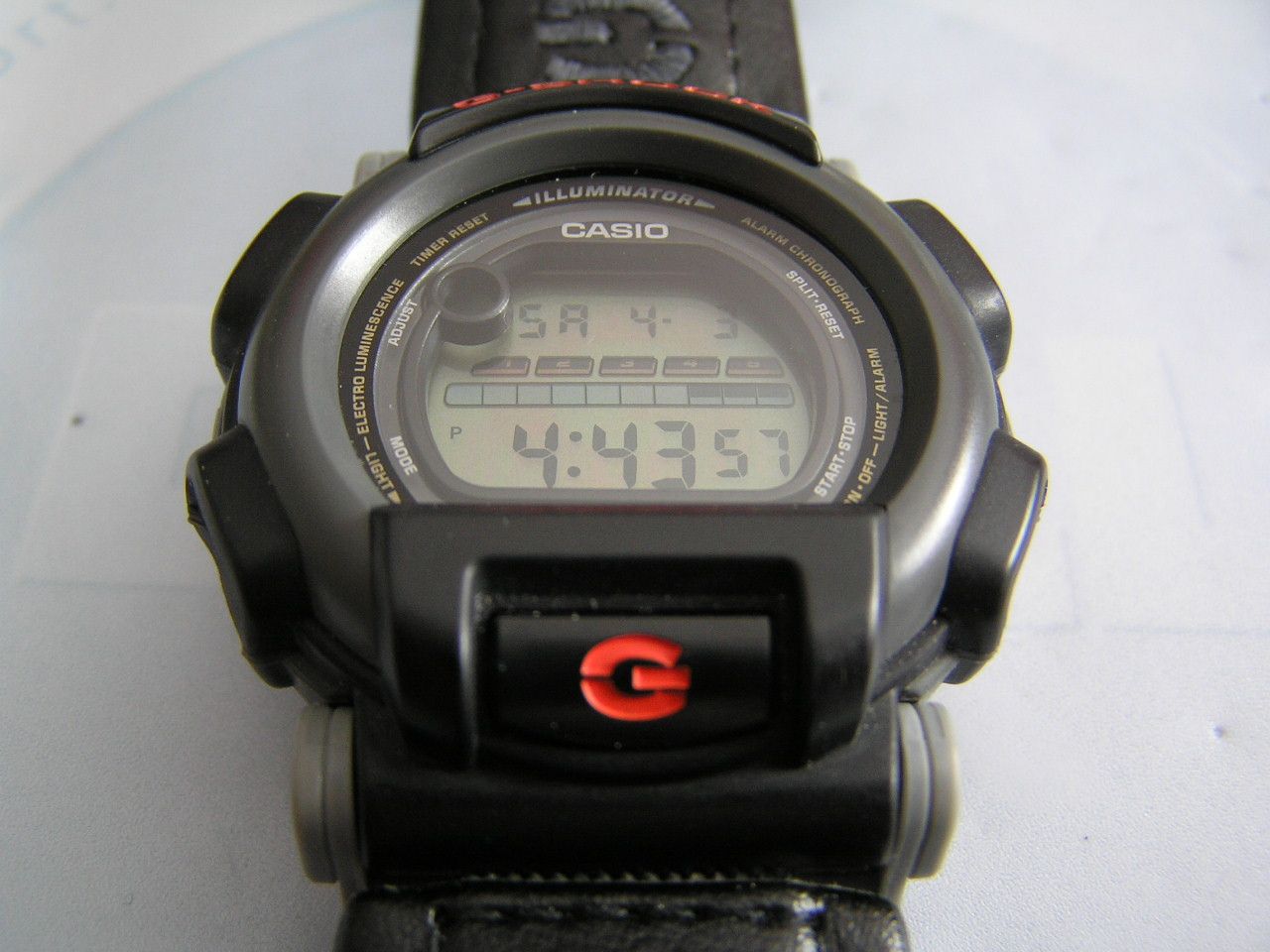

Display looks fine when the watch is just sitting there:

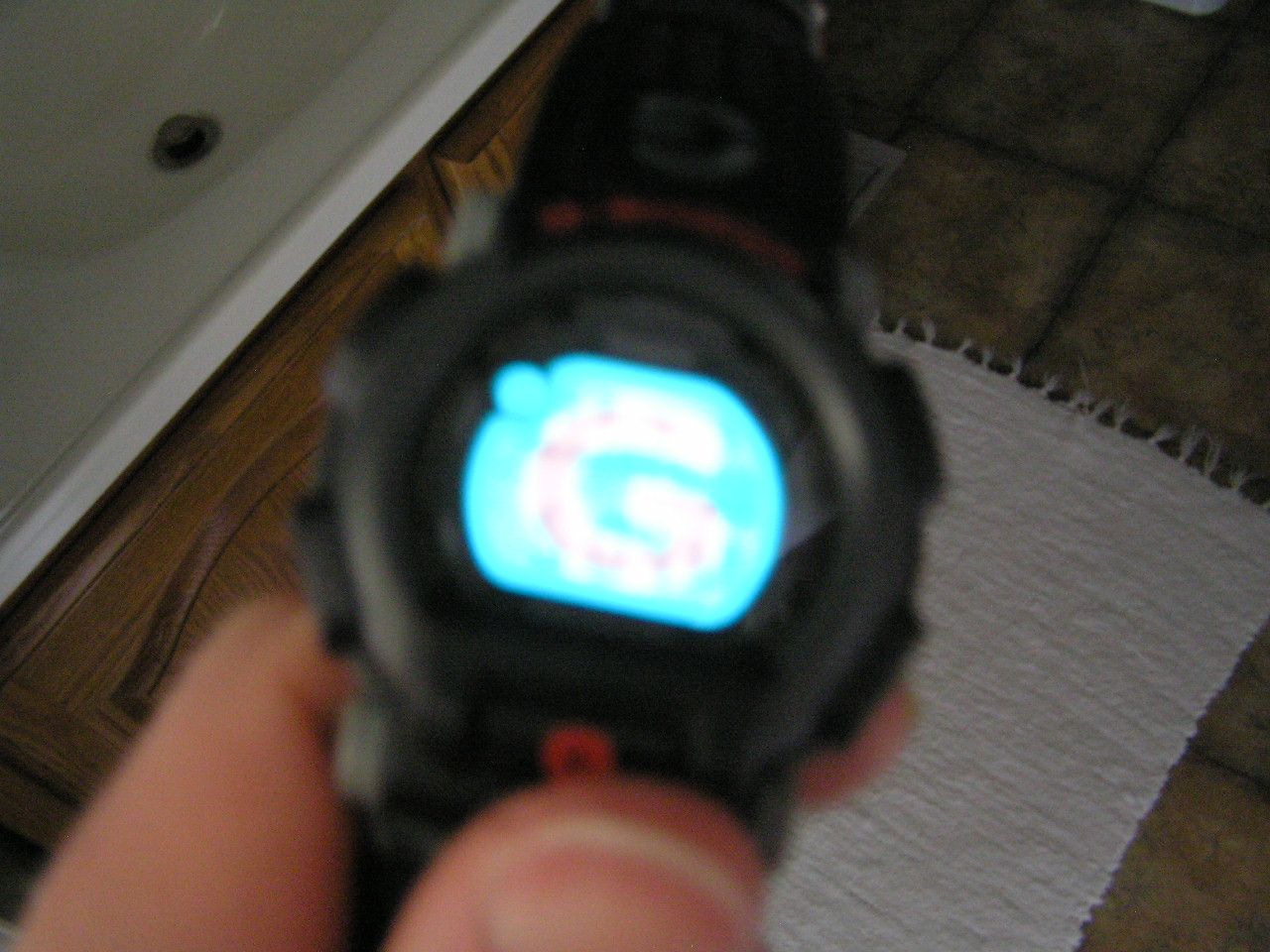

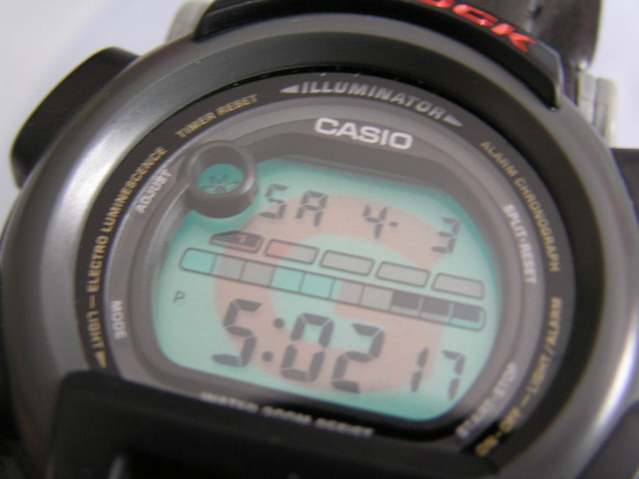

If the backlight is pressed, the display fades out. Time for a new battery:

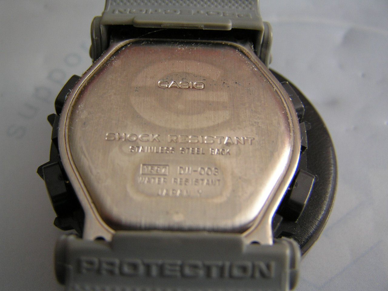

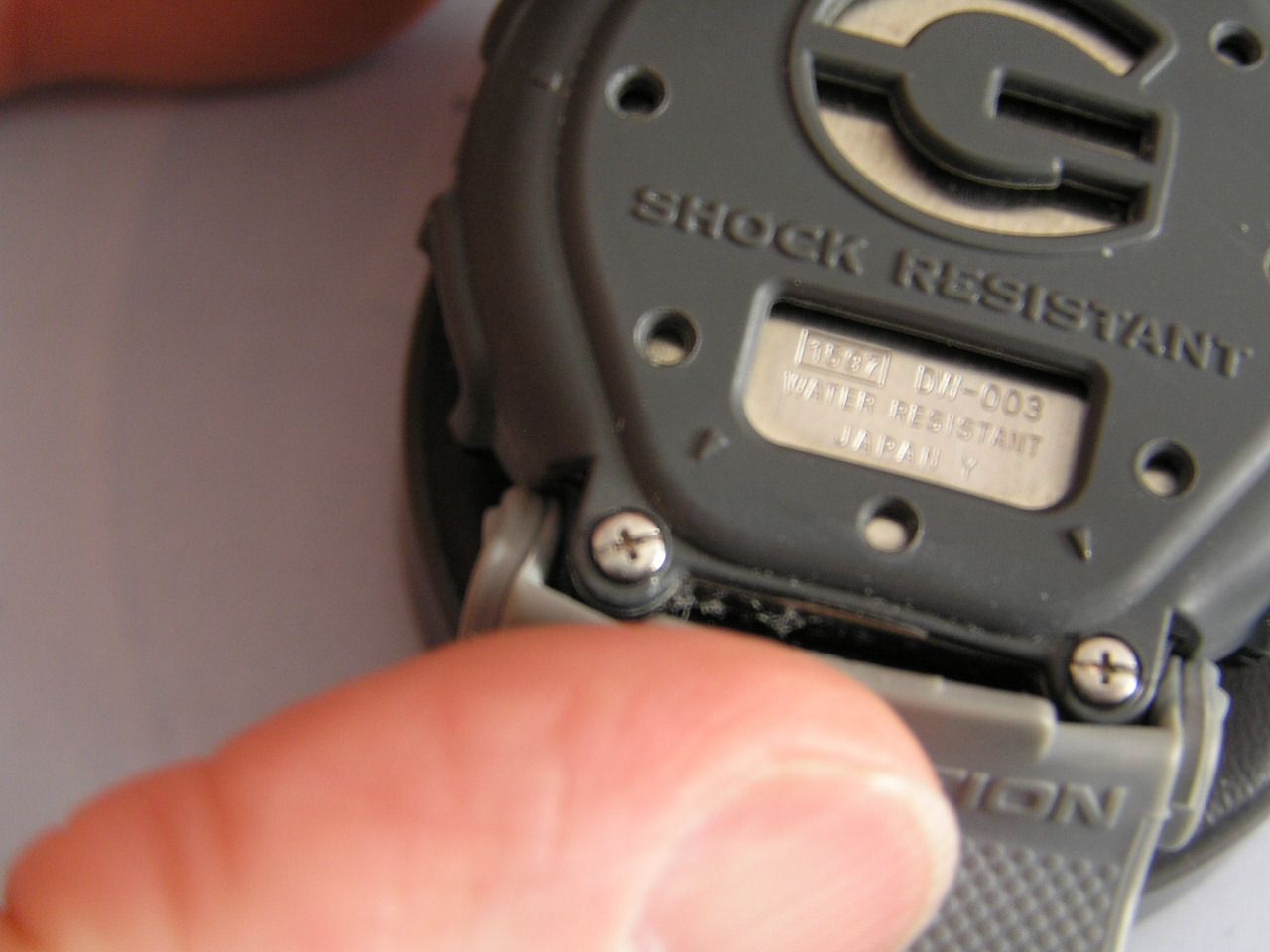

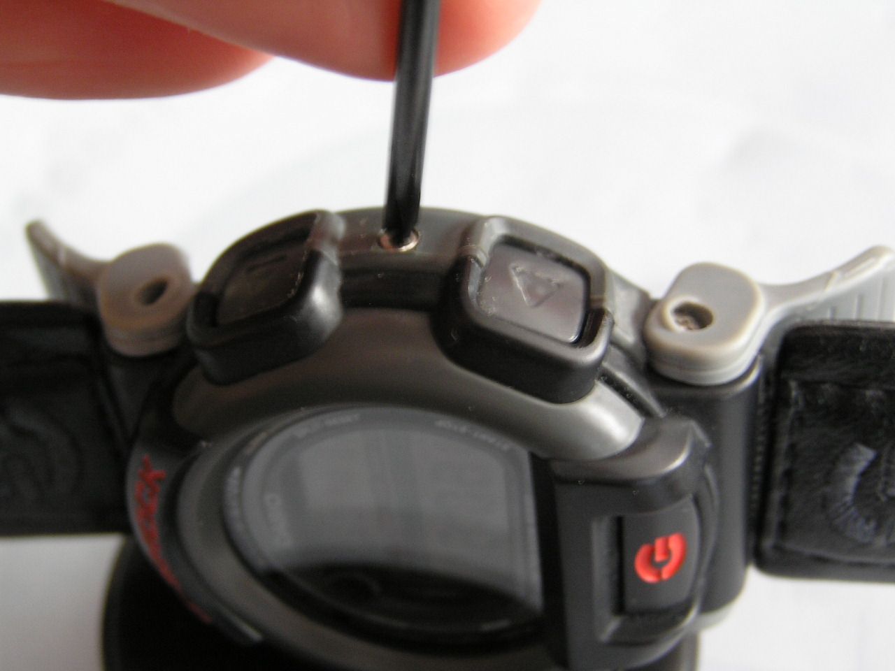

I was quite impressed with the build quality of the G-Shock. There are six screws holding the rubber shroud to the case back and sides.
Nice quality screws (with hefty shoulders for the case back):

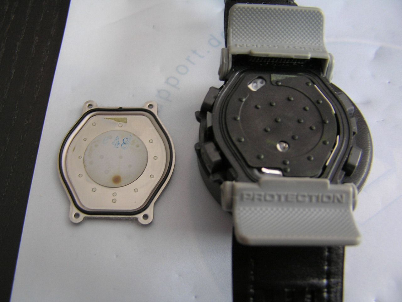

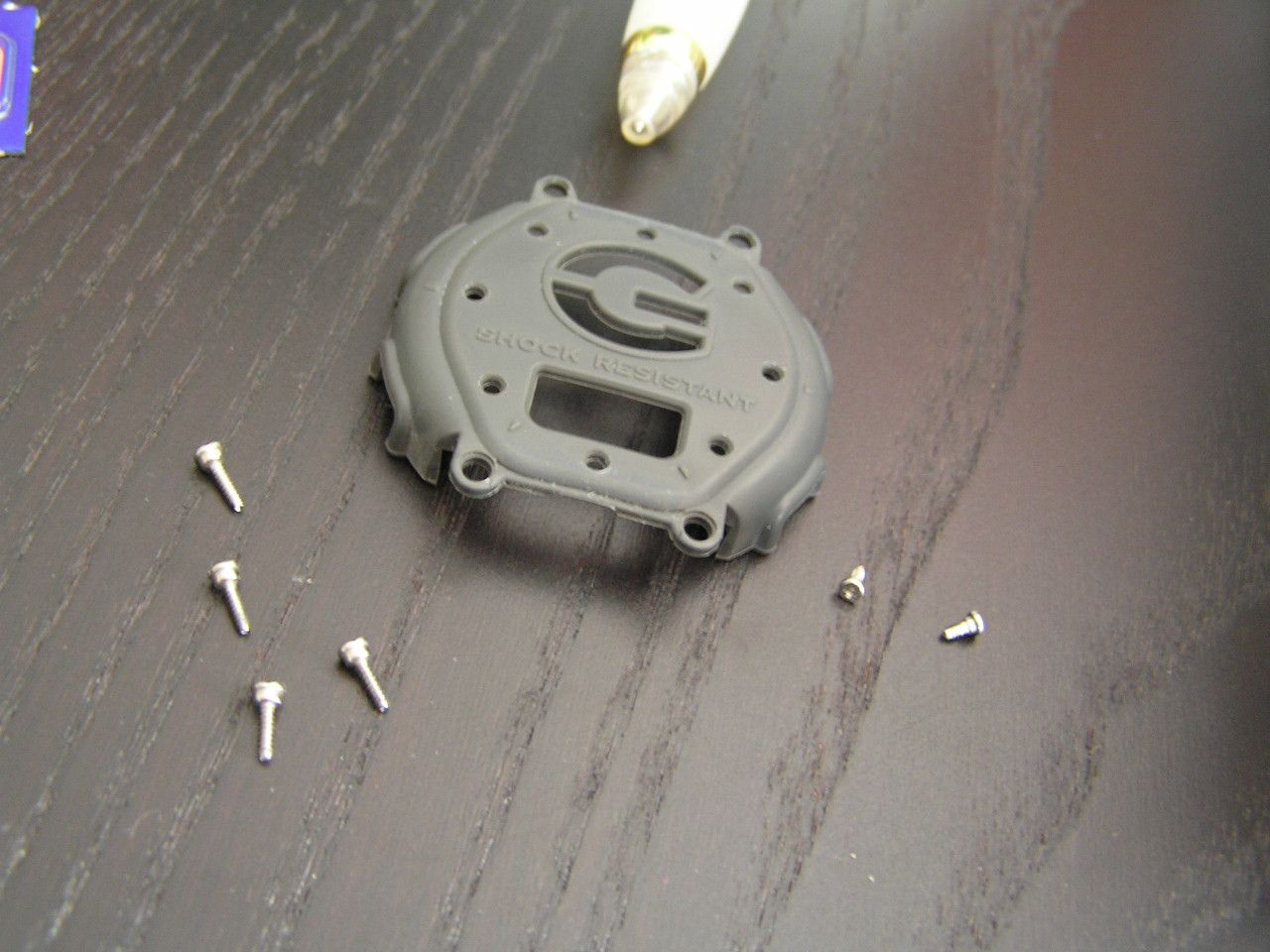

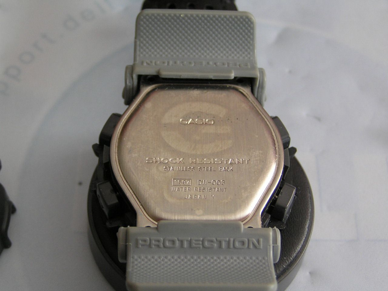

Once these six screws are removed, the shroud and case back can be removed. The case back was also a heavy piece. Nice!

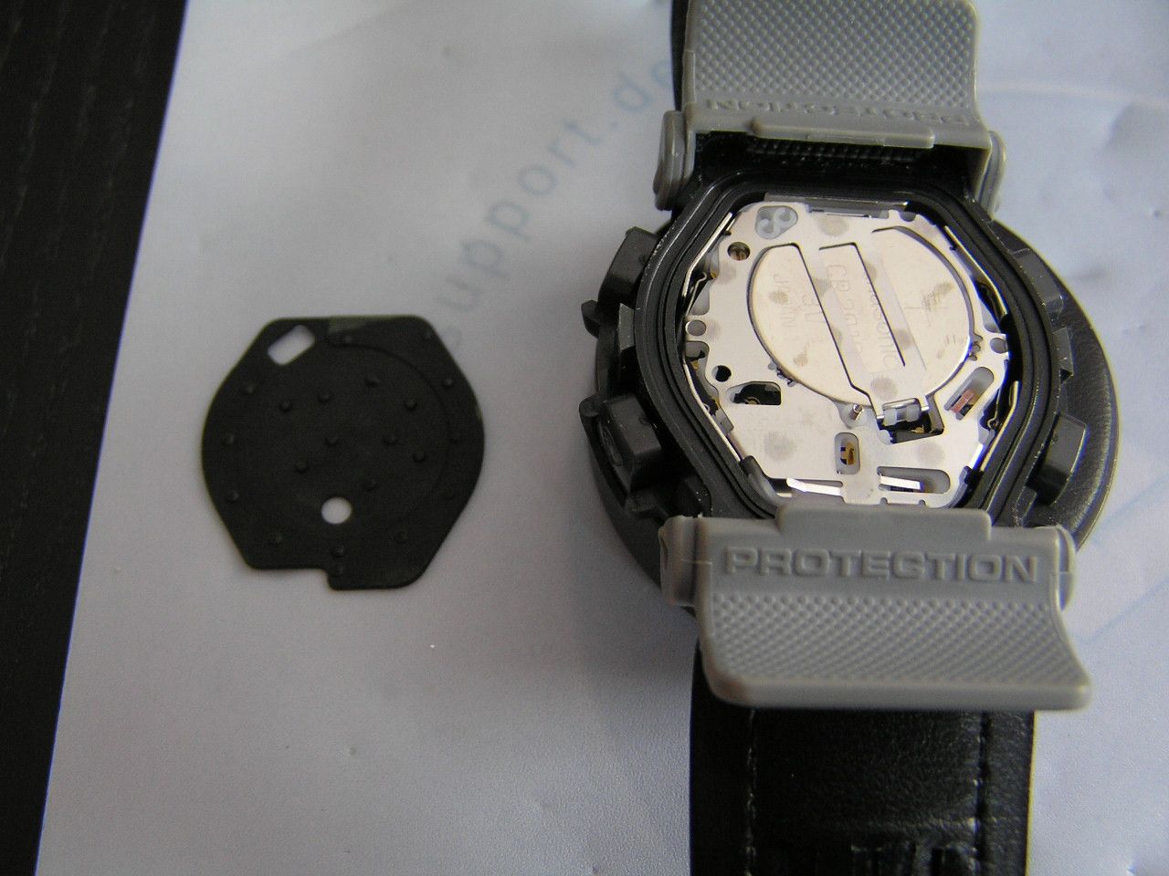

There is a rubber shock pad that covers the entire movement inside the watch, underneath the case back. Kinda like those plastic engine covers on many new cars.

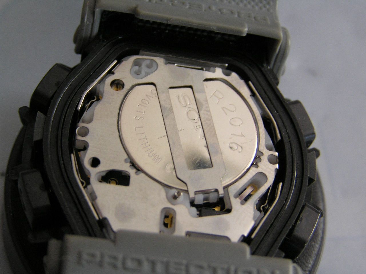

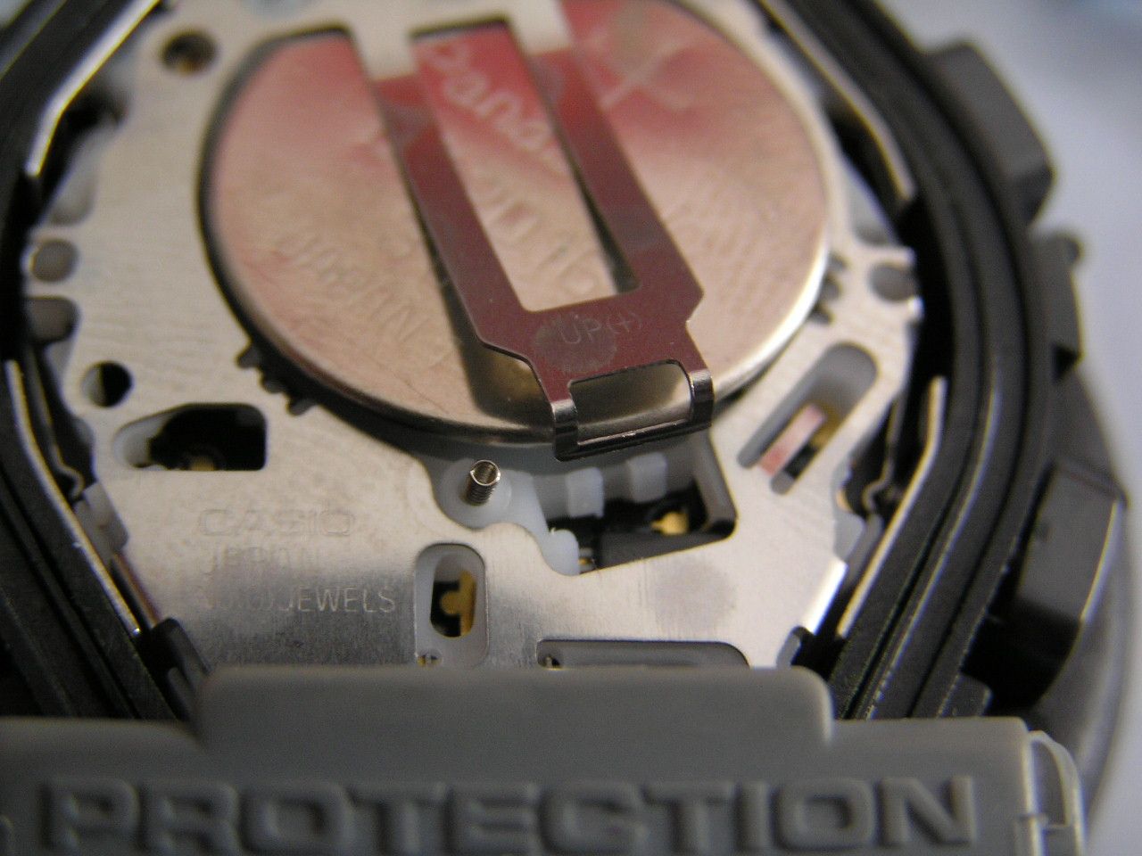

With the shock pad removed, the old battery and battery holder can be seen. The manual that came with this watch actually provides detailed instructions on how to replace the battery, something that is not seen very often these days.
It was a bit tricky figuring out how to safely release the battery holder, but with enough gentle prodding, I successfully unhooked the holder’s hook style release and the holder popped up just enough to slide the old battery out.
I’m always leery of working on digital watches because it seems that many times, no matter how careful I am, the pushers never seem the same after a battery replacement, due to the movement moving around while working on it. Luckily, things turned out okay here.

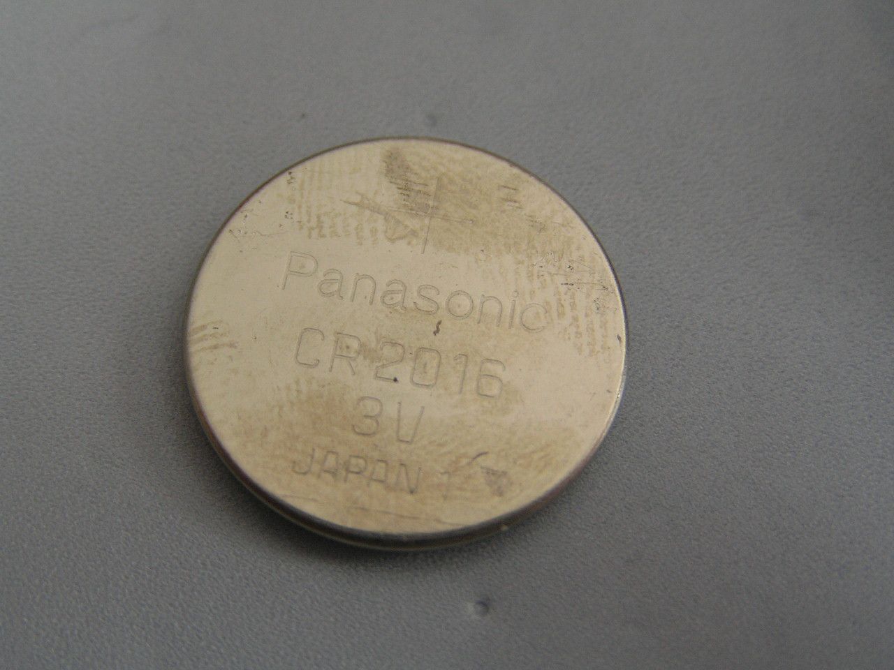

Here’s the old battery. Kudos to its 11 years of yeoman service!
New battery installed. How long will this Sony battery last? My guess is not 11 years! I also did not perform the ‘AC’ short procedure, because all was working fine after the new battery was installed.

Case back gets positioned and re-secured with the rubber shroud.
The display looks good. So does the backlight, now functioning properly!
