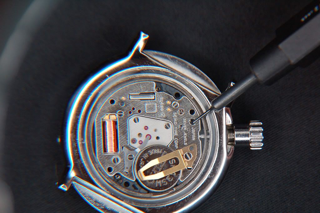

Thanks to the expert guidance of Michael (Twickersdude) I was able to easily remove the crown with a bracelet tool (This worked best, the smaller one I tried before did not release the button). With the crown unscrewed place the spring pin tool in the indicated hole and push the button and gently pull out the crown at the same time. Comes out like a champ. Thanks Michael. Can not be any easier when you know what you are doing.
