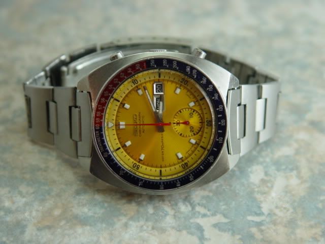

I've been collecting 6139-6xxx's for a good while now and their somewhat the foundation of my collection. It never has been easy to find them in good condition. Lately, it's even worse, their being frankened and butchered to death ( or life ) just to get them sold.
There's been a few how to buys lately for other models so I thought I'd see if I can make one for the 6139. A quick scan through ebay shows there's a need for something!

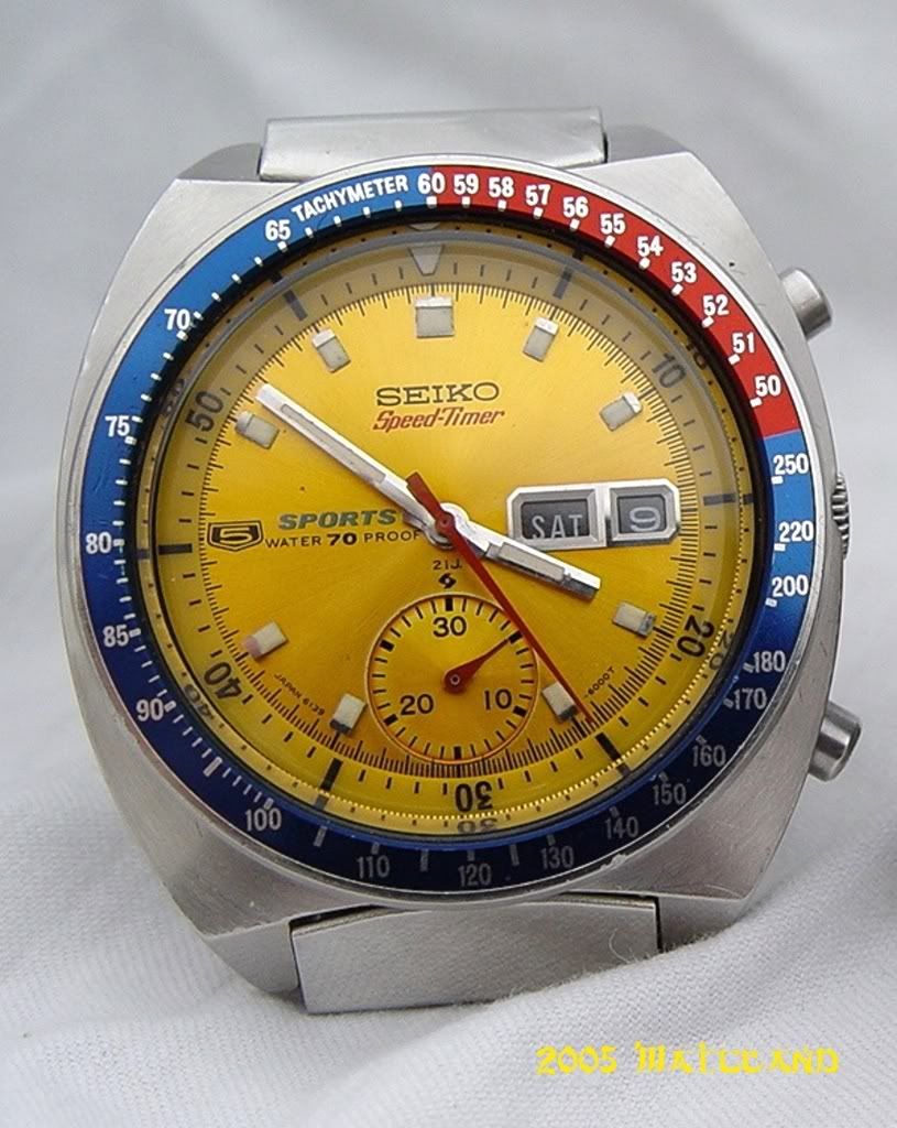

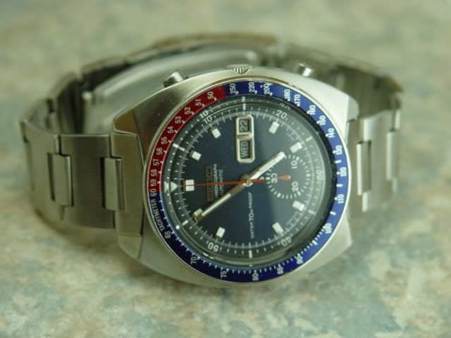

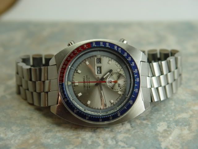

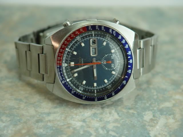

These are all original dials which came in several versions for the 6139-600x and 6139-603x's.
[IMG]
[IMG]
[IMG]

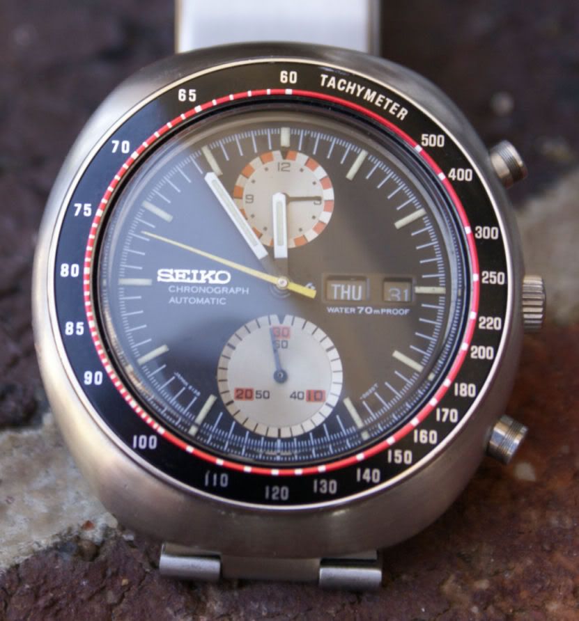

This is a prime example of what to not buy...... incorrect inner bezel, incorrect crown, incorrect hands and lots of mold on the indices.... a big sign of moisture entry.
[IMG]
So here we go.. signs to look for if you're buying a 6139-6xxxThe DIAL

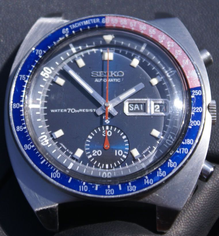

Lets start off with the various model numbers. 6139-600X models have basically four different possibilities that I'm aware of. 6139-6005 + 6139-6009 are USA models while 6139-6000 + 6139-6002 are non-USA models. They are all basically the same watch with a blue + red non rotating outer tachometer bezel and a yellow or black rotating inner bezel with 0 to 60 minute time increments. Any other color inner bezel other then the two mentioned have been faded by UV rays.
In order: 6139-6000, 6139-6002, and 6139-6005. {6139-6009 photo not my in database}
Case Variations
Next up is the case. There are two style of cases. The first is the early case with a notch cut out above the crown. This case was used in the first year of production which was 1969 through early 1970. Sometime in 1970 this notch was eliminated and through the end of production which I believe was 1978 all the cases are the same.
March 1970 notched case
1971 case without notch
Dials + Case backs

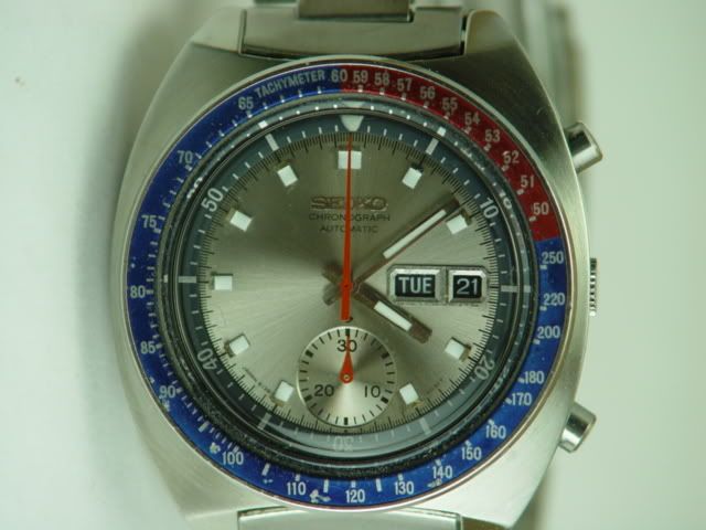

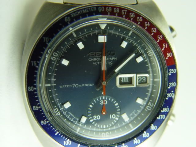

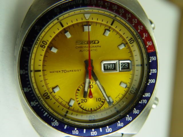

The most popular sunburst dials come in three different colors. Yellow, blue, and silver. I'm not sure the silver dial version was truly a Seiko option or a dial switched from another watch in the 6139 series as I have yet to see any 6139-600X silver dial versions in any Seiko Catalogs. If anyone is aware of a silver dial 6139-600X in a Seiko catalog please bring it to my attention. Out of the three different colors their are two if not three different variations of each color. I have yet to see a silver "proof" dial although I believe one exists. The early dial used in the first year of production reads Water70mProof centered on the left side of the dial at the 9 o'clock position. These watches also read water proof on the case back. From what I can tell the "Proof" watches were in production until February 1970 according to the watch in the photo below. In March of 1970 the script changed to read Water70mResist along with the case back according to two of the watches in my collection. The last dial had no script at all in the 9 o'clock position of the dial but water resistant remained on the case back. I'm not sure of the exact date this dial went into production but I believe it was in late 1972 or early 1973.
Proof dial from 1970
Resist dial from 1971
Plain dial from 1973

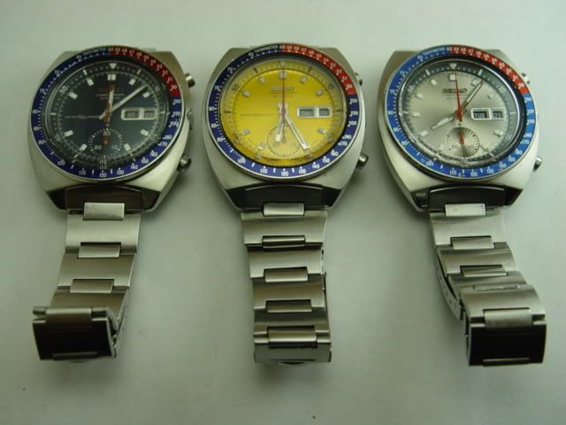

Bracelets
The 6139-600x series of watches had three different styles of bracelets. The straight oyster, the tapered oyster, or the stelux president style. From what I can gather the straight oyster was used from 1969 up until about 1975 at which time they redesigned it to taper out where it meets the lugs of the watch case. The tapered oyster bracelet was used from 1975 until the end of production. I don't have any dates concerning the stelux president style bracelet.
Straight and tapered oyster side by side.
Stelux president style.
Straight oyster.
Tapered oyster

Re: HOW TO BUY A SEIKO 6139-600x CHRONOGRAPH - A Collector's Buying Guide
Authored by Swedefreak
Not to roil the waters as this is an excellent post for the most part, but a couple of points---
The bracelet referred to as an "oyster" is not. It is an "H" pattern link which is quite different, made by Stelux (as were all Seiko bracelets) and used by Seiko on at least a couple dozen models in the 1970s. Some of the other versions have somewhat shorter "H" links and will not interchange.
As an aside, Stelux made this bracelet in identical dimensions and proportions for several other watch manufactures.
Also, Stelux made three distinct versions of the "H". The one for non-Western Hemisphere sale was a bit more robust, had a different buckle pattern and buckle cap. These were signed by Stelux on one folding member of the buckle. The "H" link more familiar to we in North and South America is a bit thinner and the buckle fold is not signed, only the cap. On post-1974 6139s this one sprouted the flared ends.
The other bracelet is neither a "president" nor a "fishbone" but something between. Also for non Western sales, this is found on many 6139-600Xs that came back with our military personnel who served in the Far East, and is signed by Stelux on the fold.
The silver-dialed variant is 6139-6013 and, I believe some 6139-6032s.

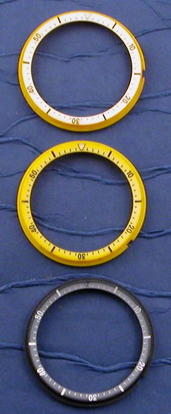

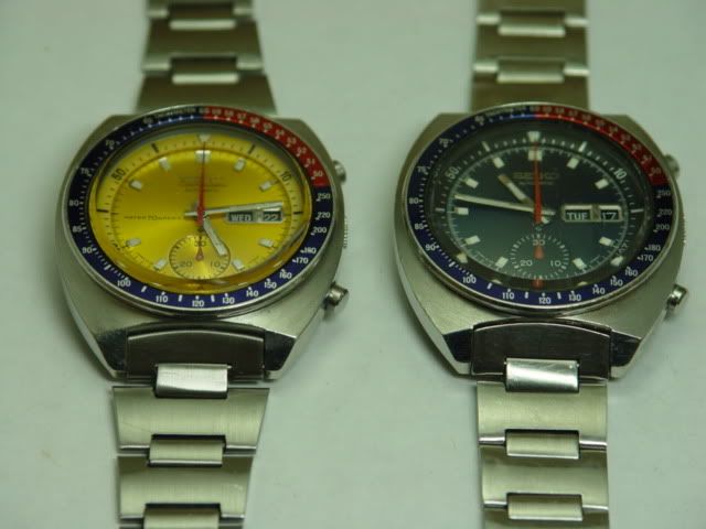

What is commonly referred to as an "inner (rotating) bezel" is called by Seiko an indicator ring. These actually came in four colors:
White-from the very earliest versions and why these watches are called "pepsi": red, white and blue
Yellow-matches the yellow dial
Midnight Blue-matches the blue dial
Black-found in later versions, see below
The white are very hard to come by and are most definitely not faded nor do these discolor with age or UV. They were originally used with both yellow and blue dials. The white is a layer of paint on a yellow indicator with a black numeric imprint.
The yellow (and blue) were introduced, most likely, to better harmonize with the dials. These have black numerals imprinted directly on the yellow plastic. These fade to a greyish pale yellow but not to white, ever.
The blue (as the yellow) compliments the dial and its silver numerals are, again, imprinted directly on the blue plastic. These will fade to a light grey, never white, and are far more prone to this degradation than the yellow.
The black are the solution to the blue's issues. Again, a silver imprint on black plastic that does not fade.
White, yellow and faded blue 6139-600X indicators:
