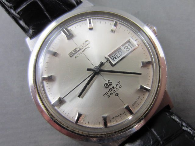

This the watch in question. Just a couple of quick and dirty shots I took at work today. Sad though this sounds, I actually wore it all weekend, even though not running. Thrilled to have added my first Grand Seiko to the collection.
Now the question is whether to polish the case or leave well enough alone.

Clean only, please do not polish! It can never be "un-polished", nor finished *exactly* the same way that Seiko did it 40 years ago. You'd be destroying a historical account of their abilities at that time, on a rare peice.
Hi Noah
Yes that's pretty much what I was thinking. Generally with any of my vintage pieces I try to do the minimum amount of re-finishing. With this one I think just a good ultra-sonic clean and a fresh crystal and case back gasket will do the job. Maybe down the road a bit a steel GS buckle would be a nice addition.

Agreed !
