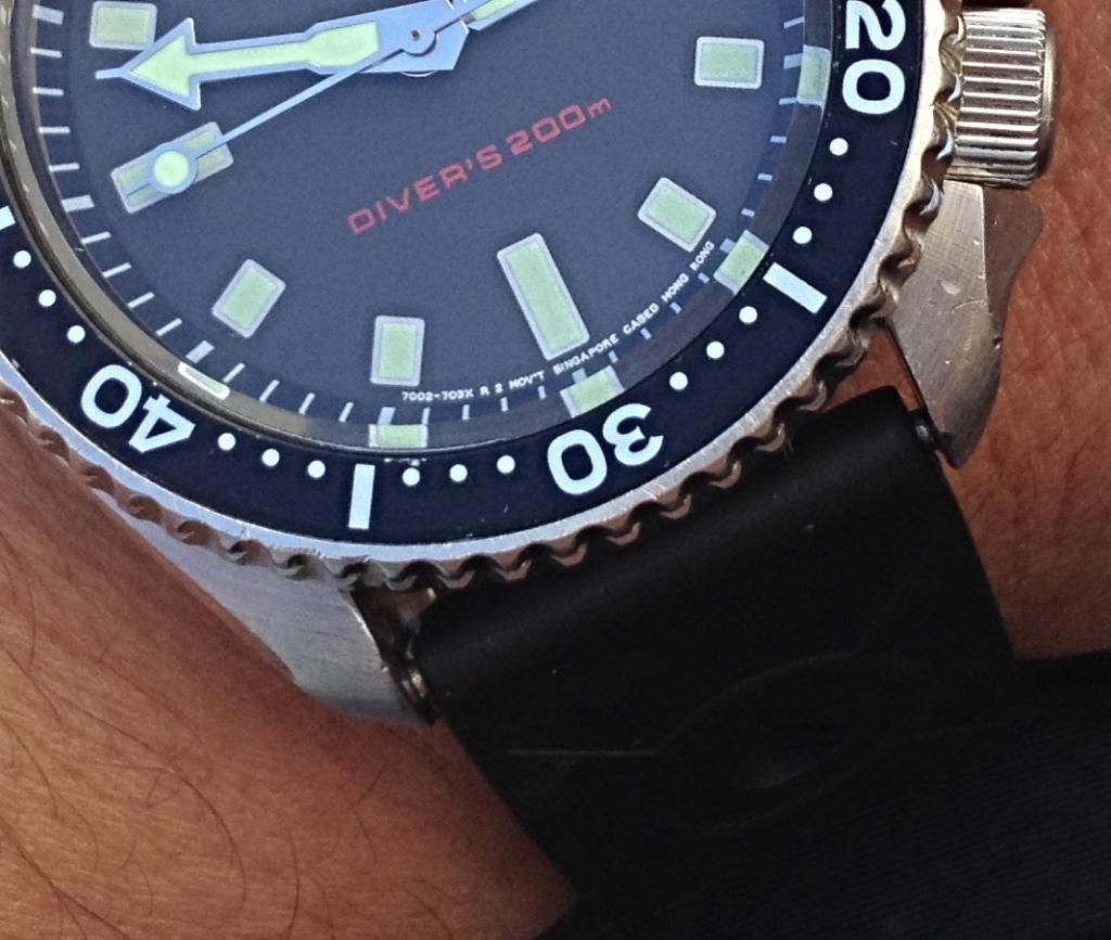

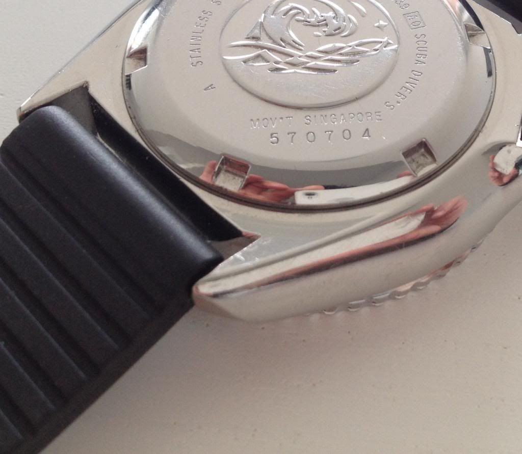

I had the same issue when I bought the BC, I liked the strap but I realized that Seiko fat springbars would not fit easily, I applied some silicon grease and went smooth in but as you can see in the first photo then there was this terrible gap!
so I applied some force with my fingers and tried to pull the rubber outwards, looks much better now.
