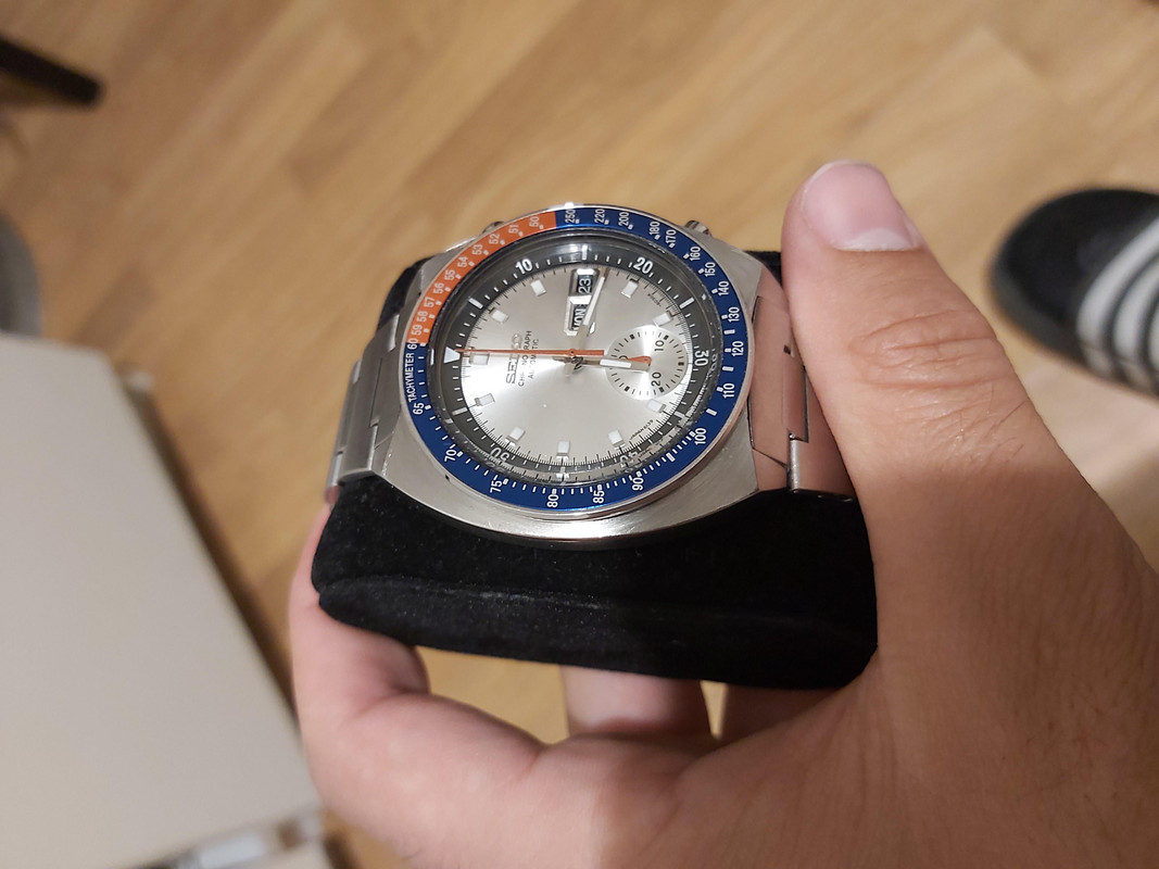

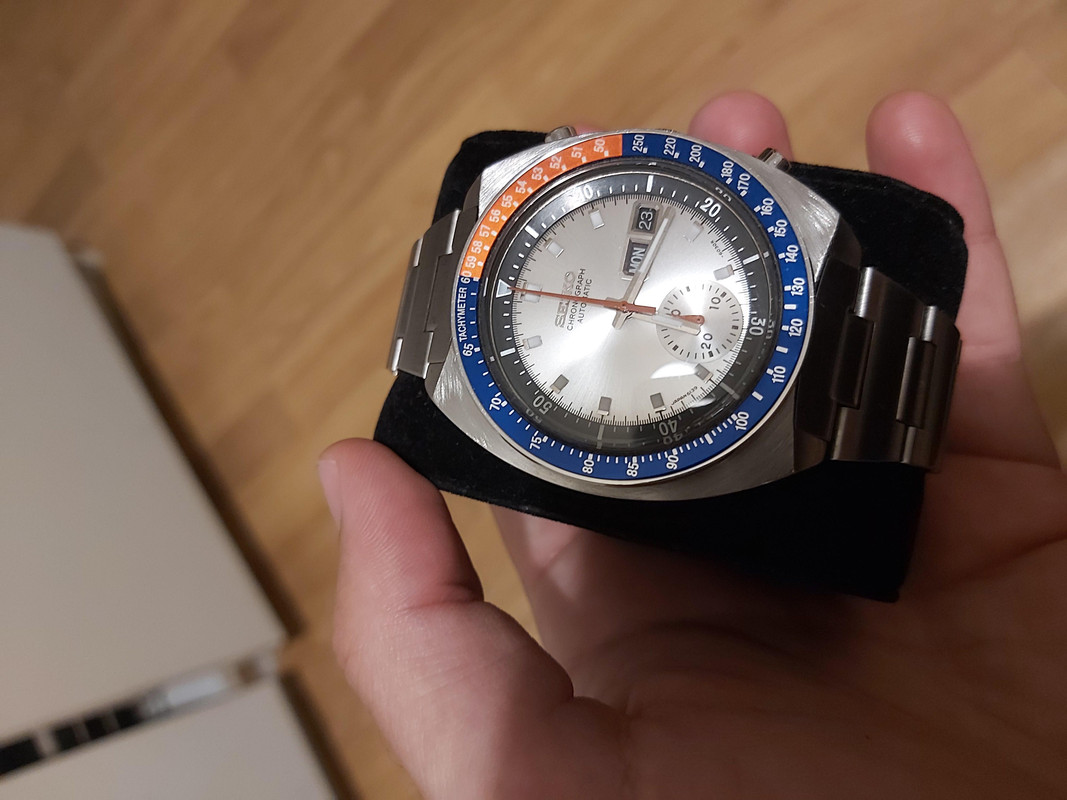

Hei guys, hope im not hijckaing the thread but taking the lead from a previous poster, I've recently been 'offered' this for sale, but not being knowledgeable on 6139 'Pogues', I figured I'de confirm with the more knowlegeable people around here.
This is advertised as an all original 1976 silver pogue, however from my past research, i'm having a hard time believing so. I think the dial and bezel insert are AM (sellers photos):

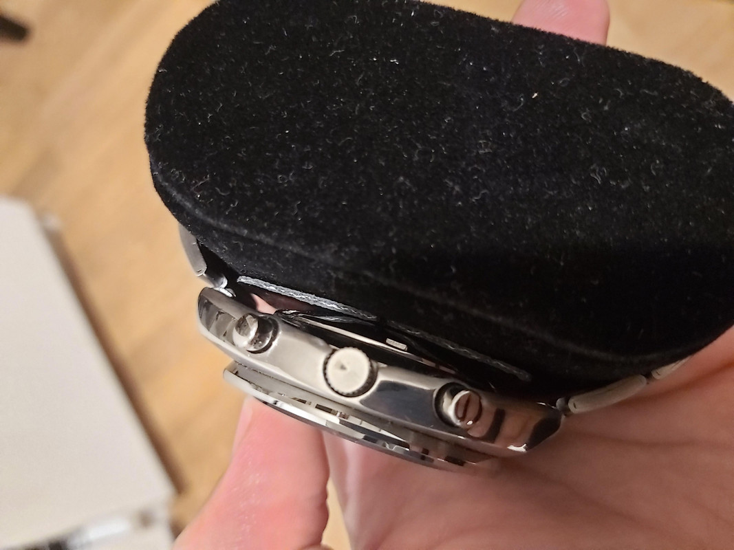

And clearly the sides have been way to polished?
Any help would be appreciated!
Thanks in advance.
Lou

Definitely an AM dial, and a pretty ballsy one too. If you look at the markers on the subdial, they’re meant to extend all the way the the beveled edge. The markers on the example you posted come nowhere close to touching the edge

Yes, that is indeed a VERY AM dial. I would run, not walk away from this one. AM dials are fine if you don’t mind originality, and the price reflects it, but if this is being marketed as original the seller is being dishonest.

Thanks for clearing that up guys!
I was under the impression that it was so, despite my limited knowledge on these.
However, since there were fewer of the typical hallmarks of AM dials present — besides the gap in the sub dial, the applied logo seemed almost correct (given the angle of photo) but the subtext looked off, the JAPAN font looked okish too —, doubt was instilled. ;)
Lou

You had good instincts Lou. Sometimes its just a feeling, like a disturbance in the force... But in general, for me, I don’t go for it when it’s this “pretty” unless I know the seller well. You were correct too about it’s origin.
