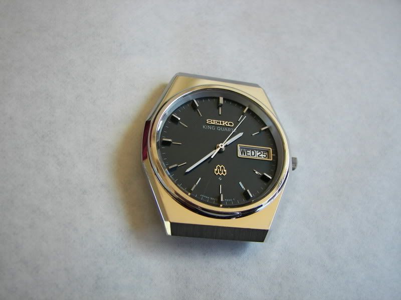

Hi , can somebody tell me what is best for keeping a crown screwed onto a stem ?
Would super glue work ?
The crown comes off the stem when I try to adjust the time.

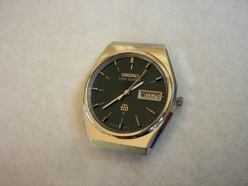

Here's the offending watch -
King Quartz (twin crystal) 9923-7000
best regards Scott.

Assuming its a threaded screw on crown, I always use a very small amount of threadlock just to keep it in place. You only need a tiny tiny amount.

Thanks Technoman ,
Yes it's definitely a screw on crown .
I'll try some loctite on it , don't know why I didn't think of that , I use it quite often .
