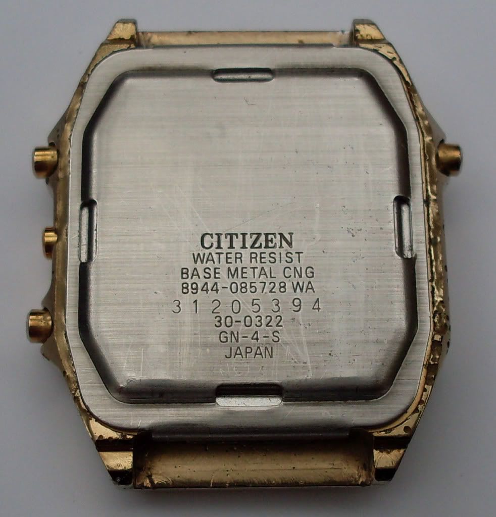

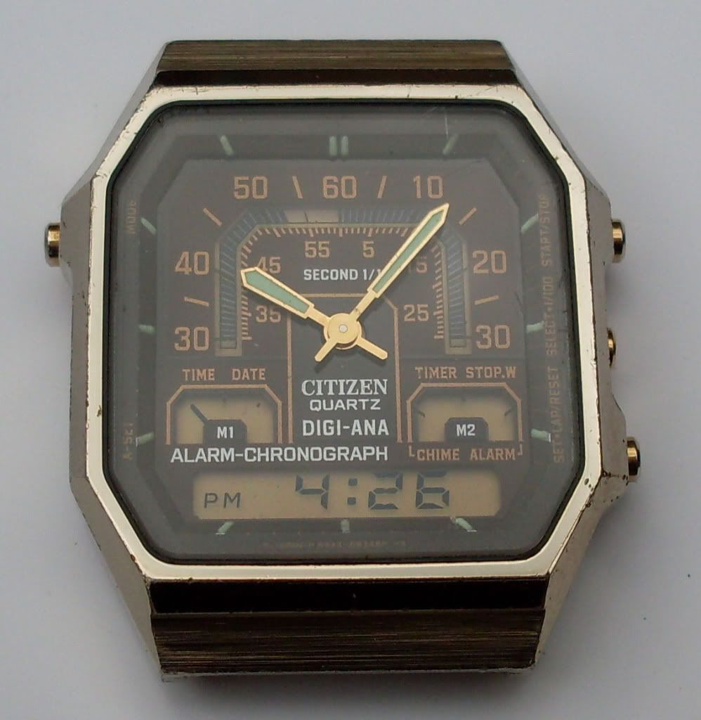

Picked this up today and cleaned it up a little and a new battery and it seems to be running but the hour and min hand just spin round continues and i have pressed every combination of the buttons i can (I think) and they are still spinning, is it a fault or setting ? thanks.

Well i give up i need expert Citizen advice, i have spent a unholy amount of time on this nice little citizen today as it is of [glow=red,2,300]GREAT[/glow] sentimental value but still i can't stop the H/M hands from flying round at speed, hour hand goes round about a full turn every one min, all other functions working fine and setting fine, quite a nice watch really, any one got any ideas ?? :'(

It would seem that the Analogue Set button 'A' (recessed at the 8 o'clock position) is stuck in the 'pressed in' condition. This button adjusts the analogue hands -- pressing it for more than 1 second causes the hands to move round quickly. When you're near the desired position, further quick presses on button 'A' advances the hands by 20 seconds per push.
I'd hazard a conjecture that it's years of grime around that button that's causing it to stick. Remove the movement from the case to clean around the button, and also to check out the switch spring mechanism. Good luck!

Thanks Les that was one of my thoughts but it is spotless in that area and the spring is springing like a goodun !!! really :'( frustrating ;)

Your cal. No 8944...Very interesting model.
