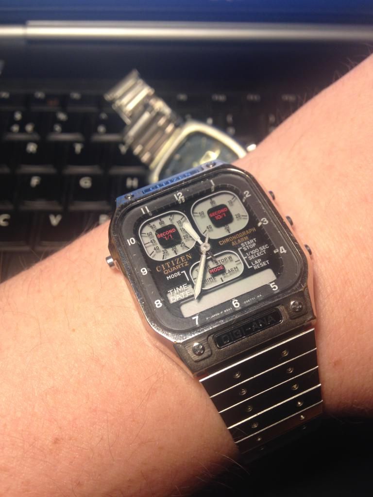

I have the Citizen DIGI-Ana since the early eighties. I wear it everyday to work and is still working fine until last week. I noticed the analog started getting slow if I am not wearing it on my wrist. The digital is accurate. If I leave it on the desk the analog will lose about 8 minutes after 45 minutes and an hour 30 minutes after 6 hours. The room temperature is 65F/19C. If I wear on the wrist overnight in bed, the analog runs fine without losing any minutes. I replace with a new battery and is still the same. So I am not sure what’s wrong with my watch. May be our members have some insight on this problem. Thanks!

As said, that's a fairly classic sign of lubricants drying. hen you wear it the warmth of your wrist helps to keep them liquid but when they cool down (after you take it off) they turn more like treacle.
It's not a good idea to put new oil in without cleaning first because any particles in there (including any dried oil) will tend to form a grindig paste with the fresh oil and cause wear.
I've never had a chance to strip one of these down but it should be a pretty straightforward movement given its age and very basic functions (as far as the analogue is concerned). But it's probably not one for the complete novice because (a) quartz trains tend to be on the small side and (b) you'll need to remove all the LCD parts in order to do it properly.
