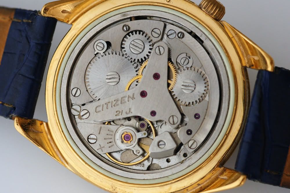

Axel's info is great :) The only thing I'd add is how the alarm works - there's a small hammer mounted on the movement which strikes a pin on the inside of the case back. The hammer is the beveled kinda triangular piece held by a central screw slightly overlapping the balance wheel in this pic (3102 movement):
