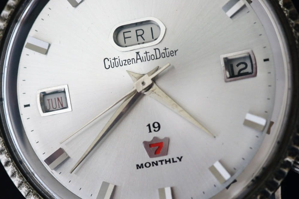

This pic shows the usual '7' logo on a 4121 ('Monthly') version of the 4100 series:
