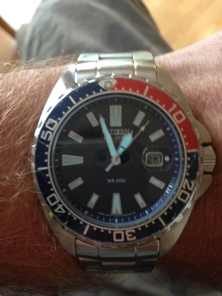

It is of course a matter of tastes. Same thing happens on The Rolex Forum: some guys remove the cyclops on their watches. First they use solvents, then pry the cyclops off with a jewelers hammer and a fine screwdriver and then clean the sapphire with some more solvent. But the crystal on the BM0561 is mineral.
For myself, I would never touch the cyclops on any of my Rolexs, but then again, if you like your watch without it, then you should try to improve it.
Of course, the resell price of the watch will diminish.

To remove the cyclops take the crystal out and soak in acetone for 24 hours and it should come off. I tried using heat (oven gas mark 9) but this did not work neither did a big hammer and chisel. Just split the cyclops in half:93:
The above based on the Stardate MK2.
Cant you find a generic crystal to fit?

If you leave that crystal in acetone for a whole day, maybe you will find that some real magic has happened: your crystal has dissapeared!

Depending on the bonding agent - you could try putting an electric soldering iron on the magnifier to loosen the glue. If you break it, don't blame me.
