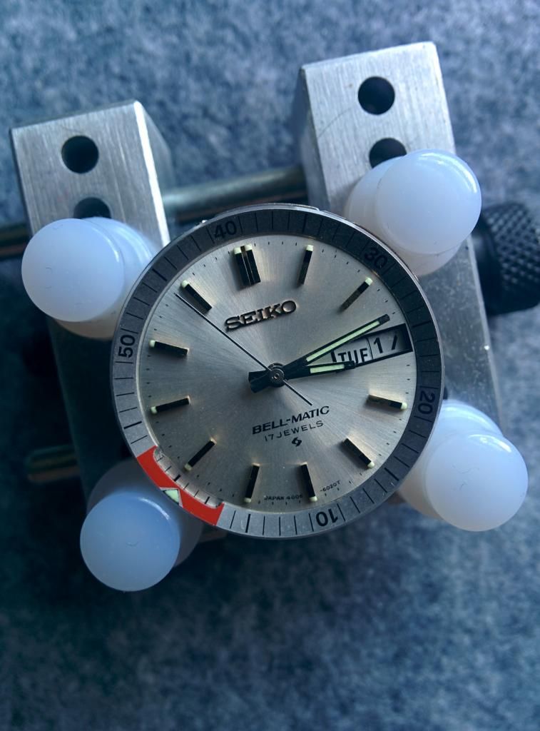

Dial photo:
The day wheel needs some help...

It still looks good!
Dial photo:
:great:

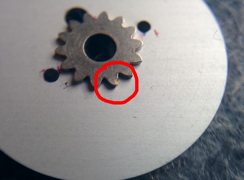

Actually, I'm wondering if this is the problem...
well looks like a great watch...that last pic might give you a few problems...welcome to the forums..John
Thanks!
Luckily, I was able to source a NOS day disc wheel from Stefan, so I'm waiting on that now. Hopefully, that'll resolve any issue with the day wheel.

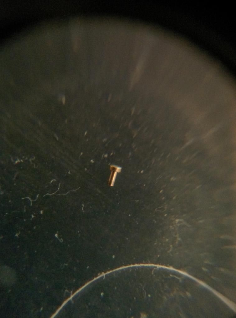

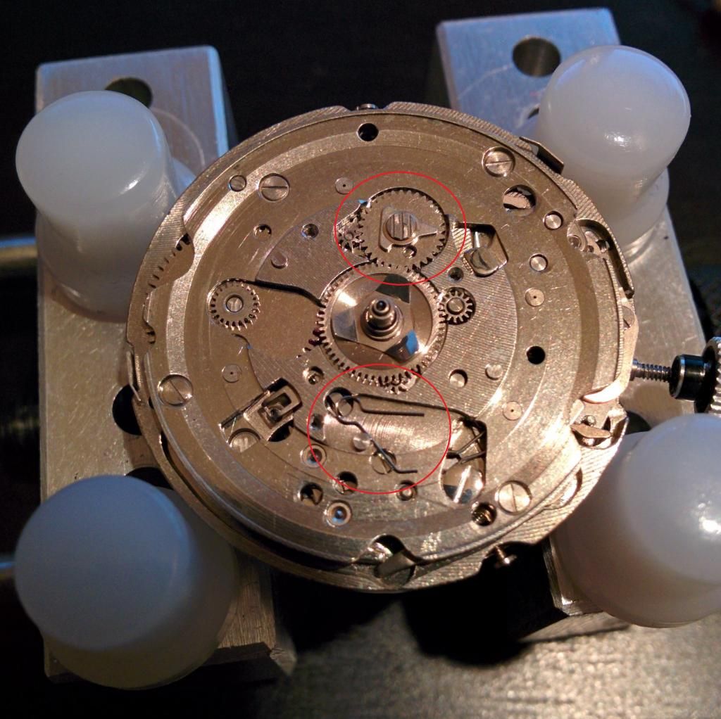

...Aaaand unfortunately, I think I'm in over my head. I was able to place the new day disc wheel, but when testing it out, I noticed that the day wheel wouldn't move at all after a date change. So looked a little closer and found that the day and date driving wheel is missing the little bit that sticks up. I don't even know how the date was changing, to be honest. When I investigated further, the date jumper is missing, but the date jumper spring is present. It doesn't make any sense at all.
How was the date even changing?
I think I'm throwing in the towel and starting the hunt for a donor movement.
Well, the date change question has been answered and then some good news and bad news...
I decided to reassemble the watch and wear it without the day and date working. I went picked up the date wheel and, surprise!, the date jumper was stuck to the bottom. Huzzah! Maybe I could get the date wheel working, if not the day! And then in my inexperience putting the date jumper back in place, I launched the date jumper spring. Sad trombone...
So I continued along my new plan of reassembling the watch as it is. Fitted the new crystal and finished reassembling. The alarm rings, the watch ticks...all is kind of okay. Hard to say if it's keeping time, but I'll see tomorrow.
The hands are terribly difficult to set for some reason. I'll need to figure that out, if I decide to go on with this movement. As I was cleaning up the screwdrivers, I found the bit that stands up to push the day driving wheel. Incredible! I don't know how that fits, so that is a challenge for another day. And I need a new date jumper spring.
But it looks nice. I guess that's small consolation for what I'm considering a partial failure.
Ok, I can get the date jumper spring of the bay.
EDIT: I guess that's not the date finger. Whatever the part I found is called, maybe I can get that back in place.
This might yet be salvageable.
This has not been the best few days of watch tinkering for me, but I did find this went I went to put another movement into the holder.
What are the chances of that?
Quite by accident, I've now found both parts that I had seemingly lost from this project.
