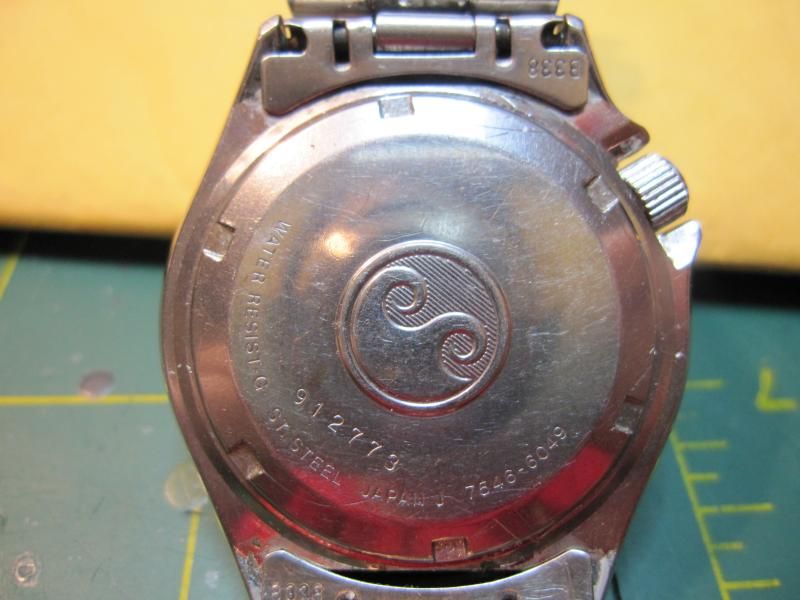

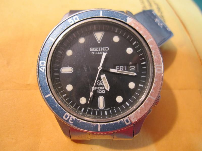

I picked up a 7546-6049 Sports 100 diver about a year ago. Mostly because I liked the fact that it was a quartz model and not as common as the mechanical auto winders. I have tracked everything I need to do a full restoration on this watch mostly by scavenging parts watches but I am dead stuck on one part. The watch has a rotating diver dial with the original Pepsi bezel insert and the insert for this model apparently does not cross reference to any other model I can locate. The insert has an outside diameter of 36.75 mm and a inside diameter of 32.05. I guess if all else fails I will have to mask and repaint the original which is quite a time consuming process. Here she is.

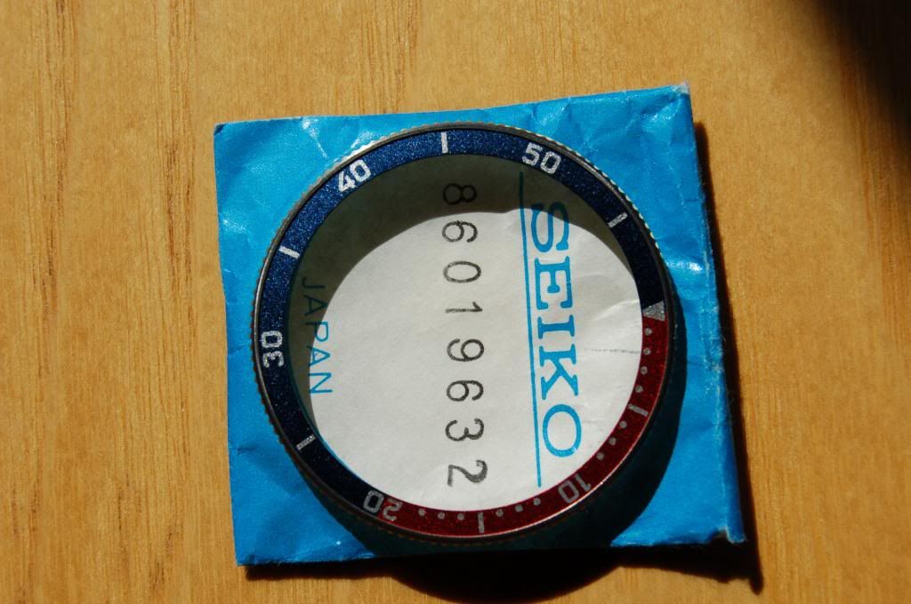

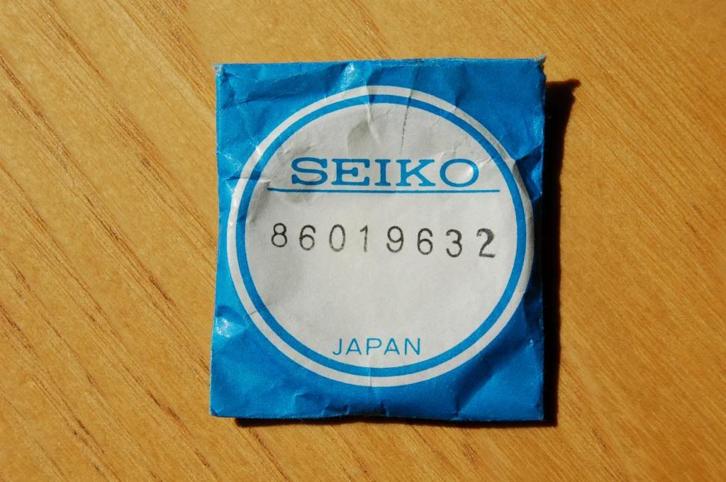

Hi. I have one. The part for the bezel/insert is 86019632. It is a complete unit you can not get the insert separately. Very difficult to find now.

She is a beauty there bubblehead. So the bezel and insert are all one piece. Well I guess I am just going to have to take the time and spend many hours masking and repainting mine. I always thought they were attractive watches. Glad to see a couple other people think so too.

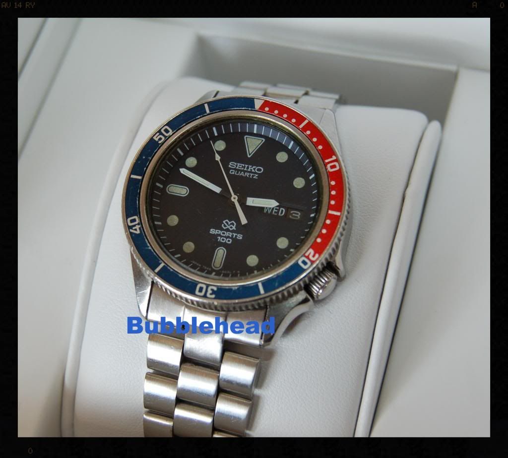

Hi Michael, you may consider dropping the whole 7546 movement, dial and hands into a 6309 729x case as it is a direct fit. This way you can retain the originality of the watch in a very serviceable case which is easy to get parts for such as gaskets bezel inserts etc. Just a thought. Regards. Kev
