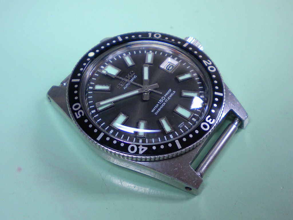

I had to schedule this one into my work queue to get done as I never seem to have the time to work on my own watches these days. Having a buyer for it helped focus my resolve though :)
This has been in my drawer for a few months along with a couple more project 62mas's. To get it back to tip top order in addition to the service it's needed a relume from James Hyman, a new date wheel, a replacement pallet fork, a NOS clutch and date corrector, a NOS balance, a NOS crown and stem, a NOS crystal and a replacement insert.
I had the relume done a few weeks ago, I also cleaned the case components and fitted the insert and new crystal at the same time.

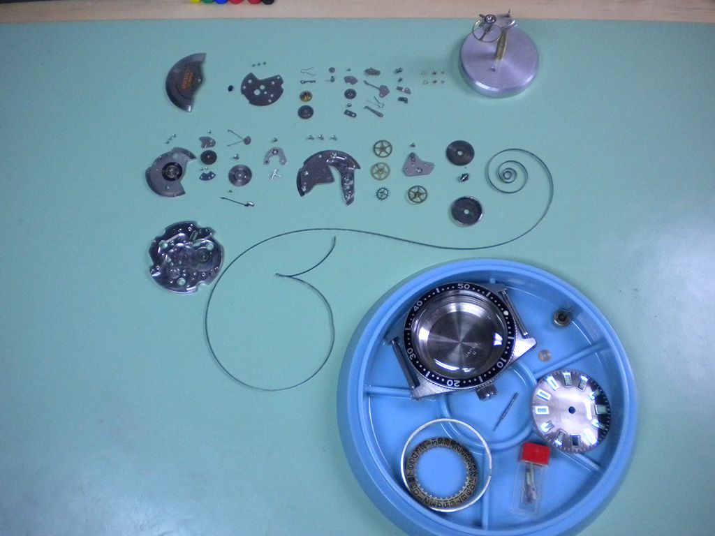

Todays job was to get it finished so the movement was stripped, you can see the original filthy datewheel in the container

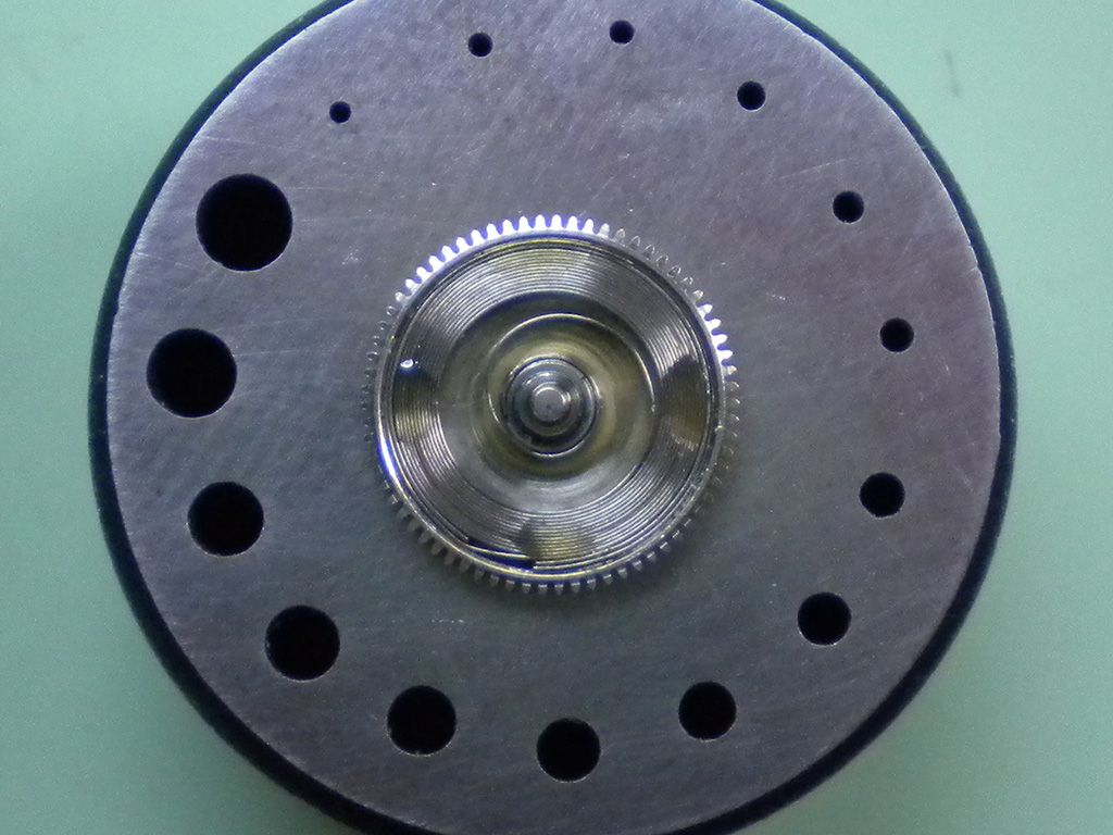

After cleaning all the parts were inspected and the reassembly began, here the mainspring's cleaned lubed and ready for closing

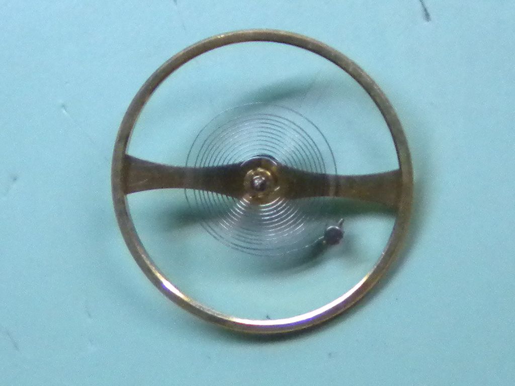

The balances hairspring was toast, not only was it bent in multiple places where it joined the stud, it was bent in the vertical plane too. I was just going to swap the hairspring for a good spare but when I went to remove it the balance staff was actually loose in the balance. I could probably have restaked it and replaced the hairspring (which I plan to do anyway) but as time was pressing I fitted a NOS balance assembly.

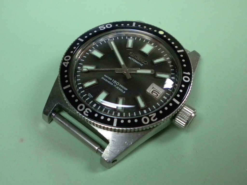

The dial and hands refitted. Another irritant was that the seconds hand was a loose fit on the pinion which meant it just dropped on top of the minute hand and stayed there! I had to reduce the pipe diameter on the hand to get a nice firm fit, it just shows that using donor hands from a different watch does have its drawbacks sometimes.
The movement recased
A horseshoe caseback on this 1967 example

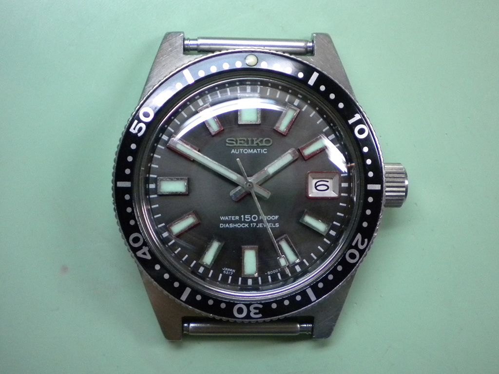

And she's all done
I shall be wearing this over the weekend to check on the timekeeping and fine tune it if needed. I'm also tempted to give it a pressure test as the o-ring in the NOS crown was still pliable, but the jury's out on that decision at the moment!

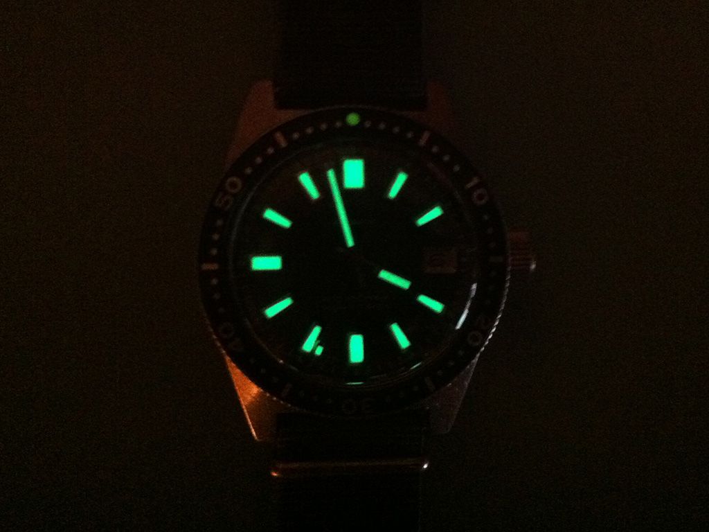

Looks really good Duncan, Lume shot ?, I must get mine finished soon, my dial is with James at the moment and i've gathered quite a few NOS movement parts to use whether required or not plus the movement has become a little special now has I got it in a trade with Ron/rehunk who passed away recently.
I'm not too good with lume shots but here you go John! I didn't realise Ron had died recently. RIP Rehunk, comes to us all eventually.

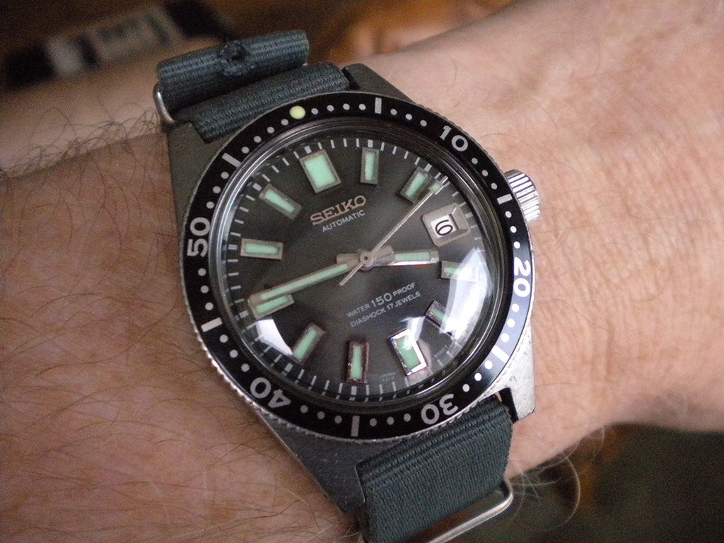

Thanks D, here's the wristshot
Beautiful :cool: Is it me or is the lume a bit greenish ? Probably the lighting.... Again, Just Fantastic.

Thats a good picture Duncan but................if you have an iphone then you will find lume shots with them are a doddle :)

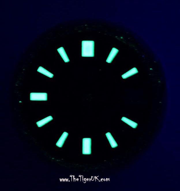

My dial is now on its way back from James :)
Picture is from James.
