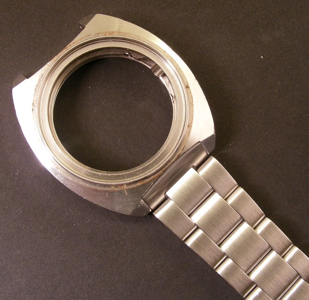

In replying to one of my very best customer's e-mails today, I came up with a slick solution for those of you who want to use a "super oyster" or some other bracelet with 9mm center links on their 6139-600X.
I must confess I'm a bit reluctant to share this based on taking nearly a year to get my repro of the Z002S to its state of near perfection. But then, again, this is too good not to pass along.

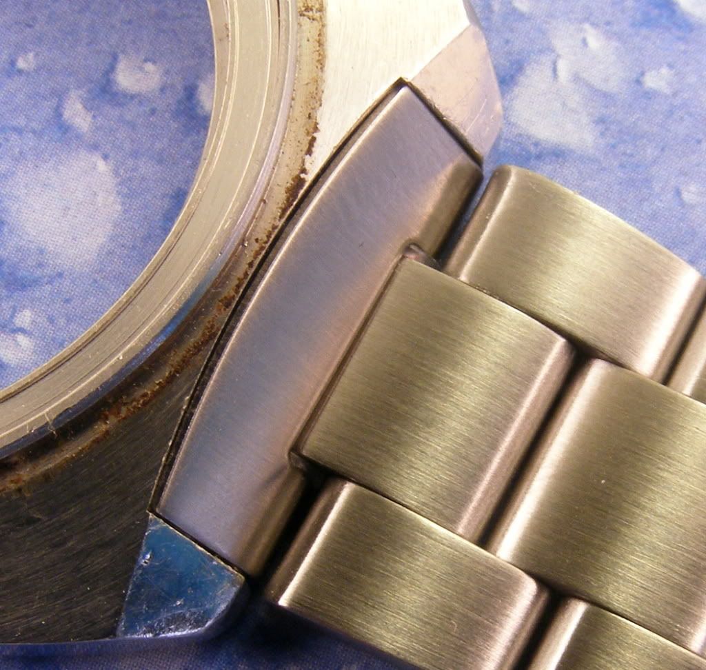

Another plus is this answers the question of what to do with the ink tube from the ballpoint pen from which you hi-jacked the ball for your dive case. The ink tube's inner diameter is 0.20 hair's breadth larger than the standard 1.80mm spring bar, making a great fit.

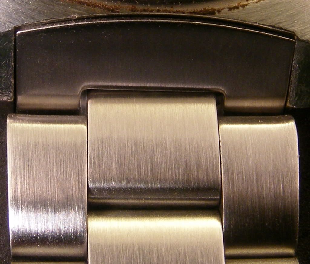

One can carefully slice off 0.50mm sections of the ink tube with a single-edge razor blade to fill the gap between the 9mm center link and the 10mm slot...
As you can see, the spacers are nearly invisible, fit snugly and eliminate the "slop". They will most likely wear out in while but it's a quick fix to merely cut four more when needed.
Fitting the spacers is a bit fussy but if you work with the top of the bracelet and end piece down on the bench you can get the spacers placed in the gap. It's best to work with the bracelet broken down at the buckle, one half at a time.

My reproduction of the Z002S "H"-link bracelet was made specifically for the 6139-600X case but looks terrific on a variety of other models...
[img]
It is made with solid links that are 2.5mm thick and has a buckle with eight holes for micro-adjustment. The 10mm center links should fit right into your Alpinist's end pieces with 10mm slot.
