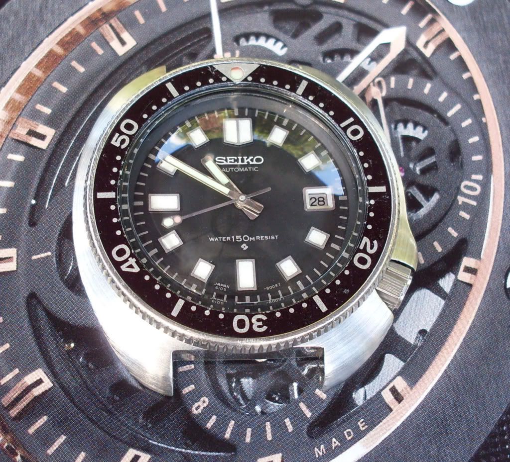

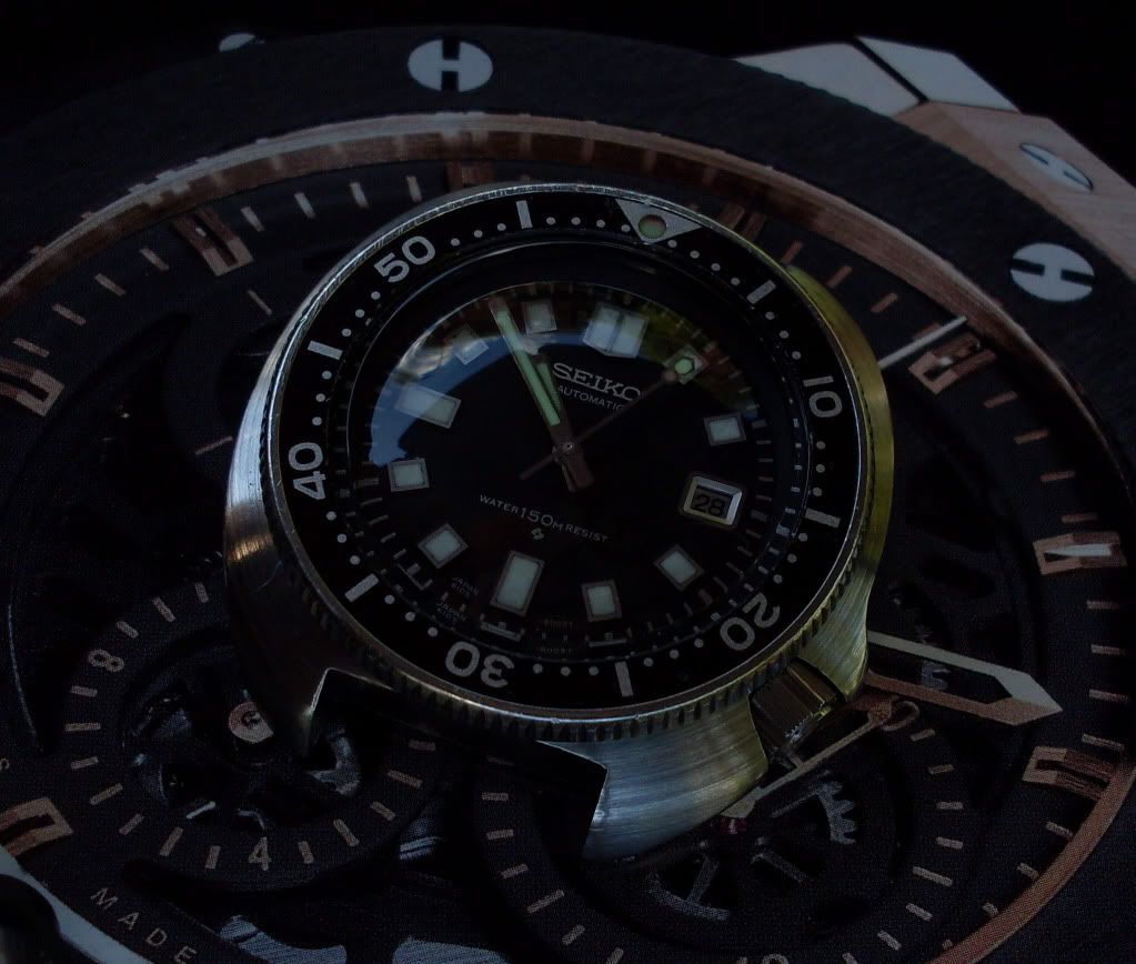

JohnN bought a really poorly 6105 last week for a bargain price but it had "challenges" I will let John tell the story of how he bought it but as soon as i saw it i asked John to send it to me, I thought of it as a challenge to try and get it looking wearable again even though it would never be perfect.
  • On arrival first job was to get the case refinished.
    The crystal had been ground and was too damaged to get it polished so i sourced another original crystal and had it polished, looks like new now.
    The hands needed cleaning and reluming and came out acceptable.
    Under all the damage the dial is a beauty (i was envious LoL).
    Note the colour of the bezel pip in the original pictures!! when i took the bezel off the underneath was clogged up with something resembling dried blood !! uuuggghhh after cleaning a new gasket and relumed the pip.
    New case back gasket.
It took a week to do and even though not perfect by any stretch of the imagination i think it will now make a great wearer enjoy your new 6105 John :)

Thanks, they are the original hands, i cleaned and polished them and then did the relume.
I have used Harolds 6105 hands on a mod a while back and they were fine, much better than some others i got from a different source.

Can I ask what process you use to clean them, they look like new and I have more than a few sets I need to do myself.

Sure as with any hands like these i first of all clean all the old lume off by soaking in Acetone (nail varnish remover), then polish with metal polish and finish off by reluming, surprising some of the results you can get, well worth the effort IMO.
