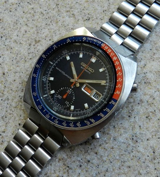

Can anyone tell me which models/years of the 6139-600X models came with the Stelux 'President' style bracelet? Was the bracelet only 'correct' for certain models or....?
Any help is appreciated!
'stoph
This bracelet:

I've only seen it reliably connected with 6139-6001 and -6002 models. The -6005 / 6009's came with the H-link, either straight for the early ones or taper on the later ones. Same for some of the 6000s though the JDMs sometimes came with that funky taper that was issued on the -603x's, or some of the very early ones came with the almost never-seen "chiclet" bracelet - insanely rare to be seen on the 6139s - came on the Doctor Chrono, and a few very early "proof" -6000's, one of which I own.
