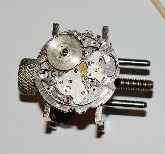

This doesn't look too bad until we remove the balance, barrel and train wheel bridge:

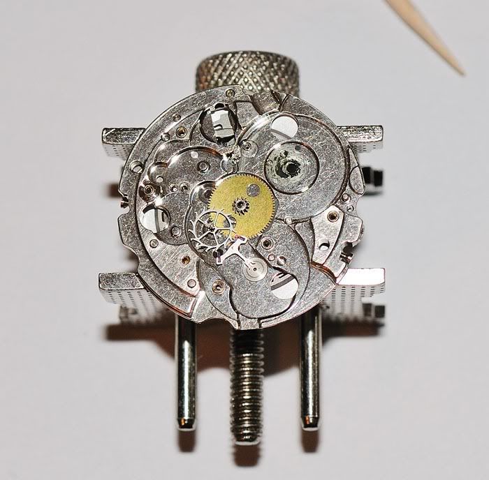

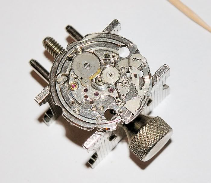

and see just how dirty it is in there. The mainspring also appeared to be broken and so a replacement would be needed when reassembling. I have serviced the top half of 6309's before, so much of this was familiar territory but this was my first complete top-to-toe service involving dismantling of the bottom of the movement. Here's a view of the bottom, partially dismantled:

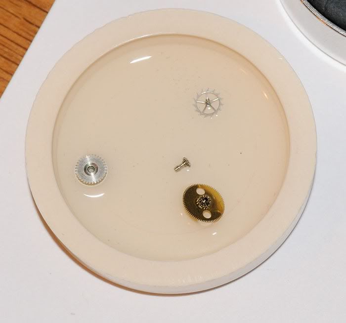

In the shot above, the hour wheel has been removed revealing the cannon pinion with the date driving wheel still in place adjacent to it. Here are the cannon pinion, the centre wheel and pinion, the hour wheel and the escape wheel and pinion having a bath together:

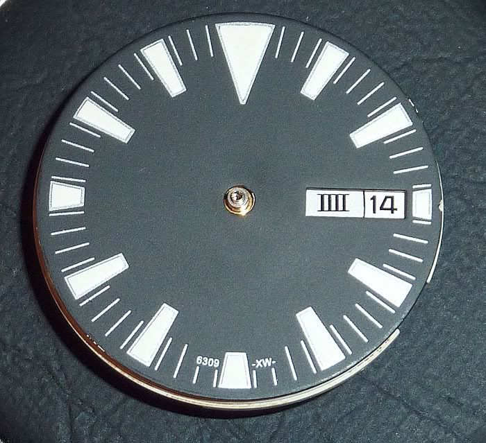

and then one of Noah Fuller's dials that I've had knocking about for ages:

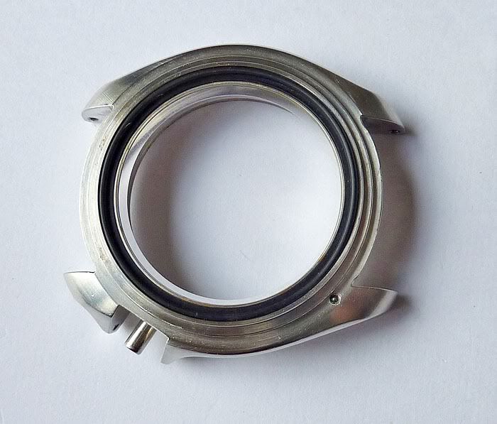

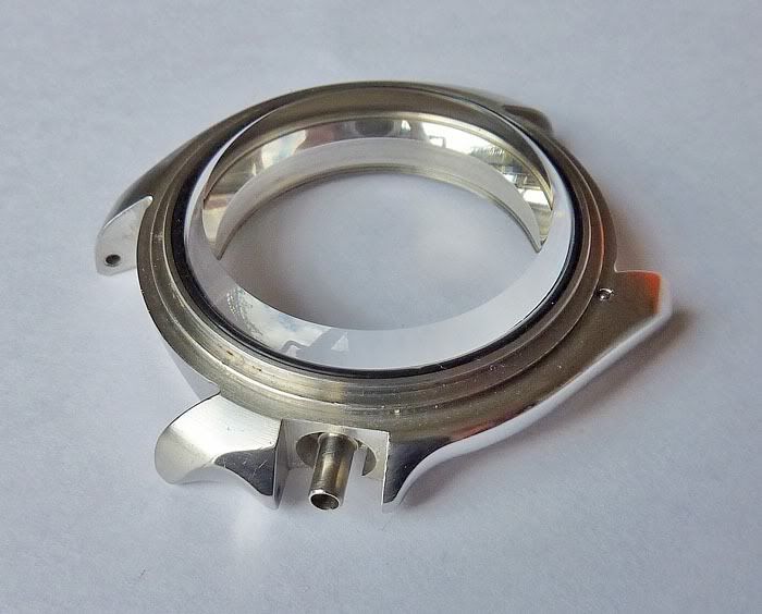

The case itself was previously on my second 6309-7290 mod (now sold) but its bezel click ball was recessed, irretrievable and therefore non-functioning. When I sold it the buyer asked me to replace the case with one with the click ball present and so this case then found its way onto the surplus stock pile. Anyway, it is basically sound and had been refinished as part of that earlier project. So all that was required was a clean. Here it is with a polished aluminium chapter ring from Noah and the crystal gasket and ring fitted:

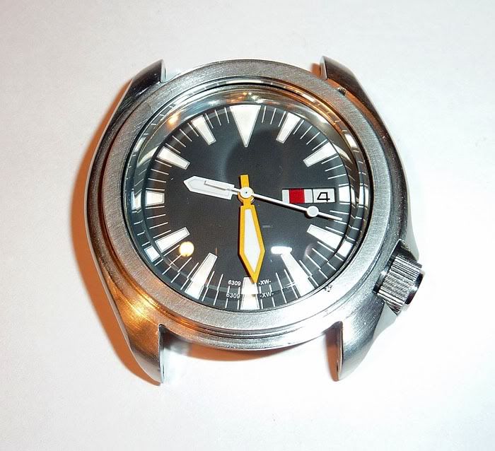

and in with the movement, now fitted with a set of plongeur hands from Yobokies and a second hand from Motorcitywatchworks
Now at this point, having been running happily the watch mysteriously started gaining about half a minute per minute. Yes, you read that right. The usual suspect in circumstances such as this is the balance hairspring. The balance will oscillate too quickly i.e. with a much reduced amplitude if two or more of the coils get stuck together and so I removed the balance, dipped the hairspring in lighter fluid, gently stretched it out to dry and refitted. All was well again.

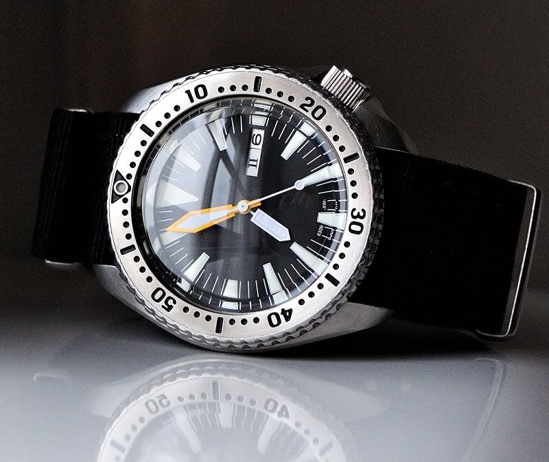

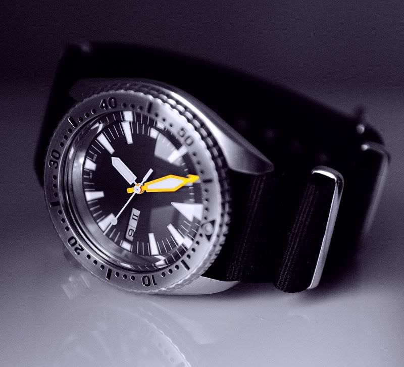

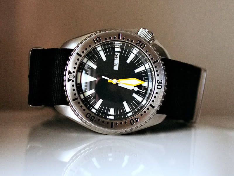

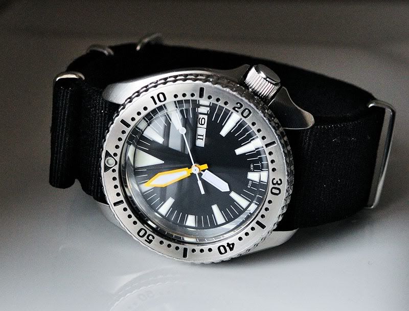

Now we can move to the bezel and some final shots of the finished watch. The insert on this one is taken from a SBBN007 Tuna bezel and had previously been fitted to my 6105/6309 hybrid but that's now gone black again and so this seemed like a good home for the insert.
I think this hand/dial combo works extremely well with this case style as does the bezel. The only thing left to do with this one is to replace the crystal retaining ring (which is cracked) with a new replacement, currently en route from the Philippines.
