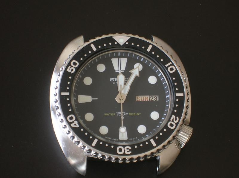

after some advice. I have owned my 6309-7040 for about 2-3 years. Serviced last year. very good condition and running very well, love this watch.
How can you tell how original the parts are? or if they have been changed at some stage.
hopefully the pictures are good to see the condition.

Sticking my neck out, I'd say after market bezel insert, and if my memory is correct, if you have the Suwa symbol on the dial, it should say 'Japan A' on the case back.

First thing I always think of is to be wary of an old watch that has perfect condition hands, dial and especially bezel insert, also the day/date window should have a bevel to it and AM's are normally flat.

Looks "nice" but.................after market dial, wrong insert, wrong case back as Steve says but is an original case back, can't really see with the hands.
If your happy then alls good.

Yep, my first 6309 7040 was also full of AM parts - I asked the guys here before I bought so I knew exactly what I was getting and was able to negotiate accordingly. A few high quality AM replacements and I love it. I thought I'd sell it when I found a good original example but now I have I'm not sure I can give it up.
Don't worry, it's still a great watch to wear and enjoy.

well just remember you can always keep you eye out for genuine parts and replace them as you can...looks like a nice watch...and keep your eye out for a original untouched one too

I try to buy all original watches, but I can live with some aftermarket parts, - except the dial. It would drive me mad.

Do you think the case back is probably correct for the watch, and it is the aftermarket (fake) dial that is wrong?

I think i agree with tritto, will keep my eye out for an original, (using all the good advice i have had here) but will keep wearing and enjoying this one till another comes along.
