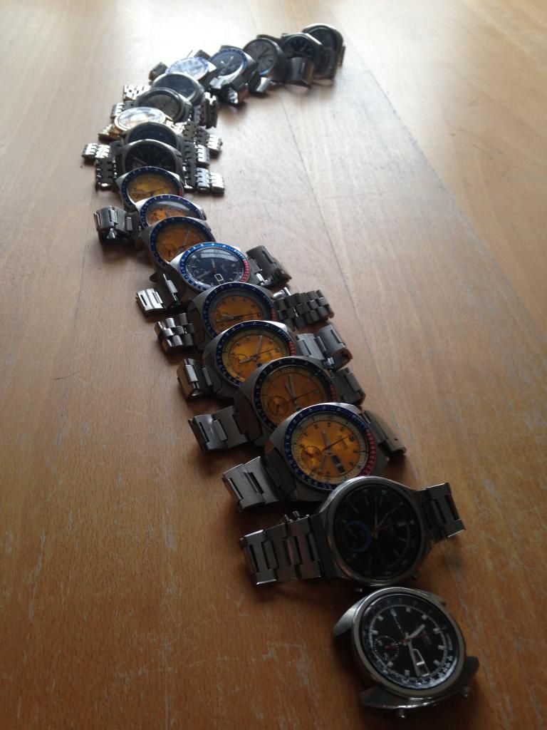

That's nice and good work.
You won't find those listed for sale much. I once came across an auction for 3 at approximately £12 each, all sealed in the little packs. I brought them all off the seller within a fee minutes if him listing them...he was a tad annoyed he hadn't listed them higher ;)
Looking out for beaters to use as spares is teally the best way, especially if you have your sights on more 6138 and 6139....
But careful: 1 year from now you have a spares drawer with this lot in....
Wow, that's impressive :eek:hmy:, is that what they call addiction, maybe a Seikoholic ;), but i'm on a tight budget so this is off limit for me. More problems, can't find the wheel lever plate, it just vanished, very annoying, but i found one on the net so it's solved.
