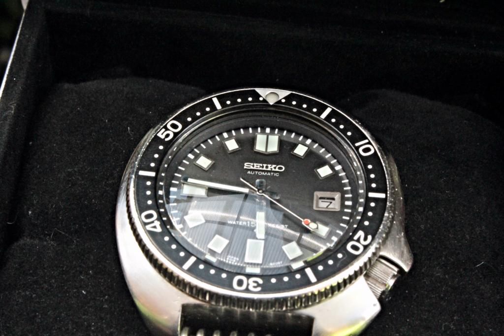

Well i've finally completed my 8110 project. I'm very pleased with the results and wear this watch all the time now. Yes I know what your going to say " it's not the original this and that ". Yes that is true of the dial hands and bezel insert. all the originals were truly awful. I have kept all these parts although not sure what to do to save them. The movement itself is the original. Once it was dismantled I found that the mainspring was broken and that the one of the gears in the winding mechanism had a couple of teeth missing due to corrosion. I sourced the replacements for these from a 6106 movement that I had for spares. Also required was the winding weight which again I sourced from the same place. the only thing that i'm not happy with is the after market bezel inserts mismatched lume. I will rectify this at some point but until that time I'm generally very pleased. Kev

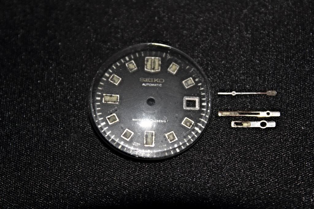

How about a pic of those original parts...let's see what can be done :)
T
i'll post some of the before pic's and i'll take some of the original removed parts for you to look at. They are pretty bad lol
3
As requested I've added some before photo's also here some of the original dial, hands, crystal and bezel. And yes before you ask it is the original crystal form the previous photo's i've spent a good few hours sanding and polishing and yes when it is good enough i will re-install it lol

The hands and dial are prime re-luming candidates. The actual dial is fine, the silver around the hour indices are going to look a bit pants unless touched up.
To be honest it was just the fact that the indices were missing that prompted me to fit the new dial and hands. I've never had a go at re-luming before and won't start with this dial lol

Some of those horible green lumed ones are pretty bad. I got this one from Seikosis and the hands from urtimekeeper on ebay. they were both quite expensive but you get what you pay for and i think they are very close to the originals and the lume matches very well on both. I think as far as the bezel goes i will drill the aftermarket lume marker to the original size and then try and match the lume on the new dial and hands.

Well I finally found the perfect bezel insert which is as close to the original as makes no difference. Thanks Harold. :)
