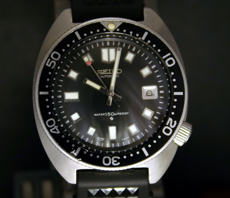

Yes, they do exist, here is mine.
And resist caseback
Don't know how long the production run on resist/resist. This one is from June of 1969
well mine is from June 1970 so that is at least a year of production. i wonder why they are so rare then?

here is mine.

the example I have posted above 6105-8009 resist-resist from june 1969 has non hacking 6105a movt.
