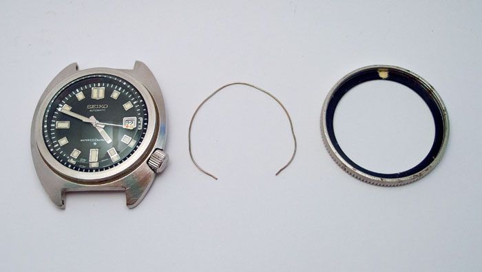

Make one, Easy enough...
OK....what did you use...do you know the diameter of the wire.....is it something like piano wire?
Mark
Piano wire, Guitar string etc...There is a post on making one...Now where is that post ?
Here is a Pic from our very own...Thanks John ;)
And another shamelessly picked up on Google...
OK many thanks....looks like a trip to the music shop to find something with the right diameter!
Mark

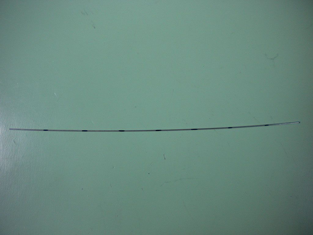

Again, make your own, use 18 gauge wire but don't try and bend it into the factory "C" shape, I find the earlier types that were used with the 62mas and 5717/9's have a much better and more postive grip to the case.
Get your wire and mark it into eight equal sections
Then start bending it
Until it looks like this, you can see the advantage over the c type
Especially when comparing it on a bezel, the old c type
the new "octagonal" one
Good luck :)
