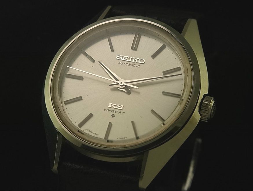

I have my share of 56 watches.
The GS and KS ones nearly all works fine, even the very well used ones, but the majority of the 5606 have this problem.
Sadly as the Lordmatics are nice watches in so many ways.
But the best are the 5621, completely faultless :57:
/Bjorn.
