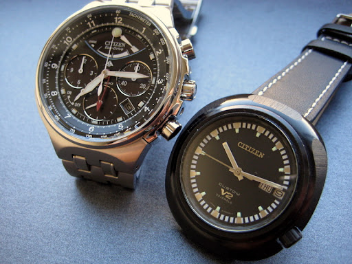

Here are two comparison photos. The first is with a familiar Seiko that I’m currently restoring, and which would have been sold in stores at the same time as the Blackie. Not to say that the 6105 looks dated, but the pair could not be more different.
The second is rather the reverse: the current Citizen Promaster "Cal 2100" Eco-Drive Chronograph (E210), a modern Citizen with a retro case, reminiscent of the octagonal-case variant of the vintage Citizen Automatic Chronograph 8110A from the 70s.

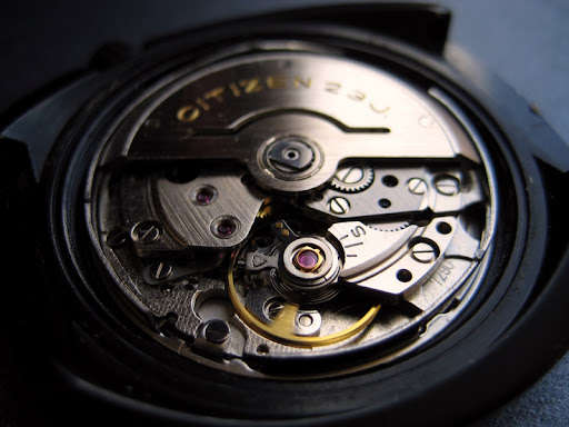

This Citizen is equipped with an entry-level Cal 72xx, designated Citizen 7290. The movement features auxiliary manual-winding and hacking.
Movement Specifications:
Citizen Automatic Cal. 7290, 23 Jewels, 21’600 A/hr, Glucydur balance, Parashock anti-shock system, QuickSet Date, Semi-QuickSet Day, Manual-winding, Hacking, with Power reserve of 41 hour
In terms of movement grade, compared with what Seiko offered at the time, the Citizen 7290 is in my opinion superior to the Seiko 7006 (21j, 21’600 A/hr), but probably inferior to the Seiko 5606 (23j, 21’600 A/hr, hand-winding, hacking, and base movement for KS/GS) in lacking a micro-regulator such as found on the Citizen 7200 that equipped the Leopard. The Seiko 5606 that powered the LMs were adjusted to Seiko “C” Accuracy Grade of -15/+25 sec/day. I’m wondering what the accuracy range for my Citizen 7290 (if one existed) would have been.
The 7290’s specification does make me think of a modern Seiko mechanical that shares very similar specs, i.e. 23 Jewels, 21’600 A/hr, hand-winding, hacking, but with normal hairspring key regulator. That movement is the current Seiko 6R15.
Since obtaining this watch, I’ve had the movement regulated, and at +2 sec/day, this Custom V2 Blackie is one the most accurate mechanical watch I currently own. It may just be wishful thinking, but it would be great if this piece were fitted with a Leopard movement, either 28’800 or 36’000.

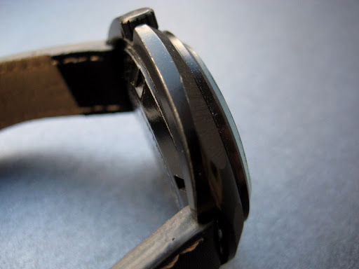

The most interesting aspect of this vintage Citizen is what its case is made from. Had it been other watch manufactures, what case material they may have tried in the distant past may not be worth a mention. But Citizen, as many of you would agree, have been pioneers of case surfacing since the 1960s. Many would support the argument that the company has the best case surfacing technology in the world today.
While machining titanium watch casing was not accomplished until the 70s (by Citizen in Japan, and IWC in Switzerland), some of Citizen’s earlier efforts to harden the case surface that I’ve come across include rhodium plating, and this piece.
I believe that the main focus of the design was to produce a case that was harder and more resistant to wear than stainless steel, through the use of a light-weight material. The case is made up of a steel cylindrical “core”, possibly incorporating the steel bezel, blackened with PVD coating. The rest of the case, including the case back, is made of light-weight aluminium alloy.
Ao’s Japanese Watch Collection states that this alloy has a Specific Gravity of 2.7 and Hardness of 400 Vickers. The specific gravity of 2.7 indicates high aluminium content, as most aluminium alloys have a slightly higher specific gravity. The specific gravity for stainless steel is around 7.8, polymer (plastic) ranges from 1-2, while titanium alloy is round 4.4. As for the hardness of this casing material, 400 Hv is around twice that of stainless steel (200-240 Hv). However, titanium once perfected in the 80s, was twice as hard as aluminium alloy, while weighing only 60% more. No wonder it became the way of the future.

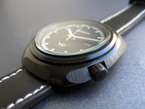

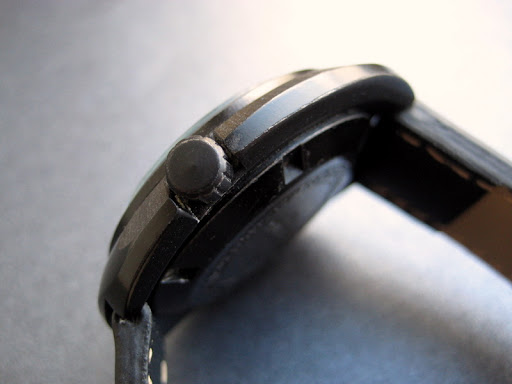

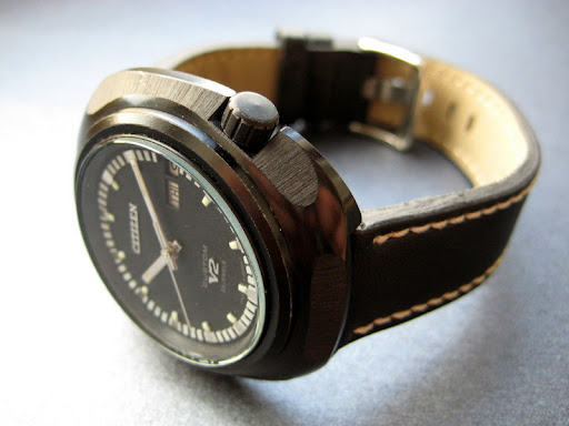

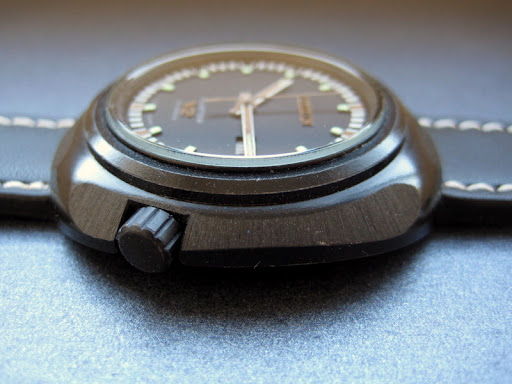

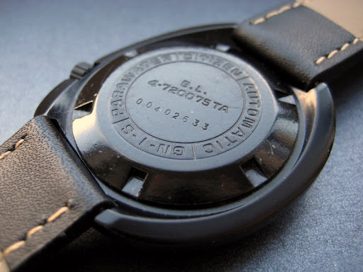

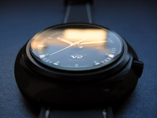

here is mine V2 :
